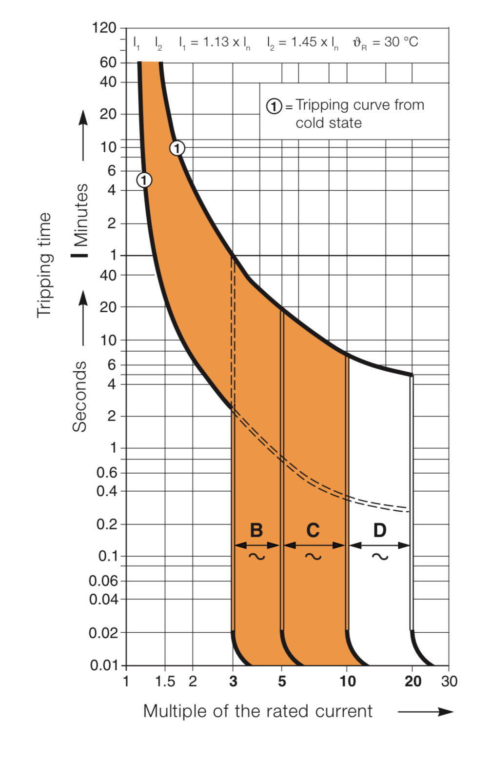

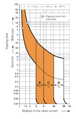

If your interested in the technicals, see below for the multiple(s) of current drawn vs the time taken to trip.
A big overload from a fault condition obviously cuts off the power quickly, but an extra few amps will not, and this is (well, should be) taken into consideration in the design of the wiring in your house.
As above, a modest overload for a short time is not a problem.
The thermal curve of the MCB is designed to mirror the damage profile of typical cables, i.e. if the MCB's stated rating is correctly selected for the cable's continuous capacity then it will protect the cable for all of the combinations of overload.
