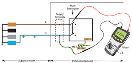

Hello can someone please explain in the most simplest way possible what r1 r2 Ze and Zs mean please. All I get on Google is a book full I just need to know what they are and what do they mean. And also earth loop? Thanks

Ze is the earth fault loop path that is external to the installation.
Zs is the total earth fault loop path from the supply transformer right the way to furthest point of a the final circuit in the installation and back to the transformer. Zs = Ze + (R1+R2). In theory this will not be the case most of the time due to parallel earth paths through equipotential bonding etc.

Z e is external (i.e outside the installation)
Z s is system (i.e. the whole of the transformer, supply cable, service head, consumer unit, final circuit.)

could yourself or someone give an example of Ze please? So i can picture it in my head better, thanks
Ze is the Earth Fault Loop Impedance external to the installation, so is done on your line supply and your earthing conductor (which has been disconnected from the MET)
