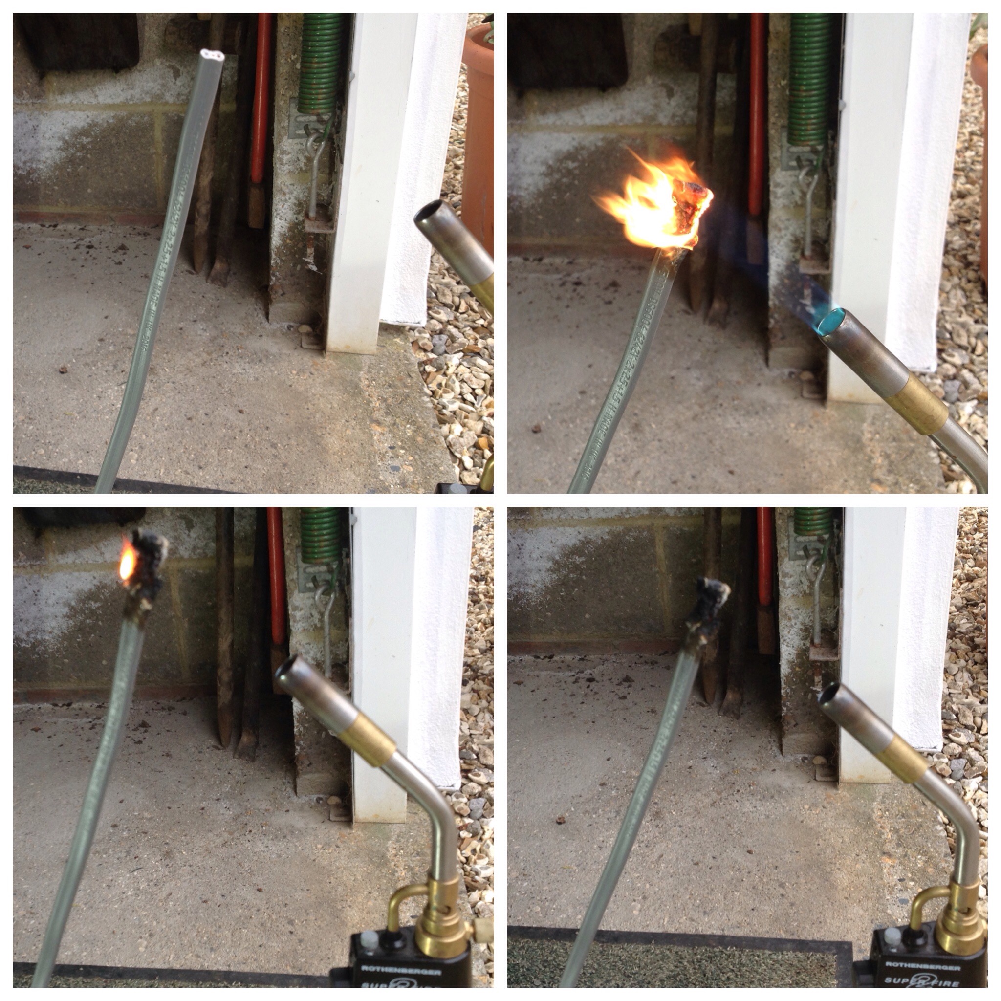

See attached.
Nothing to do with cable fixing but flame propagating systems on an escape route, not at home to check Regs though.
That regulation mentions absolutely nothing about flame propagating systems just supports.
Pvc containment is not prohibited as long as cables have metallic supports to prevent premature collapse.
Regulation 422.2.1 which can mean LSoH cables
