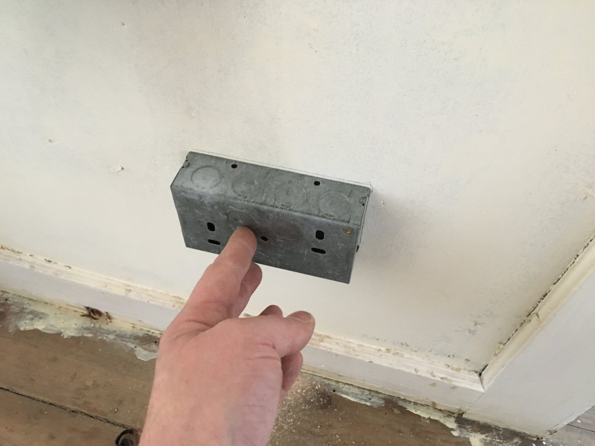

Mark where you want the socket to go. Height wise, measure an existing one from either the floor or the top of the skirting.

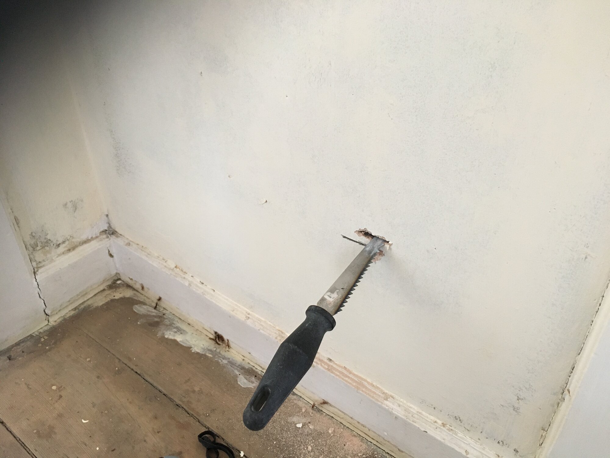

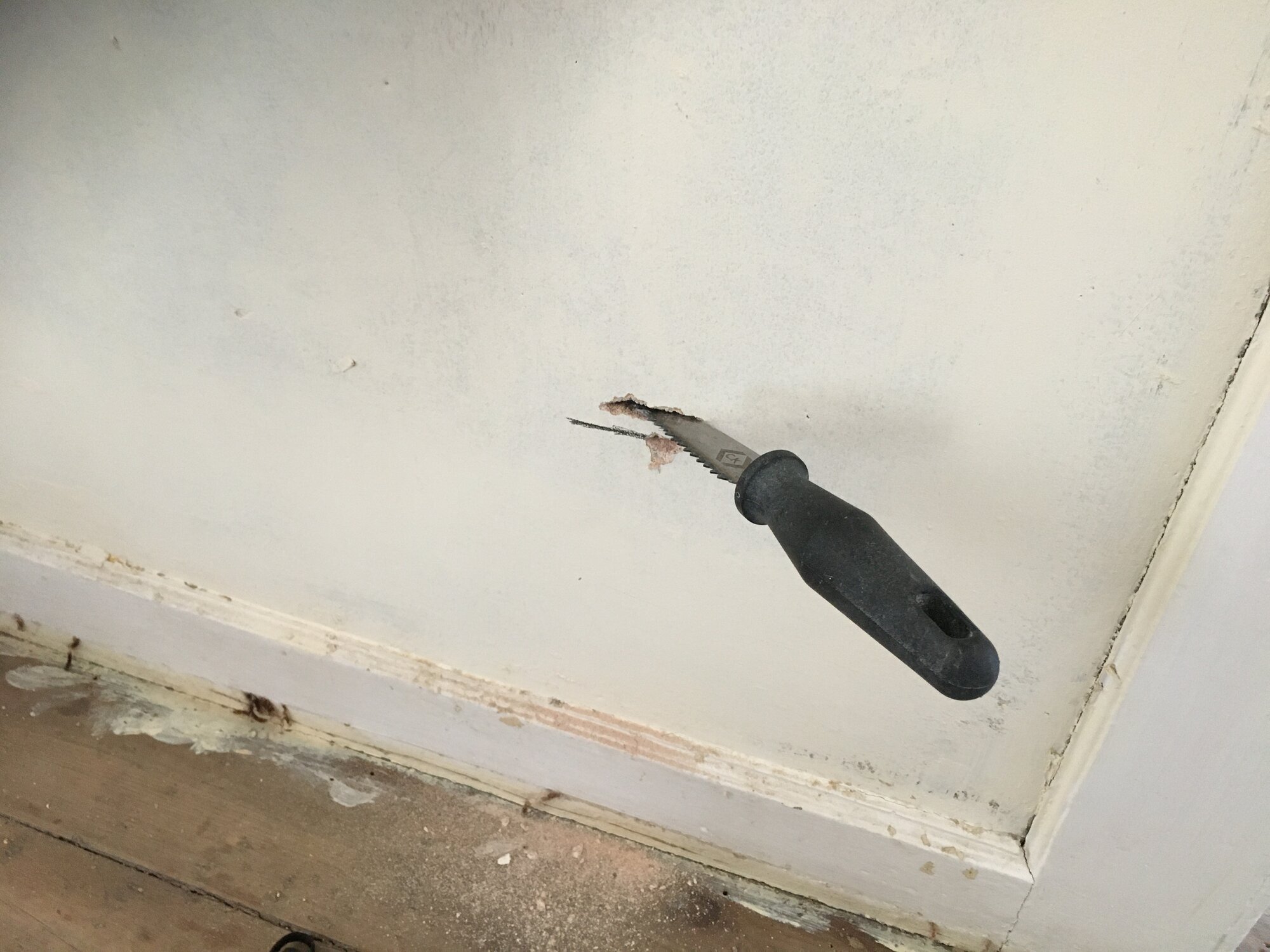

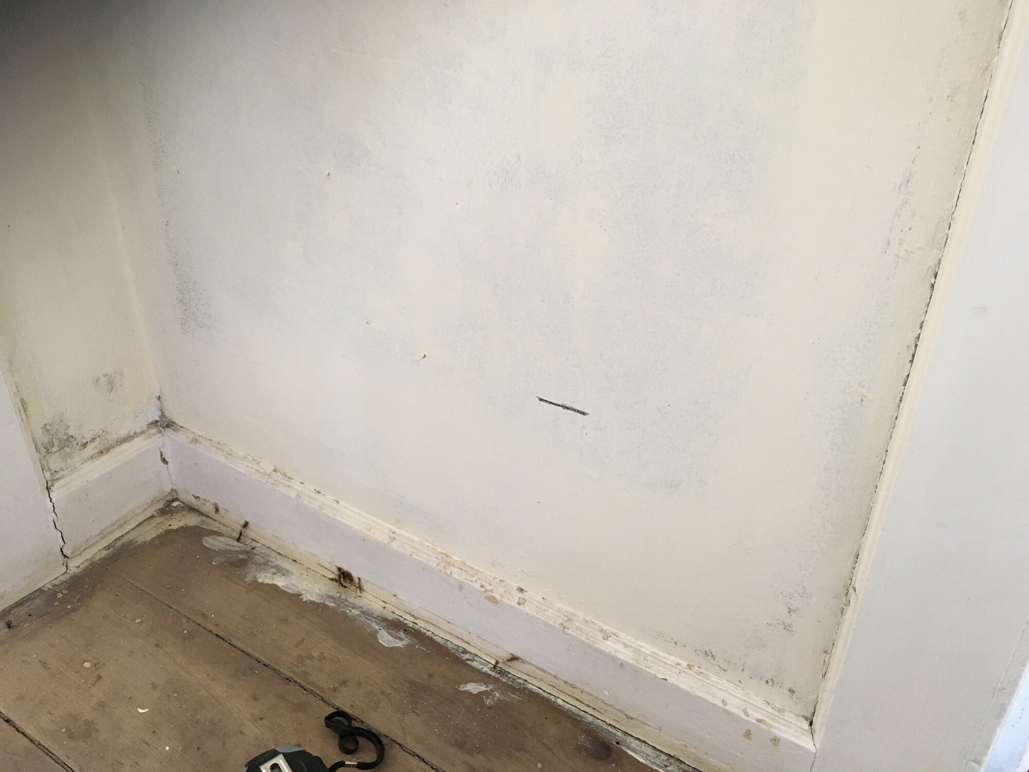

Next, use a pad saw to find a gap between the lathes. Hit and miss jabbing with the saw until it breaks through.
I will be using a regular dry lining box, so you don’t want to be too close to a vertical joist. Use the pad saw to feel to the left and right. If you can feel a joist, just adjust your planned position.
Once you have the final position, you can draw around a regular metal back box to give your cutout size.

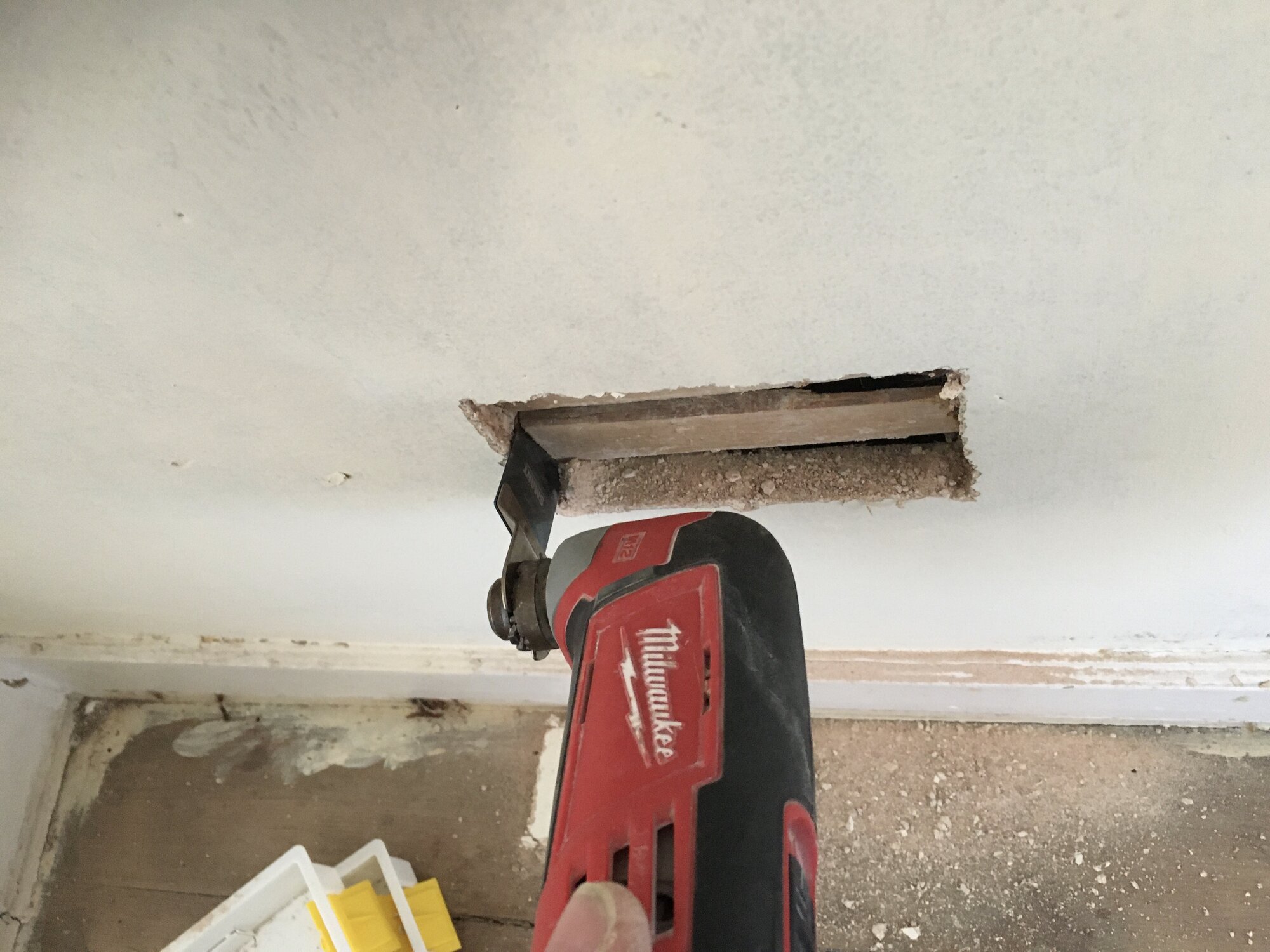

Using a multi tool on a fairly slow speed, you can chip away at the plaster, but not the lathe quite yet.
yet.

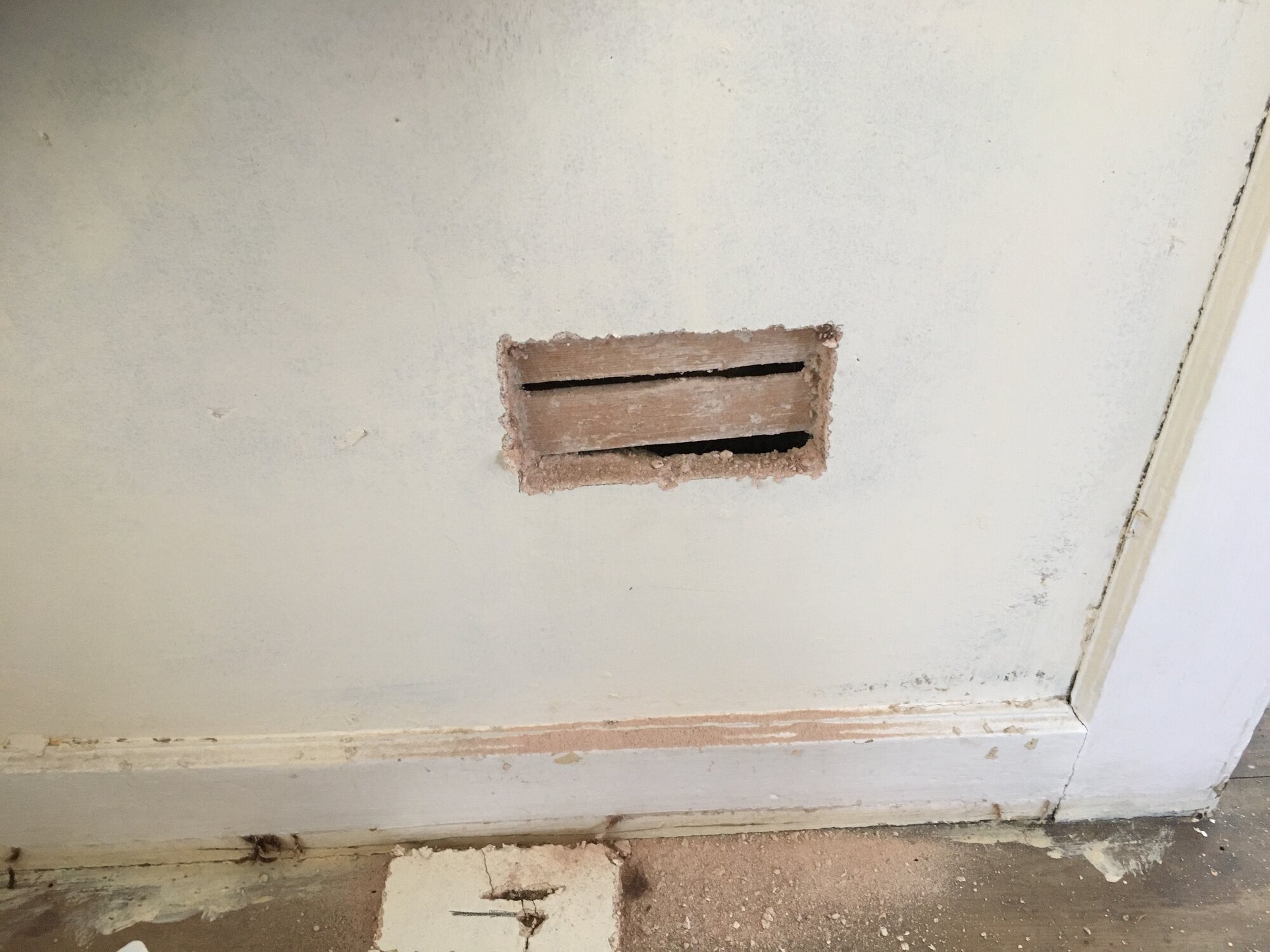

Now, with the multi tool on a high speed and a fine toothed wood blade, you can cut neatly through the lathe without much problem. A small wood screw screwed into the middle of the lathe and held tight in pliers will help as the lathe will want to push into the hollow wall.

Fitted many hundreds of sockets into lath and plaster walls over the years, have tried the methods detailed in this thread, but have found that any that leaves a cut end of laths unsupported will eventually cause problems.
The method I eventually settled on was to cut a rectangle of lath and plaster away, making the vertical cuts in the centre of the adjacent studs, down to the skirting board (especially pre part M) and horizontally just above the top of the proposed socket, and also removing the plaster from the next lath up.
At this stage, you could get a drill inside the wall, and drill a nice central hole down to the space below the floorboards to bring the cables through, then fit a good solid noggin between the studs to screw a metal socket box to. Finally comes two layers of plasterboard, either 9.5mm, 12.5mm, or one of each, depending on the surrounding plaster thickness, with the outer one overlapping the lath left at the top, to reinforce the join when it's skimmed over.
Exactly this. The plaster to the sides of the cut out is not supported, so very weak. It can be reinforced though, using timber battens, without too much trouble:
  • Cut the hole out of the lath and plaster for the backbox with multitool (we're gonna use a steel BB).
  • Cut a couple of timber battens, something about 2" X 1" should do. They're going to go inside the wall, vertically, to either side of the hole, and need to be long enough to extend beyond a couple of un-cut laths, both top and bottom. About 150 - 200mm long is about right.
  • Reach inside the hole, and carefully pull away the plaster 'keys' from either side of the hole where the battens are to go. We want the battens to press right up against the back of the laths without being fouled by any bits of plaster.
  • Now the fiddly bit.
  • Liberally coat the face of one batten with PVA, water based gripfill, or similar. Maneuver the batten through the hole and into position vertically to the side of the hole, glue side pressed up against the back of the laths. Hold in place, and drive a screw through the plaster, through an un-cut lath, and into the top of the batten. Repeat for the bottom of the batten. You can put screws through the cut laths into the batten too if you like.
  • That side is now reinforced, and will be about as strong as you can hope for in a lath and plaster wall. Do the same for the other side of the hole with the other batten. You can now fix the backbox in place by screwing through the sides into the battens.
  • Filler over the screw holes and you're done.
