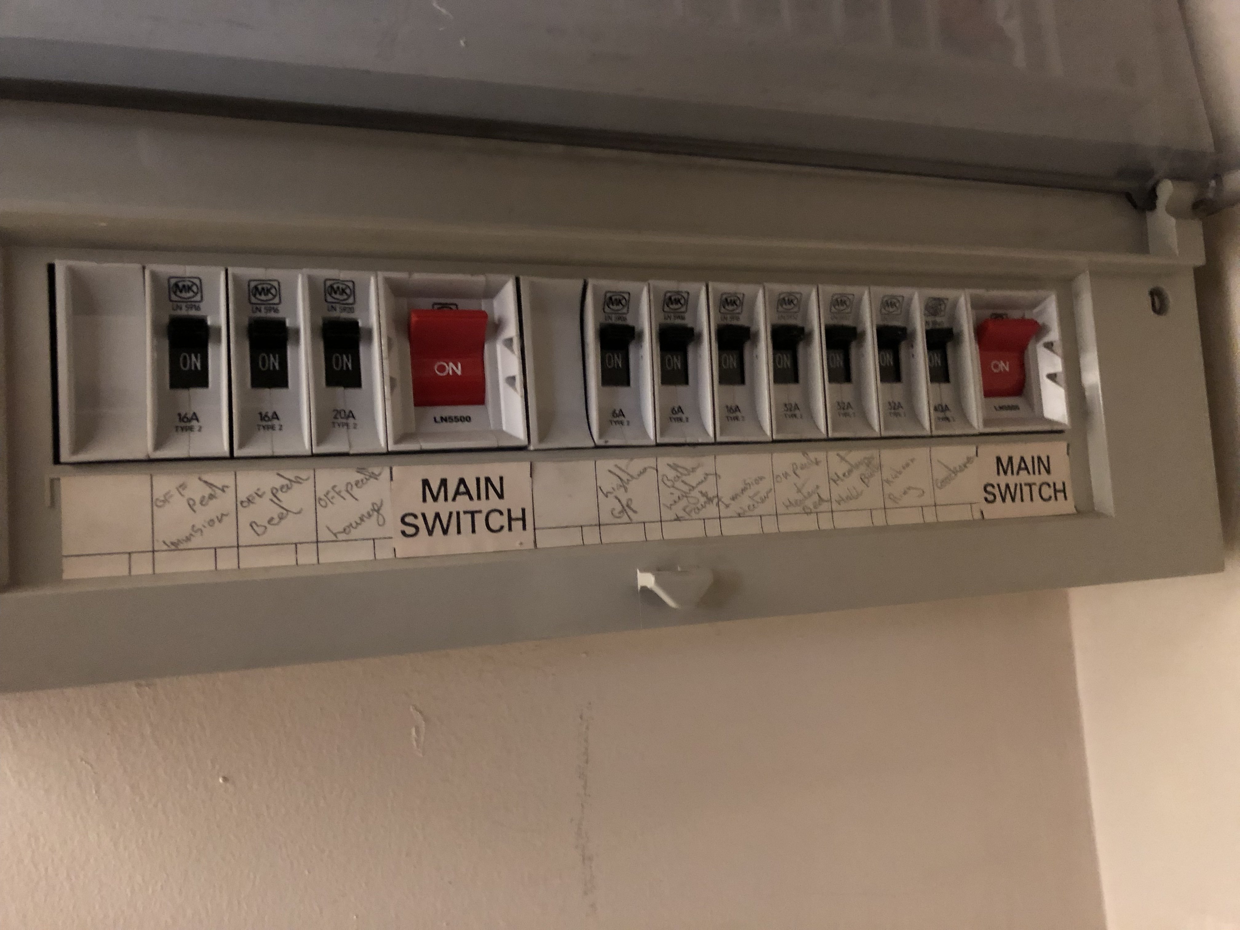

Without changing the fuse board what would be the best way to get a 50a supply to a shower.
I was hoping If I could not get an RCBO just an MCB to supply an RCD unit.
Wishful thinking

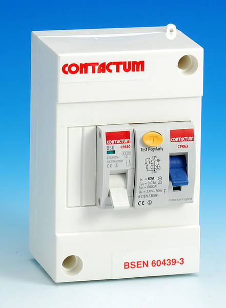

Keep the existing fuseboard and add a separate 'mini' CU that has an RCD and an MCB in it (aka shower unit)
Or is that not what you are looking for?
They did produce single pole rcbos for those and modern ones will not fit and I am not sure they went up to 50A, probably 45A.
