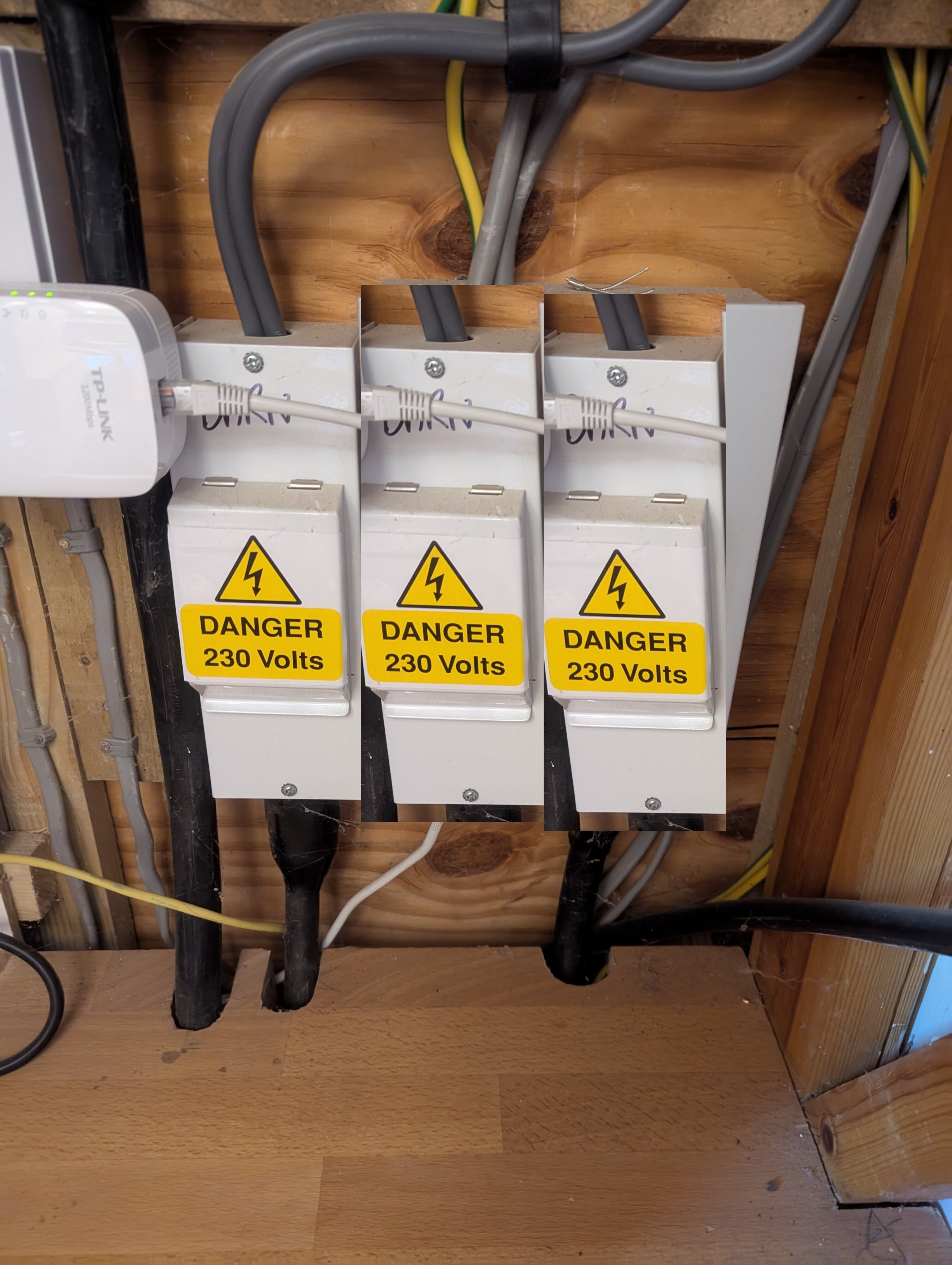

I need to add in another supply to a new workshop but im running out of space next to my dis board. I currently have two extra supplies (via tails to henley's) going to an outside barn and the utility part of my house. Looking at how these two supplies have been fitted (previous owner) the 'barn' supply is obviously the easiest option to copy due to size of the JB (80a RCD). But is this correct? The larger wylex box on the right also has a mechanical breaker on top of a cartridge fuse. I was always taught double isolation so to me the larger box is the right way despite taking up excess room. Or am i wrong and can i get away with the smaller box? ie remove the wylex unit and have 3 of the smaller RCD boxes? As ever TIA.

Thats what i suspected! Ive been looking around at different enclosures and it is possible to get slightly smaller ones but not by much! How about 3 of these, i suspect they might be a royal pain to wire up with 16mm tails but could it be a possible solution? (Earthing is TN-C-S according to the last EICR)
Those KMF switch fuses arent really used for terminating SWA but you could put a metal adaptable box below each one and gland the SWA into those passing through into the KMf switch.
The only way I can think of getting three submains from that limited space is to replace what is there is a 60A triple-pole switch-fuse assuming that would fit. Only slight downside is that it does not switch the neutral which would be required for a domestic installation unless this is only required for consumer units, would have to have a look.
