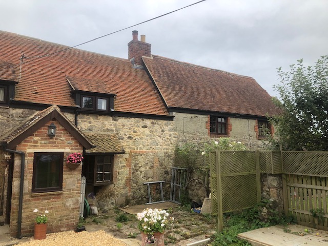

The main job I asked the spark to do was fit a modern consumer unit in my outbuilding / garage. Rightly - he has gone back to the main board and advised the current armoured is only capable of 40 amps under current regs. However it did pass an insulation test. We plan to upgrade to 16mm for 60 amp capable so can later do an EV charge point . I've bought the ducting.
But - as my main house meter is old - he suggested asking for a smart meter - and at same time get an isolation switch fitted. Makes his works easier. Good idea and I arranged this with my Energy provider. It was fitted on Wednesday.
Not happy - he fitted an ordinary modern Economy 7 meter - not a smart one as promised.
Gobsmacked - he said FYI despite the main fuse saying 100 amps there is only a 60 amp fitted. He scratched up the 100amp label. He said refer to your power distributor.
So - question - has anyone come across a main fuse that says one thing and is fitted with another (less) ?
Where do I stand - it's never been touched since original installation.
Now I think I'm buggered. Can't run all that with 60 amp main fuse ?

It's very common. The fuse carrier itself is rated at 100A maximum. The fuse within can be anything up to this value.
I'm surprised your electrician didn't know this.

I also now know I can’t complain to SSE but ask for a survey to see what the feasibility is to upgrade the supply (and cost)
I fear it will be tricky as my supply is run through the middle of next door !
I'm not an expert in EV chargers, but I'm given to understand that if you have a looped supply, and a 60 amp supply, then unfortunately both of these are hurdles that will need overcoming.
I've heard of instances where DNO (SSE) will unloop without charging. Others know more about this area of electrickery than me.

We are very rural, in one of a pair of cottages fed from overhead. The overhead runs about 400 yards to a more substantial set of overheads. I remember 35 years ago the linesman who installed our supply saying there is a 400 amp switch box there for isolating our overhead.
I think this might be expensive - or I just abandon it all and forget the EV charging 'future proofing'. Keep to petrol !!

Our test certificates asks us to fill in a box what size the main fuse is…. But we are not allowed to pull it to find out
we have to go by the sticker on the fuse carrier… which in experience … is either “100A” or “60/80” which still doesn’t help… which is it? 60 or 80?
The carrier is moulded with 100A printed into the plastic, as others have said, that’s the rating of the carrier- the biggest fuse that can go in.
