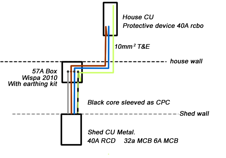

I have a 10mm2 T&E from my house cu to a box on the wall. I had this done a few years ago when we had our extension, I was going use this to power the brick built shed at the time. The flat roof was leaking so I didn’t have it done.
Id use the 10mmSWA as suggested, black CPC grey sleeved and into the earth terminal at the metal CU
Going to have 4 socket Radial final and 3 lights one outside he shed.
Please can anyone look at my diagram and say if there’s any obvious probs with it.
[FONT=&amp]I have enough swa to go from the shed CU to the house CU but the wife won’t tolerate the inconvenience
[/FONT]
As the distribution circuit is on an RCBO you can ditch the RCD in the shed CU and just have a main switch instead. Other wise you end up with two RCDs in series.
Thanks Leesparky,
I was thinking of using an MCB in a spare way not protected by an RCD in my House CU.
Would that be compliant / advisable ?
Added: Seems the MCB would be more convenient not having to go the the house if it trips, Im thnking of testing too, when I do my tests with RCDs in series it will cause me probs.
If the T&E does not require RCD protection due to being buried in the wall then yes it would be better at the shed end.
If the T&E needs RCD protection then it'll have to go at the supply end.
The reason I say it would be better at the shed end is that if it trips whilst someone is using the power in the shed then it can be reset from their without having to go in to the house
