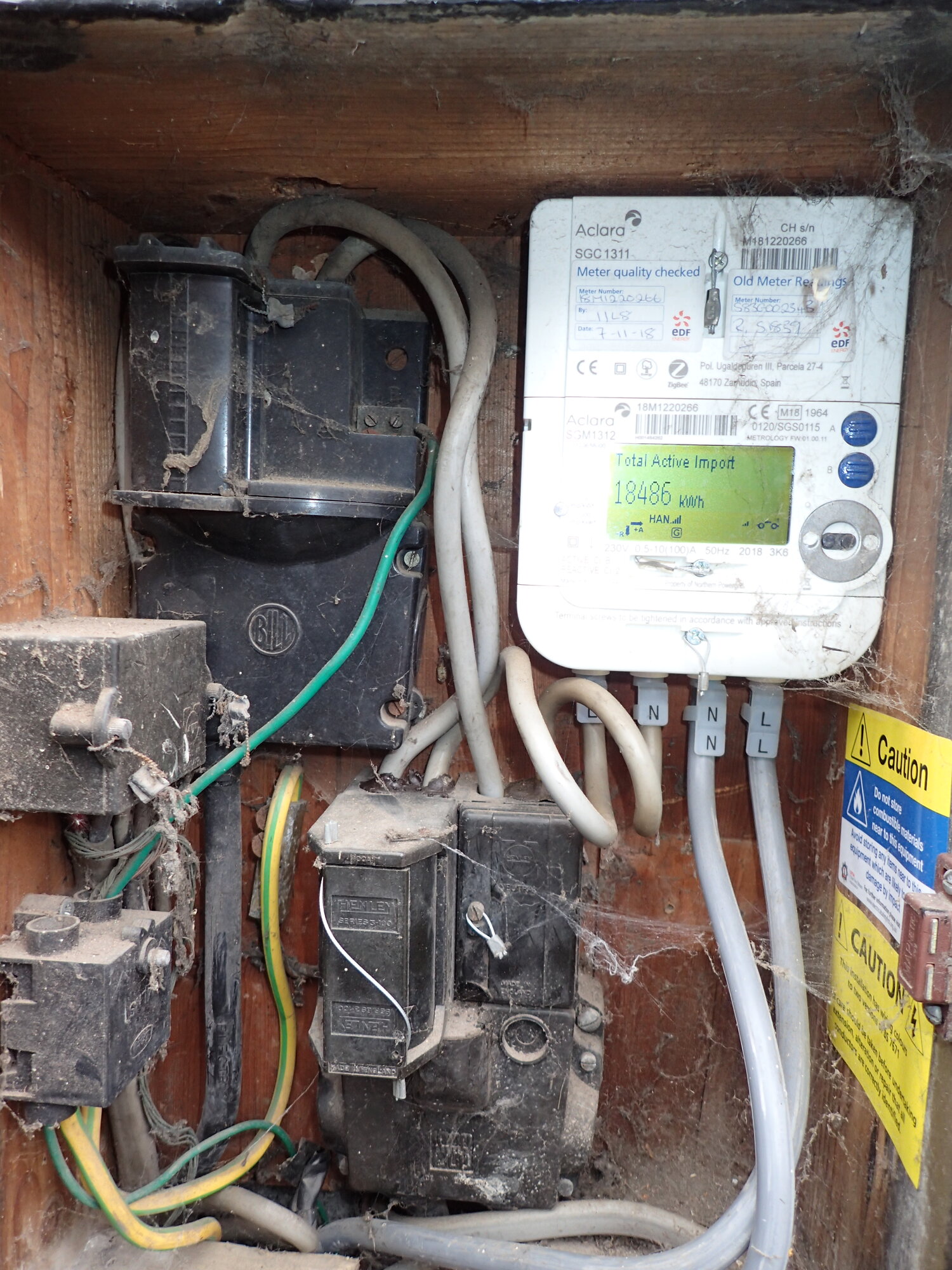

Came across this recently, haven't seen it before. External meter cupboard serving a ground floor maisonette. Early 1960s I'd say (there was no CPC on the lighting circuit, which was wired in PVC pirelli sheathed singles).
I'm guessing that at some point in the distant past the supply was due to be replaced, and the new and old supplies were joined for continuity of supply at switchover. Non contact volt stick suggests both fuses are still live, but obviously take that with a pinch of salt. Can anyone shed any light?

I don’t think I have ever seen a spur off 1 cut out (presuming the original cutout) to feed another cut out like that before
nice find
Very interesting. If both are live it gets a bit interesting regarding fault protection.
It couldn’t be that one of them is a lower fuse and outgoing to somewhere else, surely?!
I’m still trying to work out earthing and what’s going with the henleys on the left.
A good photo, hours of pondering material!
Could top one just have links in, and this is a very wacky and strange way to do a looped supply?
Maybe something unmetered like a row of lamp posts or bus shelter?
Agree that one surely must be outgoing. There's no reason on a domestic supply to do anything special to avoid interruption during a changeover.

If both carriers contain a fuse then they will both be live because they are connected together. You can discover the configuration by clamping the cable and changing the load on the local meter. If the current in the link cable changes by the same amount, the top one is the supply,. If it doesn't change, the bottom one is the supply, If it changes by a fraction of the load change in a repeatable way, both are energised supplies.
I would say that these were Local Authority built and the (reverse fed) cut out on the left is an unmetered but assessed supply to external lighting, posts or on walls on walkways.
Looks like the single green, lower left goes down to the sheath on the lower incoming supply cable.
Additional info which may or may not be usefull.
A friend recently bought a ground floor maisonette.
Outside there is a larger external meter box with 2 cutouts and 2 meters, 1 up 1 down.
The supply from meter to upstairs originally went though into the lower Maisonette then up a service void to above.
This has been cut off and an SWA runs up the outside.
The gas was the same, upstairs ran into the lower then up.
This now has a pipe up the outside.
This is one of 8 and has external lighting fed via a meter in another external box, all 8 split the bill between them.
These were privately built in the 70's.

Thanks for the replies. I hadn't entertained the idea that i was looking at 'one in, one out', but of course that would make sense. I have to go back there briefly on Thursday, so will have a closer look, and try to work out the configuration as per @Lucien Nunes 's instructions.
