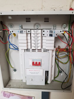

Hello everyone,
I am an artist and have a picture framing machine that is 3phase, bought it years ago and not sure if it is working and just want to test it. At my unit I have a 3phase consumer unit but no 3 phase power socket only 230v sockets. Because times are hard and I want to save money or die trying which most of you will agree will happen if I attempt this my self. I have attached a diagram of how I think it might be done just wanted the professionals opinion.
Thanks
can't quite see the next to bottom picture. but...... first there is a convention as to which colour conductor is used for L1,L2,and L3, and this should be followed. second, there are 2 ways of connecting 3 phase equipment, star or delta. get this wrong and it's bye bye equipment. get phase sequence wrong and motors run in reverse.
i strongly advise you to enlist the services of an electrician experienced in 3 phase installs ( not a boil-in- the -bag domestic installer.). the new circuit must be supported by a EIC (electrical installation certificate) which shows that 1. the new work is safe and compliant, and 2. that your existing installation is safe in itself to perform additional works.

Dave79 what size is that motor and since you are trying to save money just hard wire it but it’s so important that you have ample protection and a disconnect. If your not sure and you sound like your not why don’t you have an electrician help you wire it up

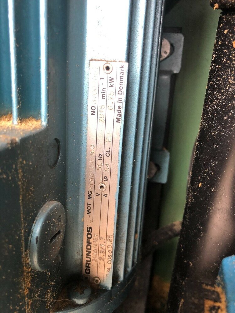

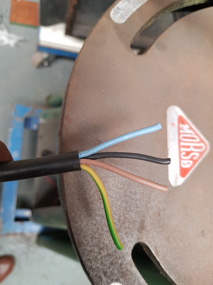

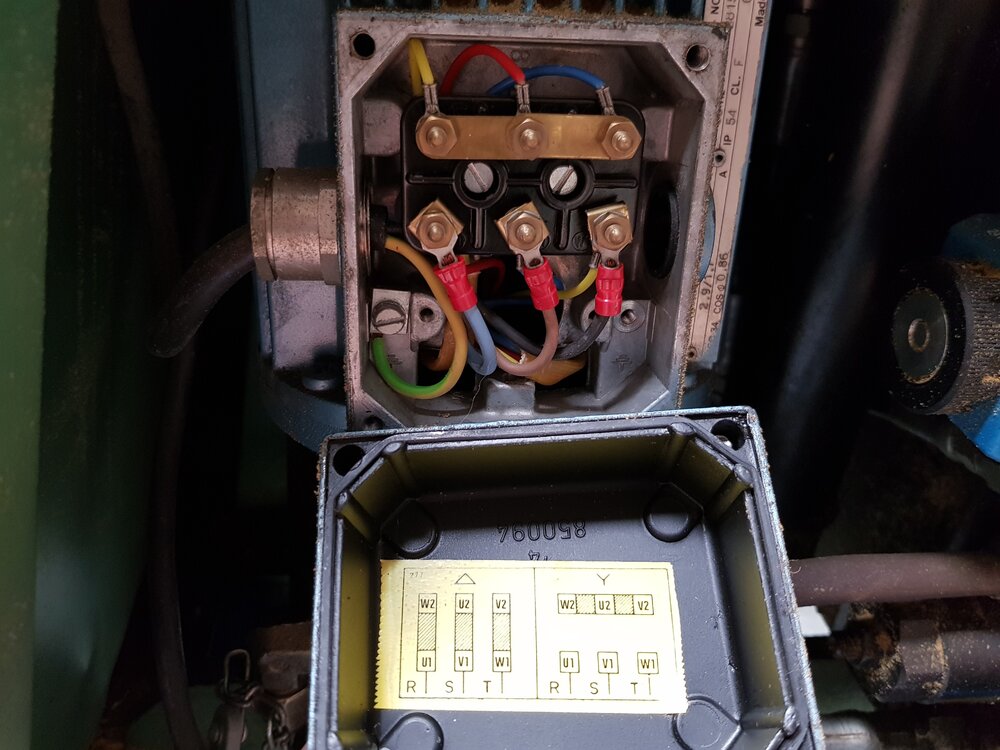

Thankyou for the reply, I have attached picture of the motor and the plug wire on the machine , the motor is 0.75hp the wiring on it is as original and I have not changed it in any way, This is made in Denmark so I am not sure the wire colours are the same as in the uk and it is a few years old. It is right to assume U1 is L1, V1 is L2, and W1 is L3? if so then L1 is blue, L2 is Brown and L3 is Black so on the plug side I would attach in same order.

conventionally L1 is brown, L2 is black, L3 is grey. however, this may need to be altered if the motor runs in reverse. also a pic of the rating plate, showing voltage and configurations would help.
If you fit a socket it is required to have RCD protection unless it is more than 32A.
Motor looks like it is wired star, as said above you should employ a proper electrician
Here is the pic of the rating plate

The machine is probably fine and will probably run fine when connected correctly. However if it is connected incorrectly and runs backwards you may take a perfectly good machine and break it.
You may even connect it correctly for the colours and labelling but find that the incoming supply to the board is reversed or that the wiring inside the motor is reversed (which it would appear to be from the colours of the internal wiring you can just see behind the flex connections)

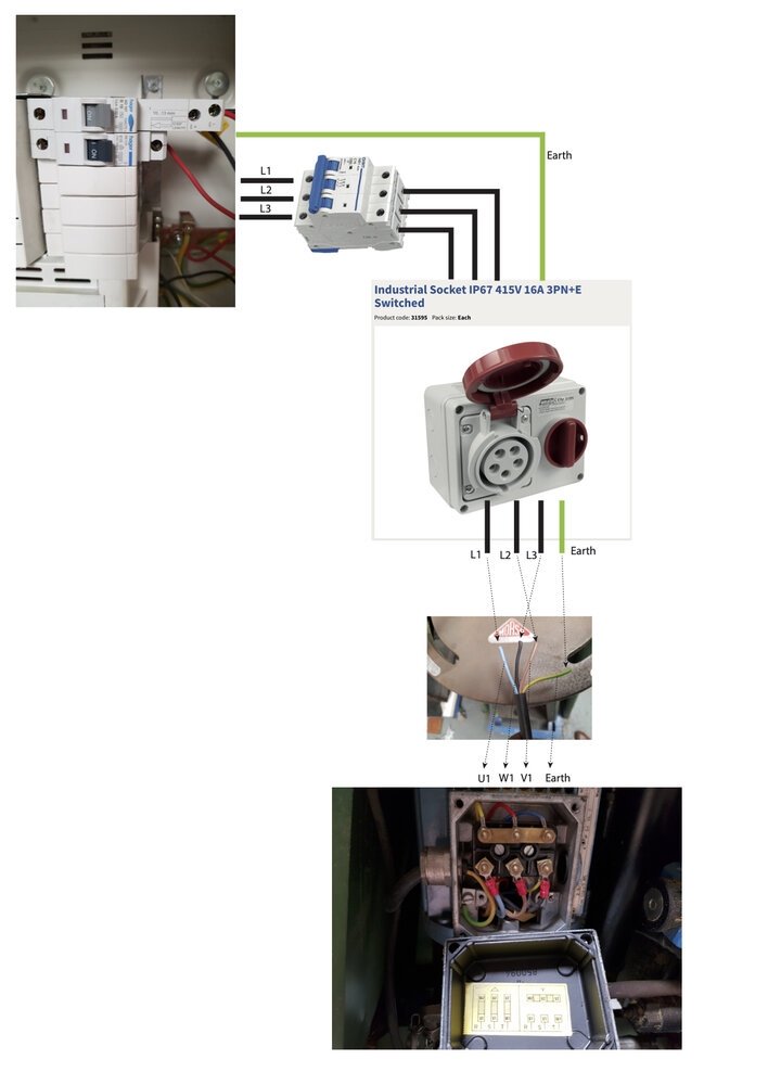

Thankyou guys for all your replies, I was expecting a lot more harsh comments but you have been very helpful, this is a great forum. Although I did joke about it you are right this is no joke and I think I might have to get some quotes form a proper 3phase electrician, Just thought if there was any quick way to just check if it is working then I would get a proper installation but if it is not working then straight to the scrapyard. I will get a quote if it is too much then I will just leave it in the corner again. just a quick question from the uk Sparks here, Roughly what sort of cost would I be looking at (materials included) to get a very simple straight forward 3phase socket roughly 3 meters away from the consumer unit? Just to be prepared of what it might cost me, attached is the pic of the consumer unit.

Your sketch shows a 3P+N+E (5-pin) socket wired with only the three lines and earth connected. This would be a serious mistake because even if the present machine does not require a neutral, if other equipment were connected that did, it could be damaged by the lack of one. Either a neutral connection to the 5-pin socket, or a 4-pin (3P+E) socket is necessary.
