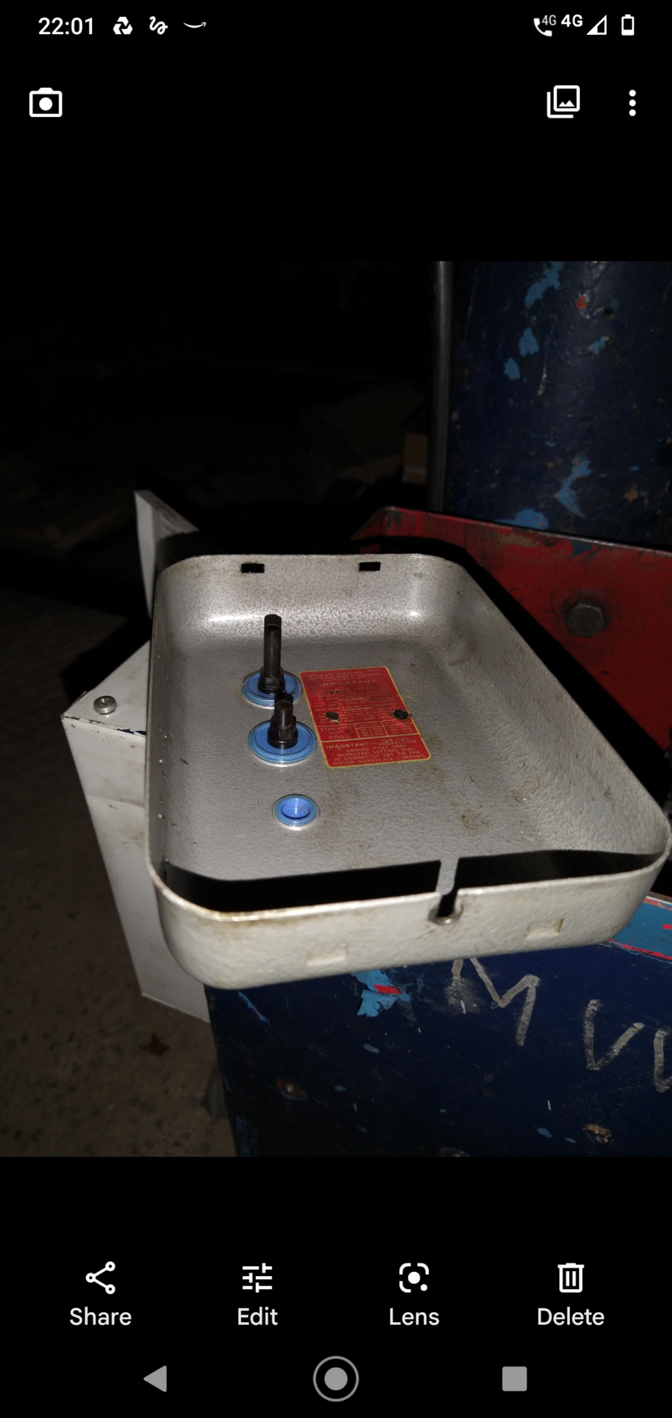

Hi all

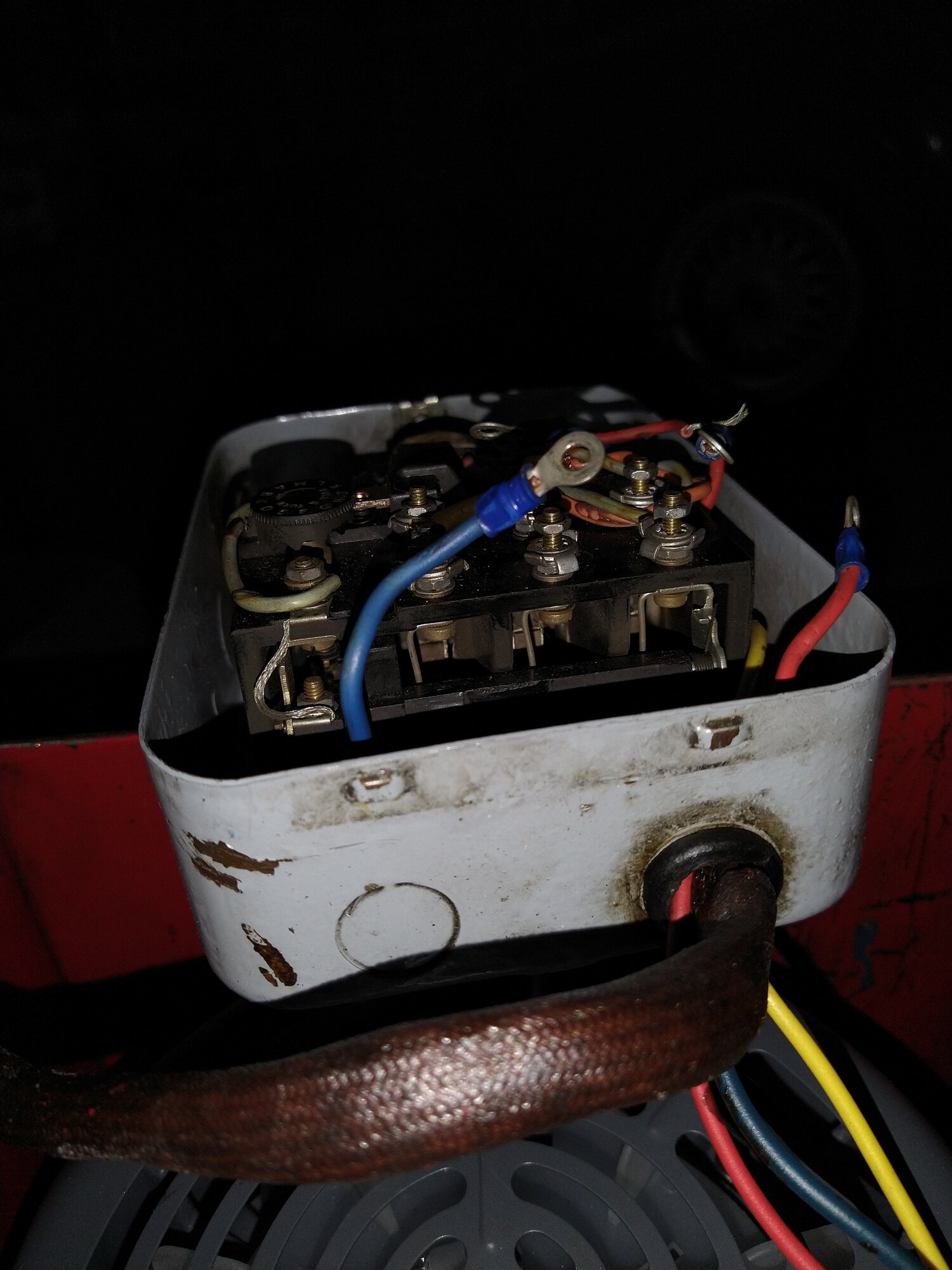

From the outset I'm not in an electrician. I am posting here because I'm thinking the subject matter is quite specific and will prob require some historic knowledge/ experience - I'm hoping someone will allow me to benefit from their knowledge.
I am converting a Bradbury 4 post lift (a variation of a liftmaster 735, which I think is a mk1/2) from 3 to single phase - single direction motor.
The issue I have is with the Dol starter. I want to replace the 415v original with a 230v dol starter with overload. The original dols is housed within the oil reservoir and the (dols') on/off buttons are 'pushed' via a mechanical rod & linkage setup connected to the up/down lever on the main post.
I'm thinking I need to either retain the original dol metal enclosure, replacing it's innards OR replace the entire box.
Simplest would appear to be to retain the original enclosure - thus retaining the mechanical on/off linkage - problem would be the successful marriage of the enclosure on/off buttons with the new internals.
Anyone thoughts/ experience/ solutions of/ for this scenario more than gratefully received.
photos attached (hopefully)-

I have a few thoughts, based on a series of assumptions that might quickly collapse like a house of cards! But to get the ball rolling....
I'm first assuming that in original 3 phase mode the Down operation basically opens the hold-on contact to ensure the motor is stopped, and also simultaneously operates the hydraulic recirculation valve mechanically.
So first principles are that you trying to energise the pump for UP, and for DOWN you are trying to mechanically recirculate the hydraulics while ensuring the pump isn't running.
I can't really see from the photo's exactly how it works, but my further assumption is that the UP operation originally manually closed the contactor while energising the coil to hold the contactor there?
If so my thinking would be to leave the original starter in place, using it as a simple two wire "make" switch that closes contacts when the control handle is moved to "UP" and in all other states the contacts would be open.
These could be used to energise a new contactor for the new 230v pump.
You would then be holding the lever in the UP position to ascend, let go and the pump would stop.
Down would be purely mechanical using the existing setup.

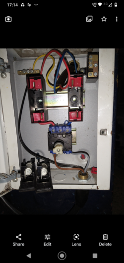

You are way ahead of my basic understanding of the existing set up. I think your assumptions are correct. However the existing circuitry is not working.
I purchased the lift 10 years ago - erected it, parked a car on it and then life got in the way. A few weeks ago I cleared the debris, bought a single phase motor & wired it up using existing dols and fused rotary isolation switch (mounted externally to the oil reservoir)
On investigation I found the internals of the rotary isolator to be stripped - it could not have functioned - so replaced.
I have wired the now working isolator to the single phase motor via the existing dols. I have no output (from the dols') to the motor so assumed either fried (like the isolator) or not working due to lack of 230v coil.
I appreciate your time and certainly do not wish to waste it - would any additional photos be of help to you?

The starter coil appears to have four leads, which suggests it might be dual voltage. Check any attached labels e.g. inside lid for evidence to that effect. Also check whether the overload relay will adjust to the FLC of the single-phase motor. It probably won't but worth ruling that out before you start modding.
Failing that you can probably use the start and stop contacts in the original starter to control the new one. This will require testing the internal configuration to identify the correct terminals. Are you armed with a multimeter?
I'd split this into stages, first check the UP lever manually closes the contactor.
More assumptions.....
You should find that the top row of 3, A B and C are respectively joined to the bottom row of 3 when UP is activated. Check with a multimeter on the continuity setting. So A should show continuity to the one under it, B should show continuity to the one under it etc. You might need to extend wires out of it to test this. (Obviously this is all with power off!)
I suspect the top right hold-on terminal is permanently joined to one of the top 3 internally, most likely the terminal marked C.
Again, check this with a multimeter. As originally configured this would send 400v to the coil once the contactor closed.
Once these principles are confirmed it is possible to wire it for 230v, subject to the coil being dual voltage as Lucien suggested.

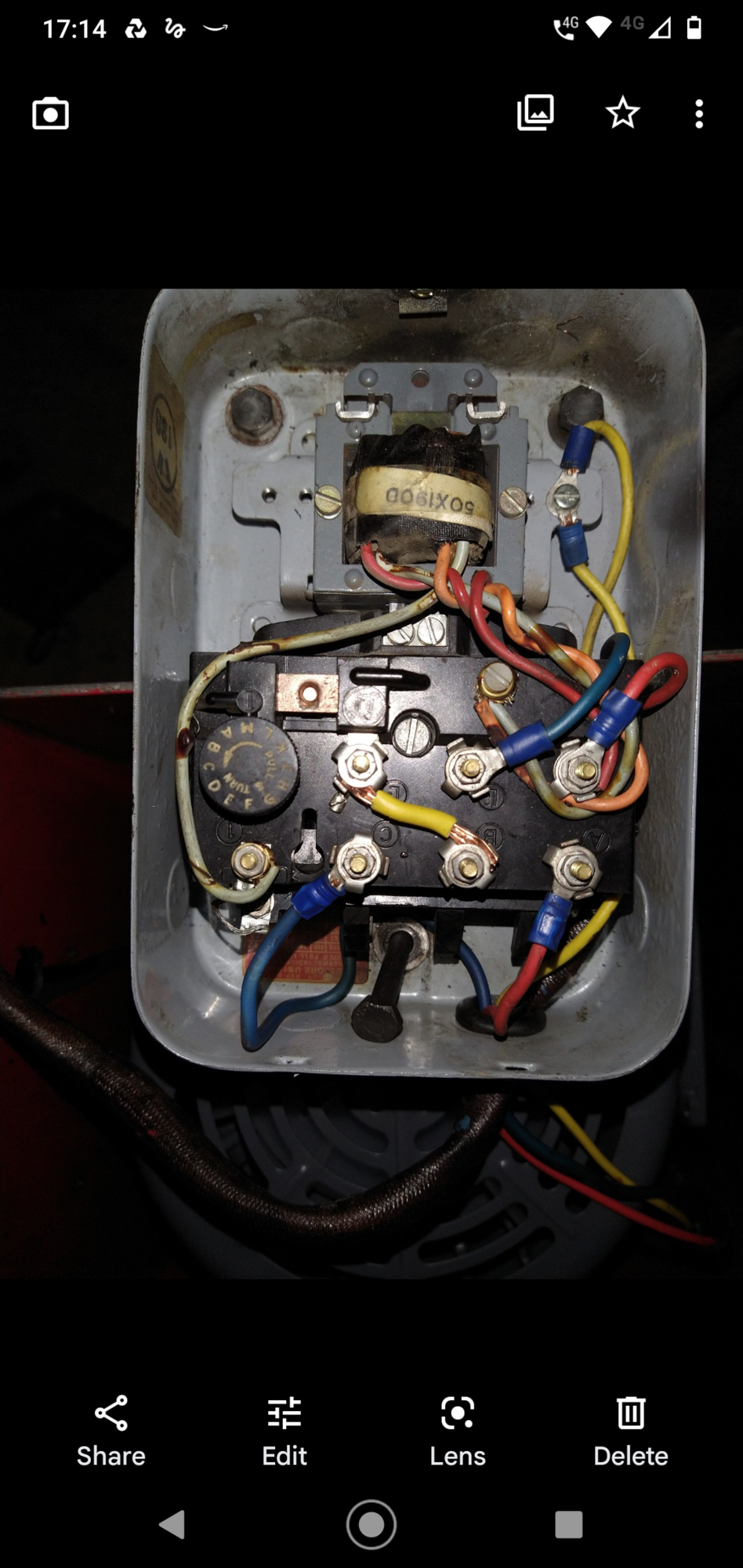

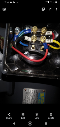

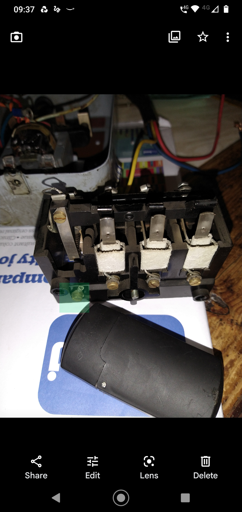

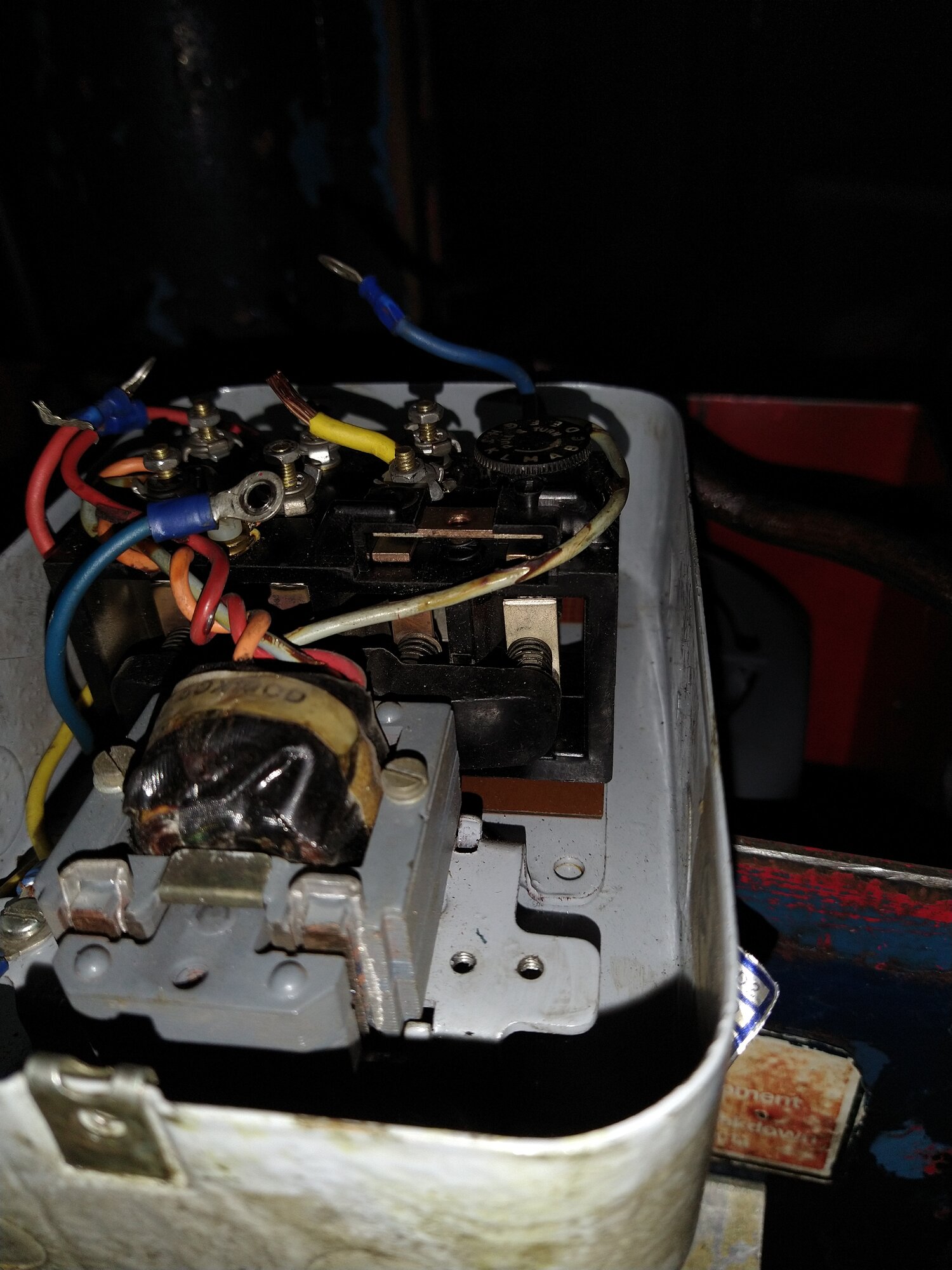

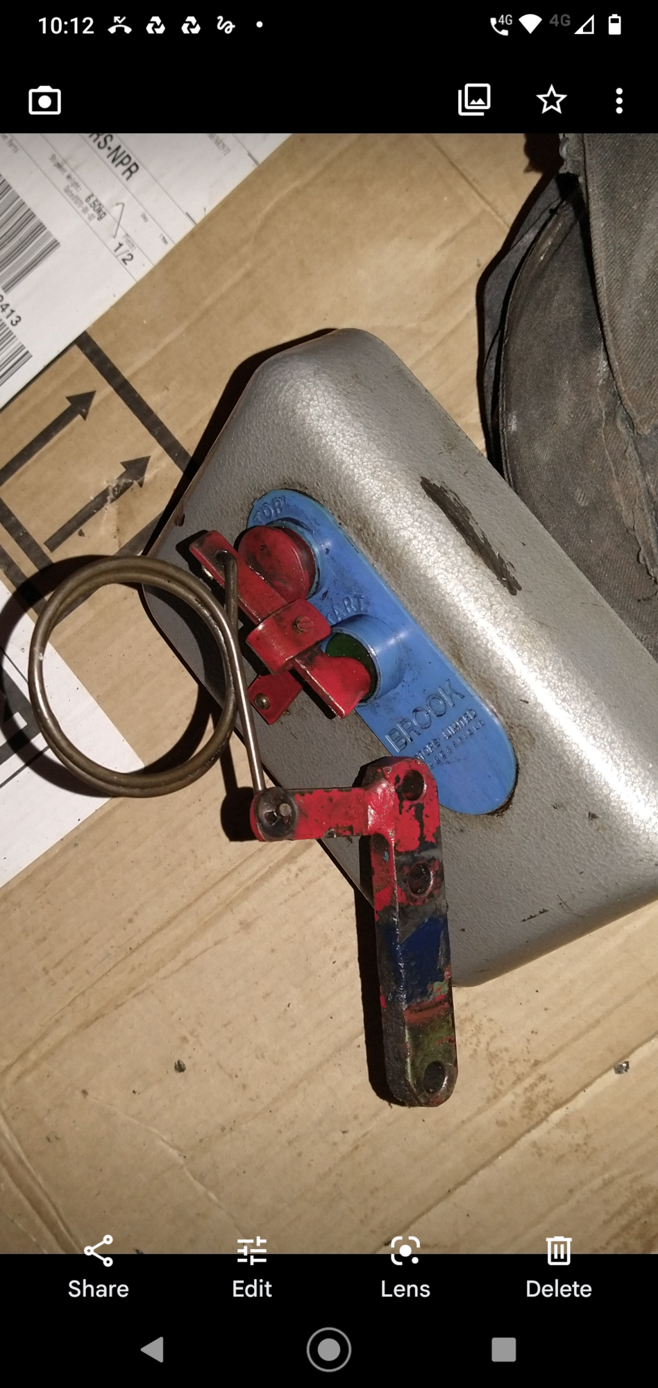

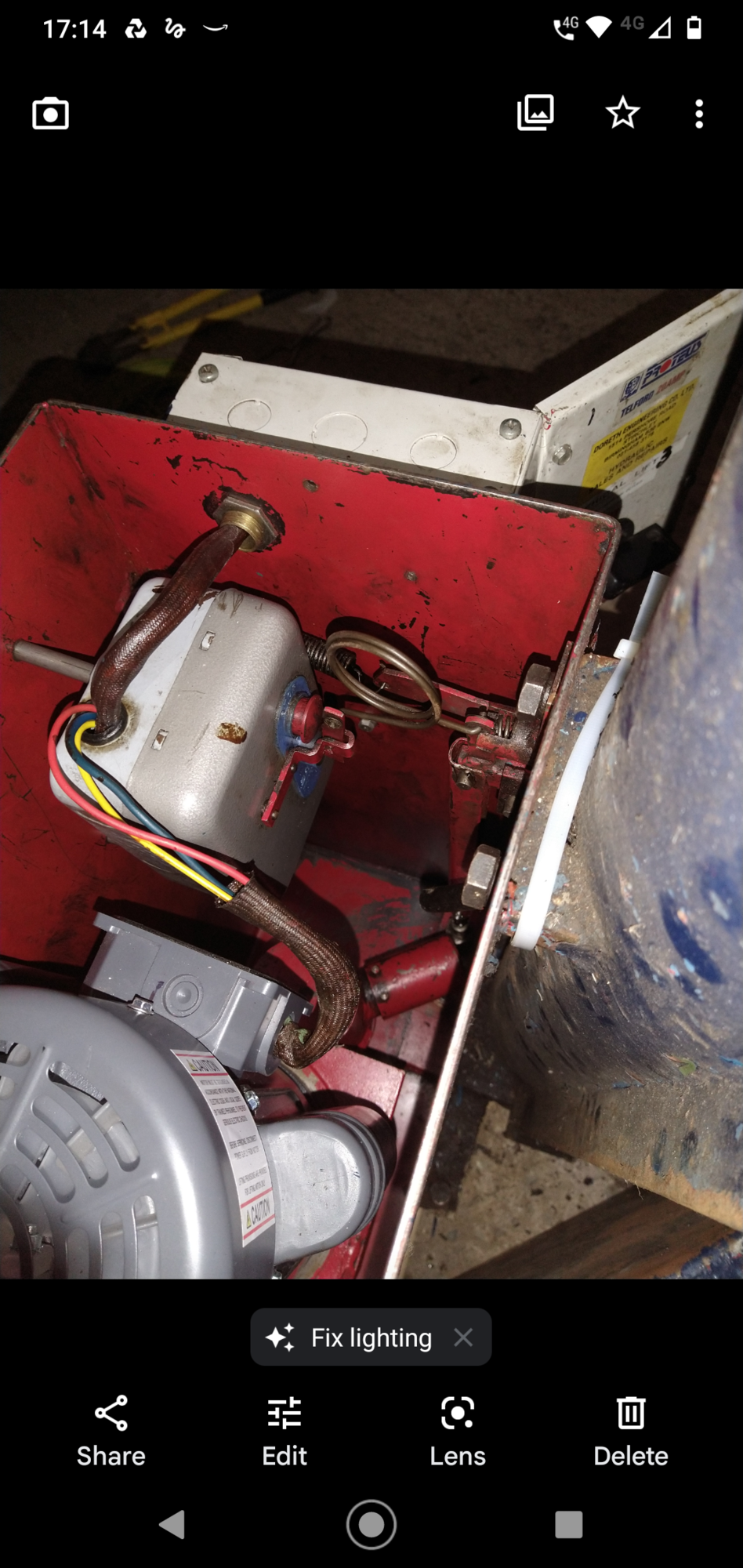

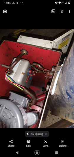

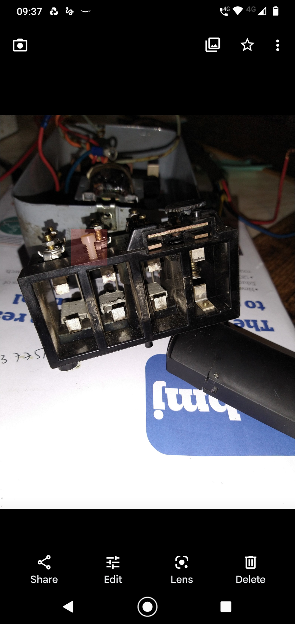

I'm attaching numerous photos which may/ may not prove useful.
Mechanical external 'up' mechanism appears to close contact (top right, beneath wheel) - but no continuity across A-L1, B-L2, C-L3 when closed
I have manually closed the coil contact and have continuity across A-L1, B-L2,C-L3.
No continuity between top right terminal (1) and any of A,B or C.
Does this help?

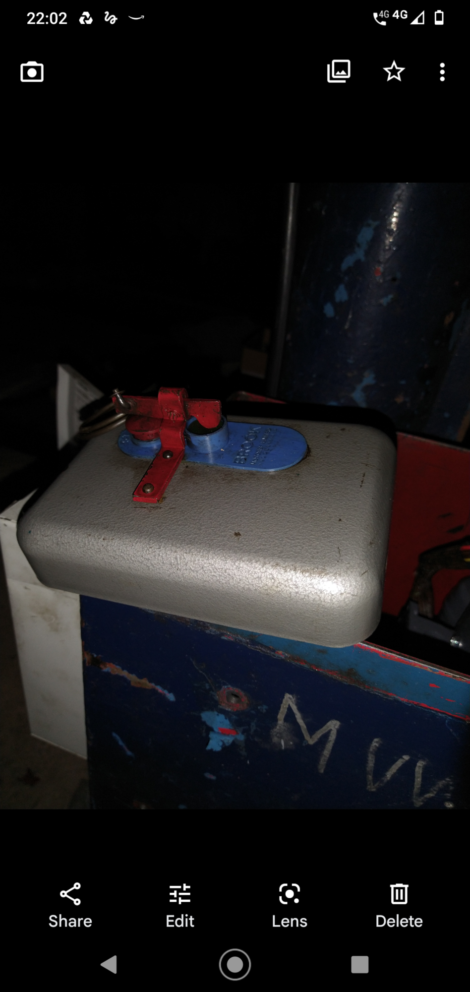

The operating controls on mine are two push buttons and a lever. The ramp, when in use doesn't rely on the hydraulic ram to keep it in position - there is a metal bar alongside the ram housing which has rectangular holes in it about every two inches, you raise the ramp slightly higher than you need, then lower it slightly, and a solenoid operated peg pushes into the hole in the bar that is along side it, taking the entire weight of the ramp bed and whatever is on it.
The LH push button on the control panel starts the motor/pump, retracts the peg, and raises the ramp. You then release the button, pull the lever downwards, and the ramp lowers slightly onto the peg.
To lower the ramp, you push the fist button momentarily to raise the ramp slightly and take the load off of the peg. Next, you push the RH button, which powers the solenoid that retracts the peg. This button is held in, and the lever pulled down, which opens the oil return valve, allowing the ramp to descend. To stop the ramp part way down, you release the RH button, peg goes in, then you release the lever, when the peg reaches the bottom of its 2" hole.
Does yours work the same way?

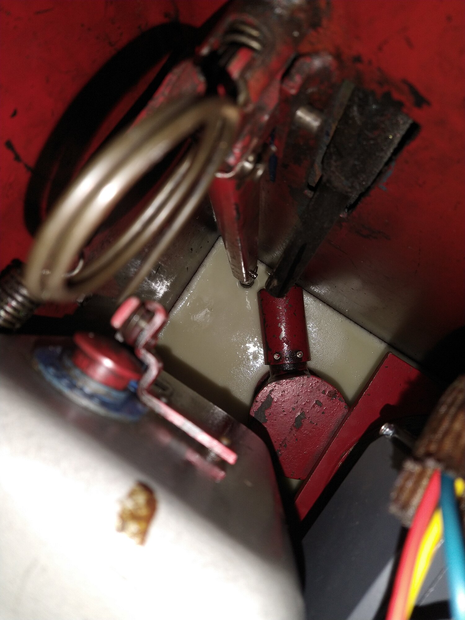

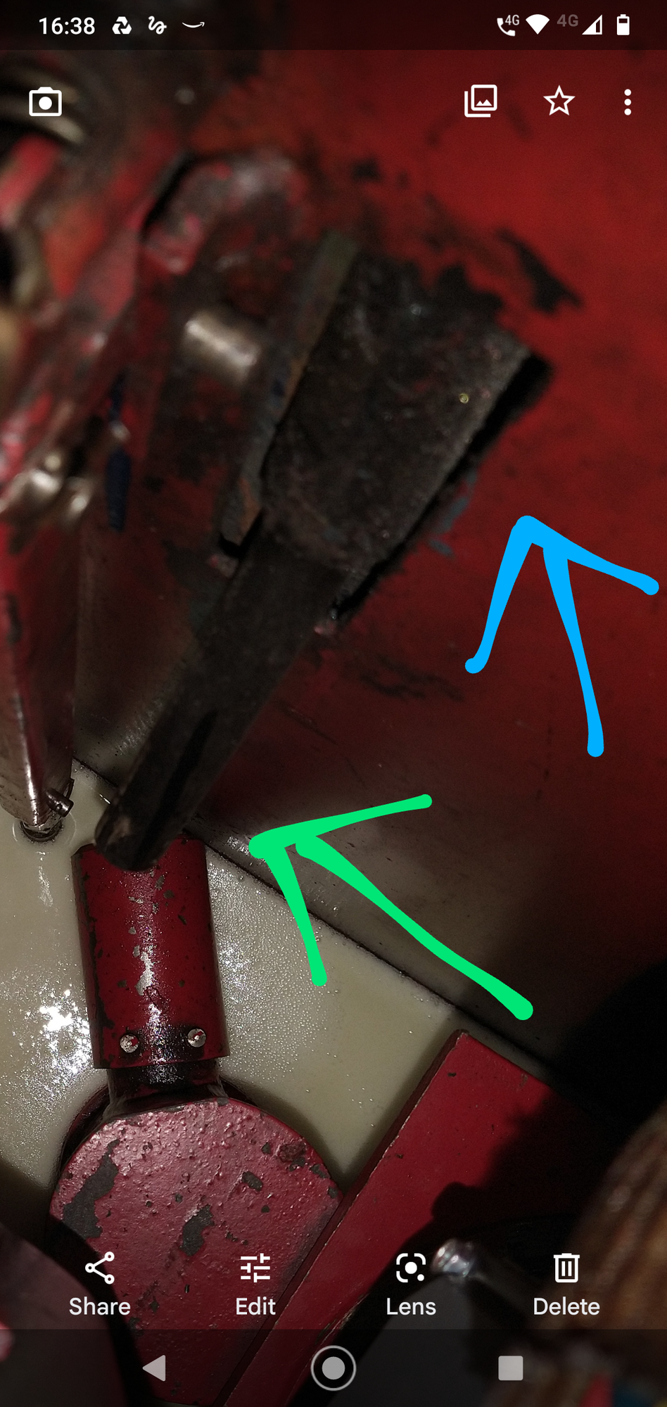

I haven't been able to understand from photos how the lever moves the contact, but is there any adjustment facility? It sounds as though it is supposed to fully close the contact.
Sorry Tim, I should have provided an explanation to accompany photos. Moving the [post mounted] lever operates (through mechanical linkage) a mechanical spring loaded 'pivot' attached to the Dol starter front cover - which depresses the button (eg green - if lever up) on the Dol starter enclosure. Both buttons have rods attached to their rear - green is the shorter. The green button rod depresses the spring loaded contact plate below the adjustment wheel and completes circuit. I will take a close look to see if I can adjust rod length - if that's what you mean. - I could also wire it up and carefully depress contact manually with cover off - make sense if knew wiring ok first?

Looks like you're going to have the problem of either finding a 230V coil for that contactor, or arranging a modern contactor so that it can be operate by the existing mechanical linkage.
Could possibly be solved by a panel mounted pushbutton, as on mine, and two handed operation.
