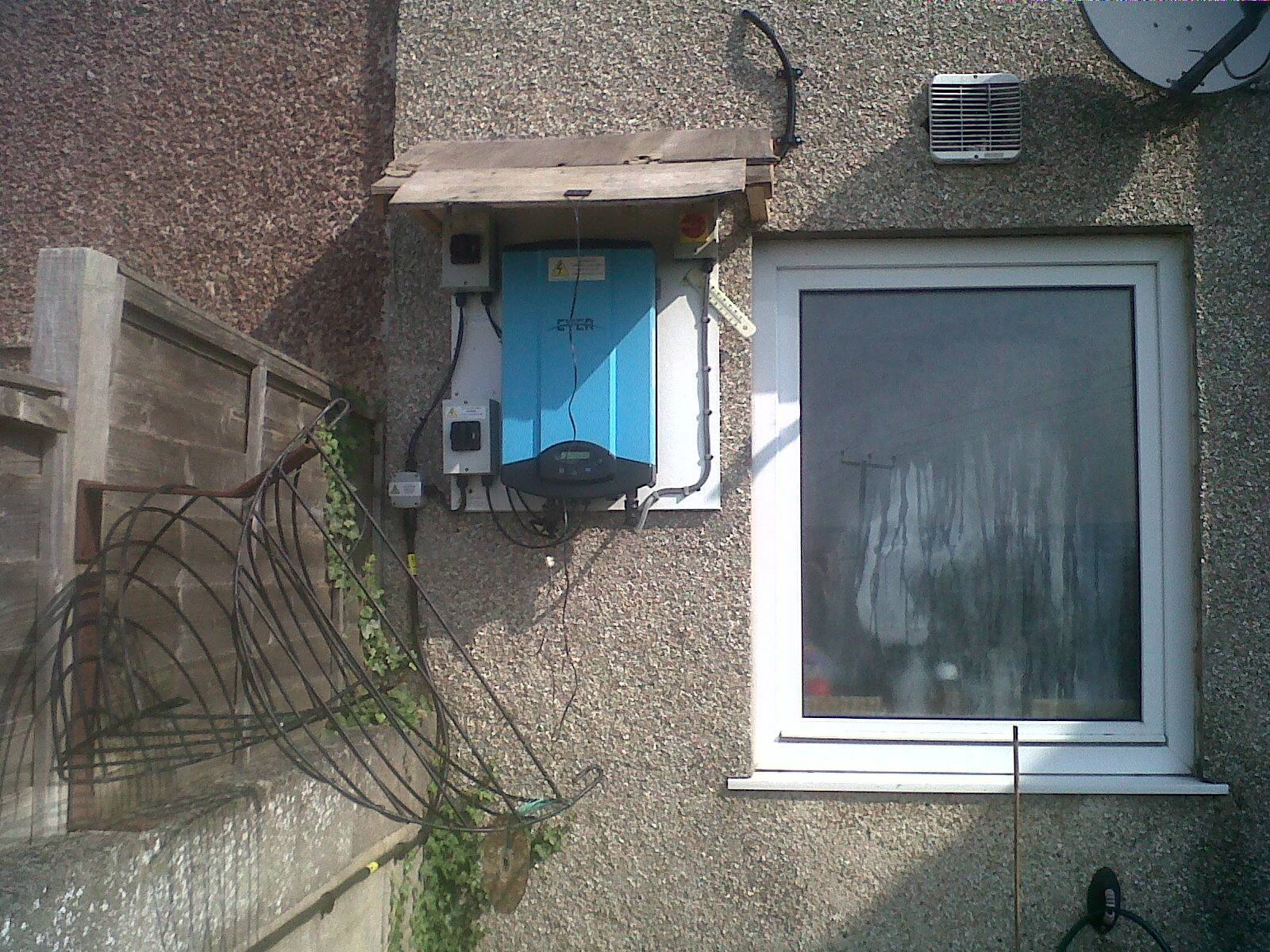

Last July I installed at home an Eversolar TL4000GB, connected to 2x8 Suntellite ZDNY250C60 modules. The inverter is sited outdoors, facing south (160[SUP]0[/SUP]). I did put a roof over it in April, and added a £3 solar fan from ebay last month!
Picture taken 9am today, inverter is in full shade from ~11am.
Both DC and AC cabling are 6mm[SUP]2[/SUP], AC volt drop 1%, DC Volt drop .5% or thereabouts. Grid voltage is 242V pretty much whenever I measure it, there only seems to be 1 other ~2kW installation on our substation as far as I can see anyway. Insulation Resistance >999MOhms AC and DC. Continuity good.
Now I first noticed this problem ~2 months ago I guess and its getting steadily worse. Whenever there is anything like direct sunlight, and anything like heat (18[SUP]0[/SUP]) the inverter says Reconnecting to Grid and cycles through a countdown. It won't reconnect again until hours later now. In fact its just done this (10.30am). There is no error message. When I first noticed this, if I turned off half the panels, it would function fine but now even with just eight panels it cycles in Reconnect mode.
I've tried contacting eversolar via email and their service section of their website but no replies as yet.
Any suggestion as to what my problem is, what I should test/check, how I can solve it?
I'm not a very experienced installer (3.5 installs) and so other than the obvious I'm at a bit of a loss.

Did it come with a 5 year warranty? It might be time to discuss the matter with your supplier. They should have some technical support. It might be a good opportunity to practise your Mandarin!

Update after calling supplier:
They suggested checking the Voltage drop by locking the display onto Vac so I could check whether it was trying to push too many volts through, luckily the sun came out and for the minute or so before it tried to reconnect again, with the power between 3.6 and 3.9kW, the Vac was around 244V. So not a voltage drop issue.
That's odd though isn't it? I'd noticed once before that the Power reading actually went over 4kW.
Taking my measured reading of 242V (supply), 242Vx16A=3872W.
Using the nominal value of 230, we get the 3.68kW.
I'm going to pop my clamp meter around an AC line and see if I can get a measurement while the sun's out and before it tries to reconnect to see if its outputting more than 16A at any point.
There's nothing for the installer to alter with this inverter, its factory set.
I wouldn't worry about the >16A thing - that won't affect the running of the system.
This sounds like a high voltage thing despite the readings you are getting. Have you noticed the Vac while the inverter is actually grid connecting and producing?
The Vac from the inverter display (i.e. not measured by me) was around 244V for a minute or two today while the Pac display was around 3.7kW. Then it shut down of course. The value in the manual for Grid Voltage range is 207-264V.

We've never installed one of these outdoors but I know they are IP65 rated. Siting it in direct sunshine is probably not a smart move so could you relocate it or extend the overhang on the cover?
Have you considered replacing this unit with another brand for a few days? If the other brand struggles/fails, you'll know it's not the Eversolar unit at fault and the problem lies elsewhere.
Did you install it in damp conditions? Could it be that there's some moisture in the internals?

@balbecdaze, sorry didn't mean to 'dis' you, this is straightfoward trouble shooting.
1) Check actual voltages at inverter - that's where the high voltages are - the drop happens between the inverter and the incoming.
2) No different than testing a CU, - you have exposed conductors then.
3) On most inverters, you can test the voltage (and fire them up) even with the cover off, sorry can't comment specifically on the EverSolar ones.
4) If you can't, then why not temporarily wire in an IP65 rated outdoor socket to the isolator.
5) Most important - check the country settings on the Inverter - it is set to G83/1-1 isn't it?
- Looking at the spec sheet it appears this isn't configurable and despite being set to 264V @ 1.5 secs, the actual trip values in the test were 259.4 even so, that's pretty high.
6) See if the inverter can display the frequency, if it's not overvoltage it may be that. (Very unusual but it may be)
If all else looks OK, I guess some of the components must have failed, so you should get a swap out unit.
@ whinmoor, no dampness, installed during a lovely hot weekend, end of july last year. Could there be dampness in the inverter anyway? I guess of course, just from condensation whenever the box is colder than the internals.
Panels are 25m from inverter (well, 25m 6mm SWA plus a metre of the 4mm solar cable the panels themselves use).
Direct sunshine - that is, I think, what I've learnt from this install (at least its at my own house!). I could extend the overhang (have done once already) but to be honest, I think the damage is done. It wouldn't even start today once it was overcast after it had had a bit of sunshine.

And, standing over the AC isolator with my meter, measuring the output voltage and it cuts out at 242V, Power output at that time was approx 2.6kW, frequency 50.0Hz for what it's worth. This confirms earlier readings from the inverter itself of happily within range voltage outputs when it cuts out.
Any other ideas and do I have to deal with the manufacturer or should my supplier take care of it if it is a warranty issue?
As has been previously suggested, are you absolutely sure it's been set up for G83? (220V+10% = 242)

IME all inverters we've used actually display 'G83' on screen at some point in the start up procedure for the inverter, so I'd really advise to switch the inverter off and on, then watch closely to ensure that it does actually display this in the start up procedure.
If not, then I'd say there's a good chance it's been set up wrong despite the sticker.
Another possibility if that the nominal grid voltage has been set wrong at 220V, which the inverter would use as a reference to set the maximum sustained voltage at +10% of that level.
For my money, those are the 2 most likely scenarios here, can't think of anything else it'd be to be honest.
eta - ah, other than the inverter being outside in full sunlight and overheating as a result. They shouldn't be put in full sunlight.
That, for my money, is what did it. It didn't specifically say G83 on startup, although it did say TL4000 GB, the GB standing for UK setup. As I say, its happily output at more than 242V on colder days.
So, after calling the supplier again yesterday, what arrives today?
A shiny new updated inverter.
