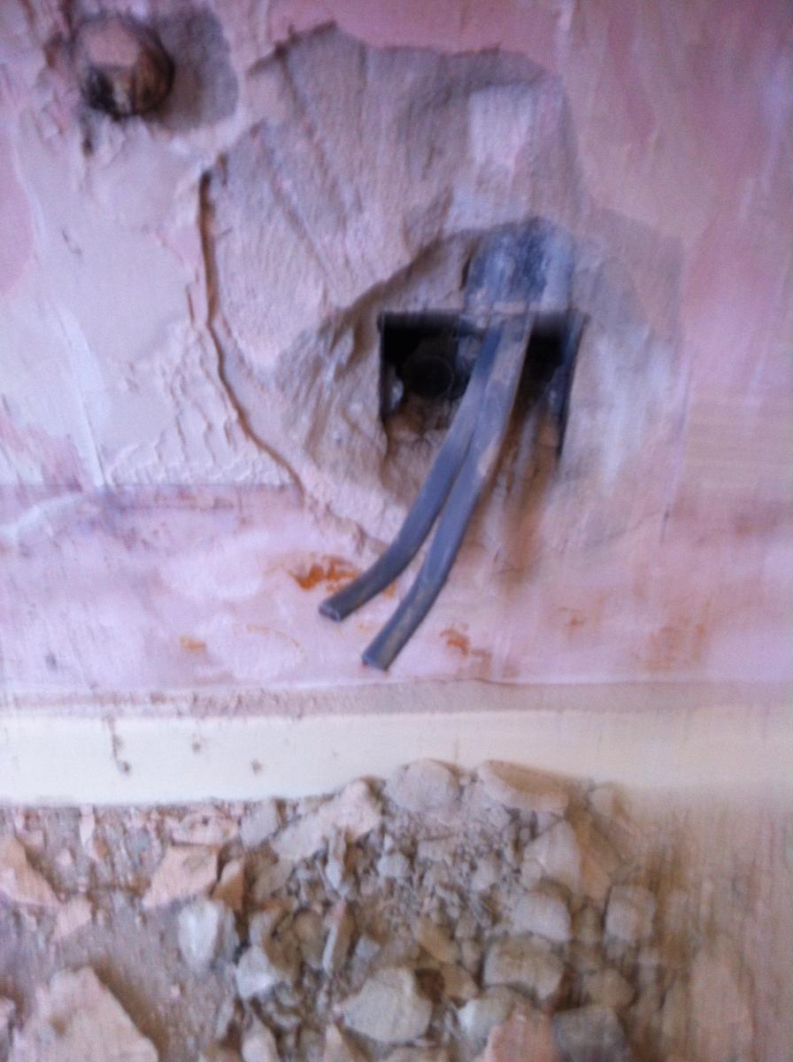

I did a kitchen refurb recently in a 60's house. Property had a new CU fitted 2 years ago, and the sockets were on 2 radials, which is unusual for the area. Whilst looking how to re organise the kitchen radial, I discovered 2 x tw&e under the floorboards, going down into kitchen in capping in the wall, and I found this. Looks like the house had been built with a RFC, but the sparky missed this one, thanks to the plasterer. Both still live, by the way.
