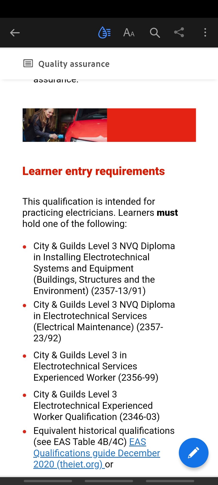

Thanks for the advice. I have seen some hybrid courses C&G 2365 level 2, would that be a starter course. I need online study with weekend practical sessions as I can't get time off work to attend for block training. Anyone heard of a company called totalskills? They offer the flexibility that I require while studying and doing the practical aspect over the weekend.
I looked on the C&G website and there is no mention of an NVQ
See here; Electric Vehicle Charging Installations - https://www.cityandguilds.com/qualifications-and-apprenticeships/building-services-industry/electrical-installation/2921-electric-vehicle-charging-installations#tab=information
Around Page 6
  • 2921-33_qualification-overview-pdf.ashx.pdf
  • 2921-32_qualification-overview-pdf.ashx.pdf
It's worth noting that the 2919-01 and 2919-02 have/are being phased out and replaced with the 2921 series and will require the NVQ as a prerequisite.
Okay, I thought you meant an NVQ attached to the EVC course. I see Trade Skills bundle the EVC with their Domestic Installer Part P course so how can they get away with not meeting the requirements?
