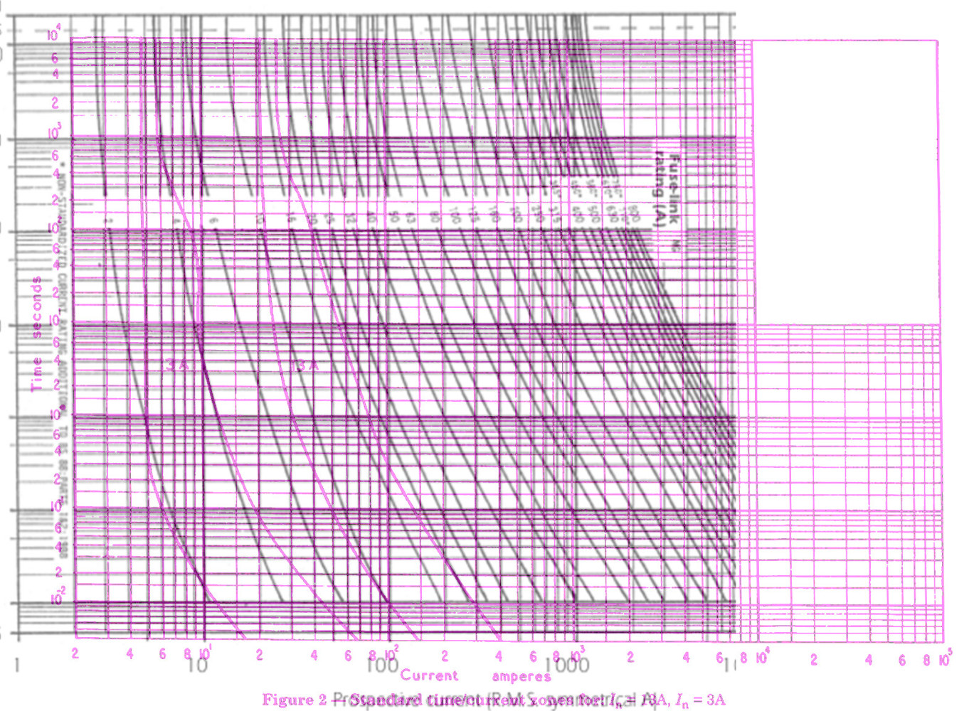

I have tried an overlay of BS88-2 (black) with BS1362 (purple) and it seems to show discrimination (just) until you get to short circuit levels of fault current.
Therefore the 13A should go first, however at full fault current any melting fuse is going to to be close to going and it will be close which goes first.
Perhaps using motor rated 20A fuses, if this is acceptable for the circuit characteristics, may be an answer.

I think preventing the short circuit in the first place may be better, perhaps finer filters over the grinders motor intakes (with out restricting air flow).
