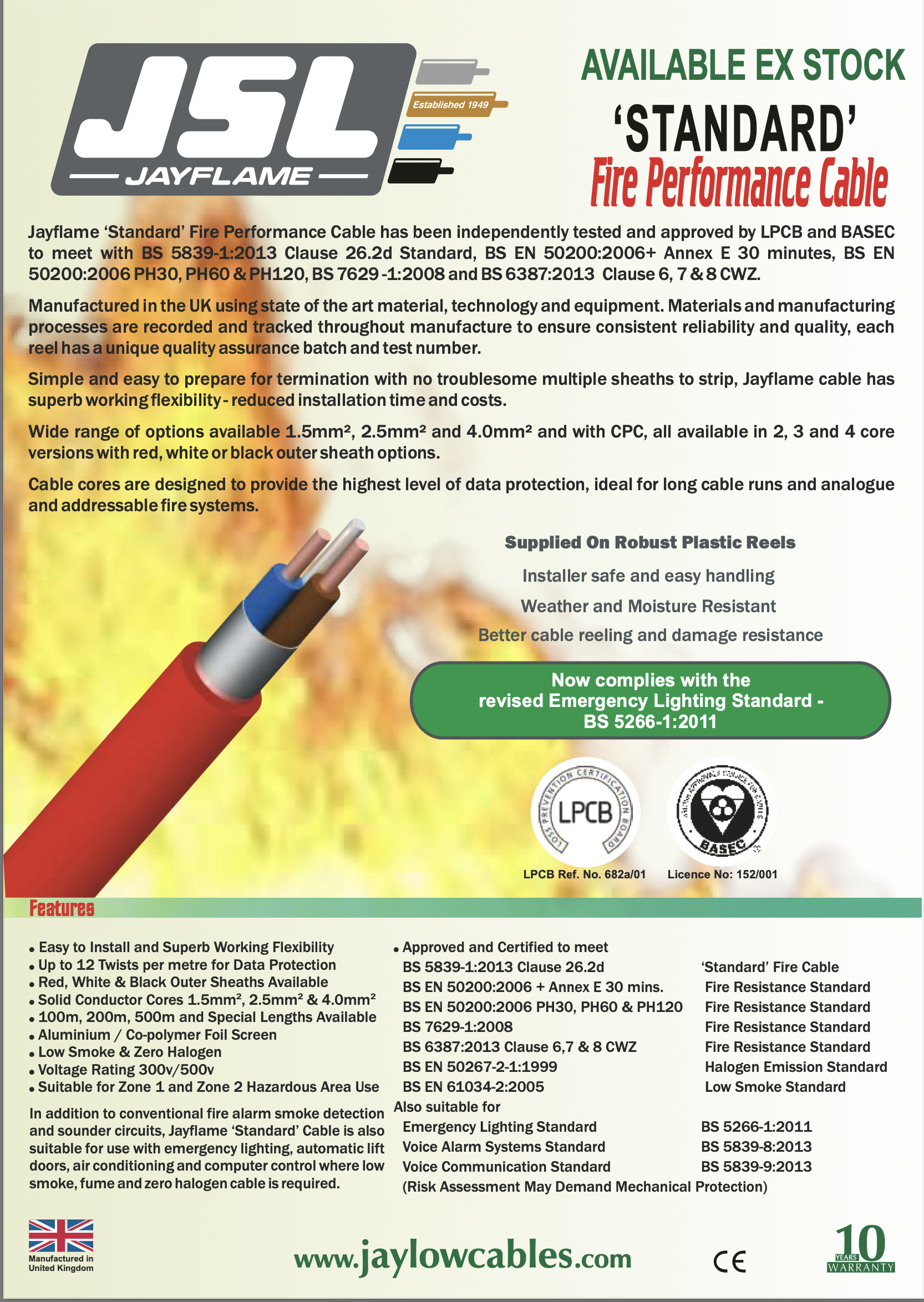

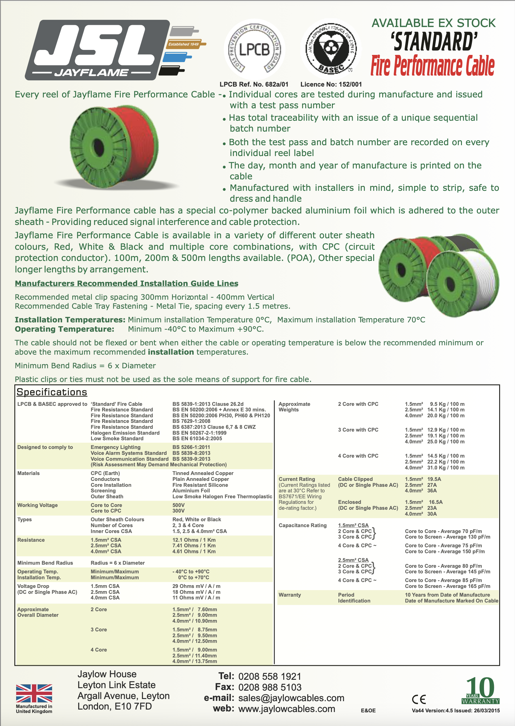

surface mount FP200 might be a good shout, it is an option that you could put to them.
although, i think its only available in red or white, might not blend in as well as galv conduit.
Sounds like a good option with the FP200... I've had a look and is available in black which would work.
Also going to suggest putting this circuit on and AFDD (not fitted one yet.)
Comes in black
Recent church I stopped by (still boasting it's wooden Wylex rewriteable board) had had some recent work done. Type A RCD fitted adjacent the wooden board in an eclosure and black FP200 used with linian clips to add new sockets. Pukka job I thought.
