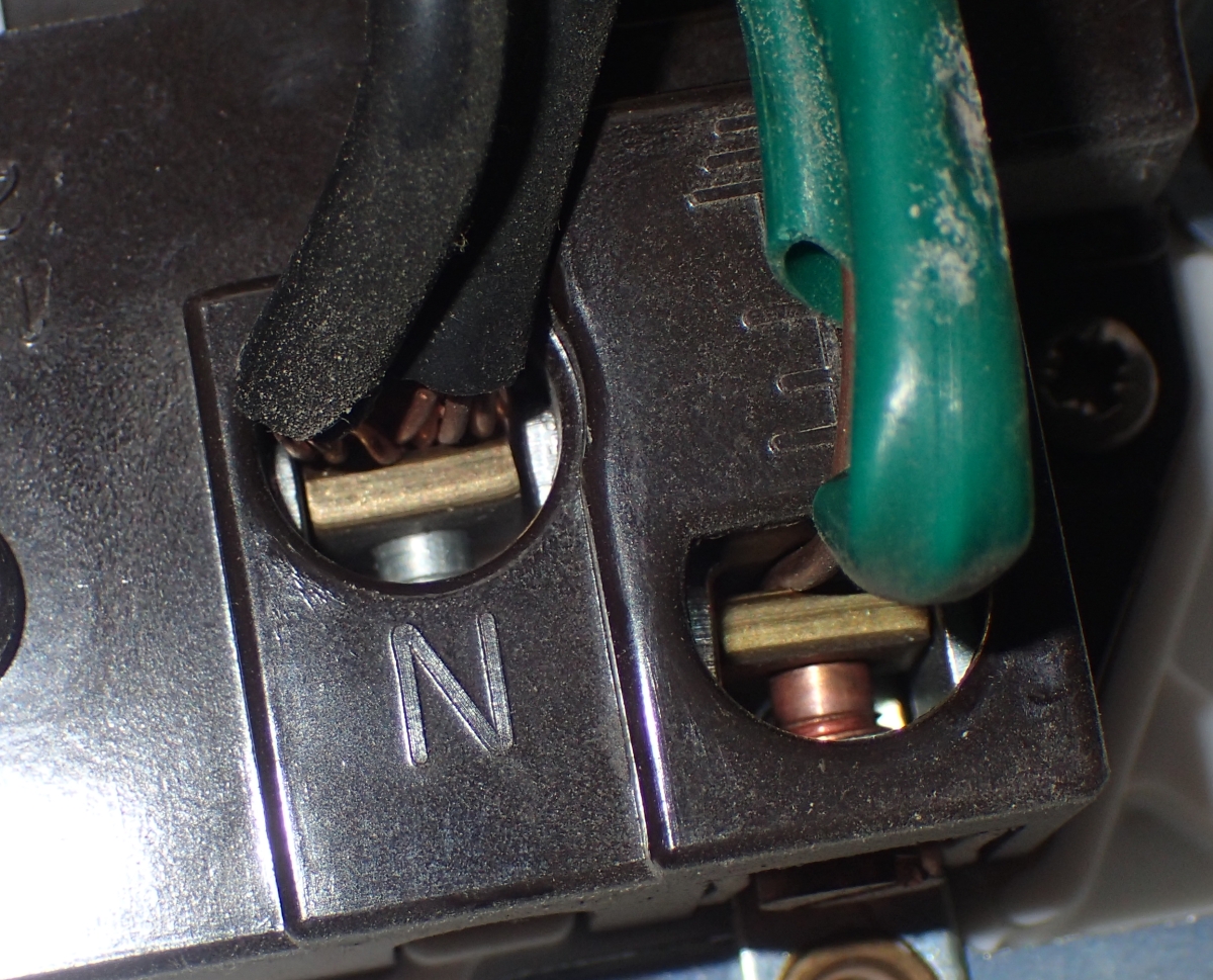

@SparkyChick , I've worked on all aluminium cable too, this doesn't seem to be as bad as I remember that stuff being. Perhaps because the lighting is wired in 1.5mm rather than the 1mm pure ali, and the 4mm ring conductors are stranded rather than solid. Had to be quite carefull stripping the ends of the 4mm conductors, I found gently ringing and slitting the insulation with a stanley blade, the peeling it off worked best.

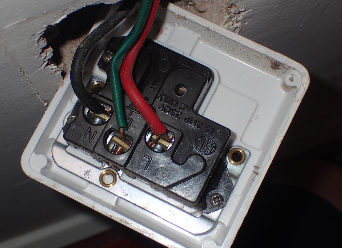

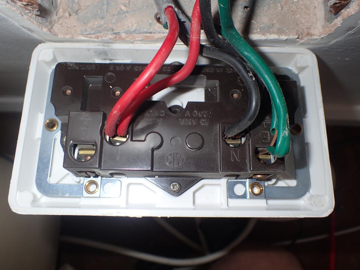

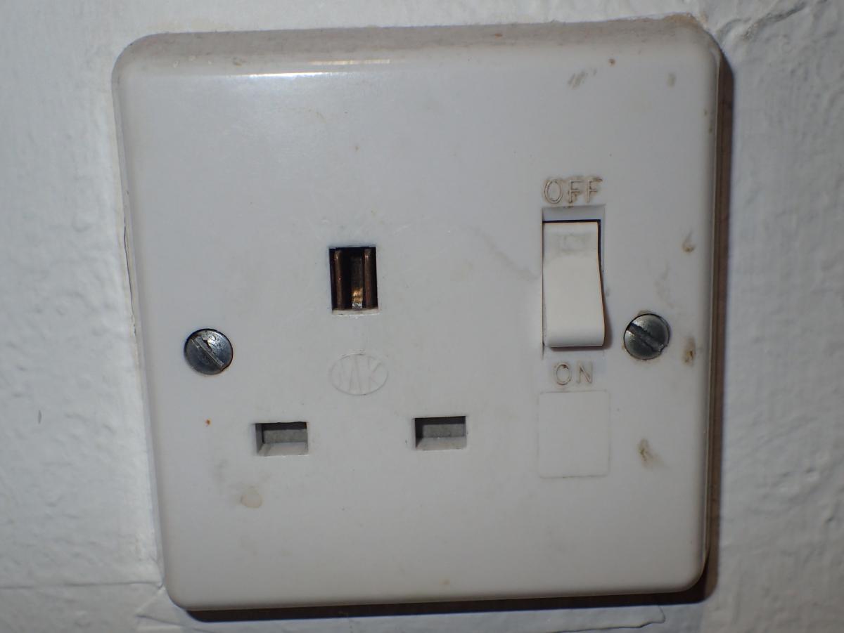

I believe the sockets may be the ones specifically designed for alu cables
Indeed they are. FWIW I have some sockets in the collection but very little cable. If anyone pulls out any ali or copperclad ali I will give you more than the scrapman for it.
There is an estate near me that was built around 1970 a lot of the properties have their final ring circuits wired in aluminium and copper clad alu cables. I know of several that are still in use and in reasonable condition. All have sockets with terminals as you have pictured and are beginning to look dated! Absolute tw@stard to work with, I have had to wago to copper cable on occasion when the conductor was too short due to it snapping on me or me snapping it!

I hope you sorted that stray live core on the single socket.
Indeed, at a glance it's hard to tell them apart. You have to look closely at the cut ends for the aluminium. Clues are the size - 4mm stranded on a ring final, and, in this case at least, the accessories. They're softer than copper, more brittle too.
