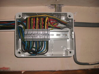

here's one i made earlier (2015).
or use plain connectors, not the earthed ones.also you don't need a metal box as it's not a CU or similar switchgear.
That looks great. I'm planning to do something like this to tidy up an ancient 240v fire alarm system that is currently unenclosed spaghetti in screw terminal blocks that someone threw in a cupboard in the 1970s.
