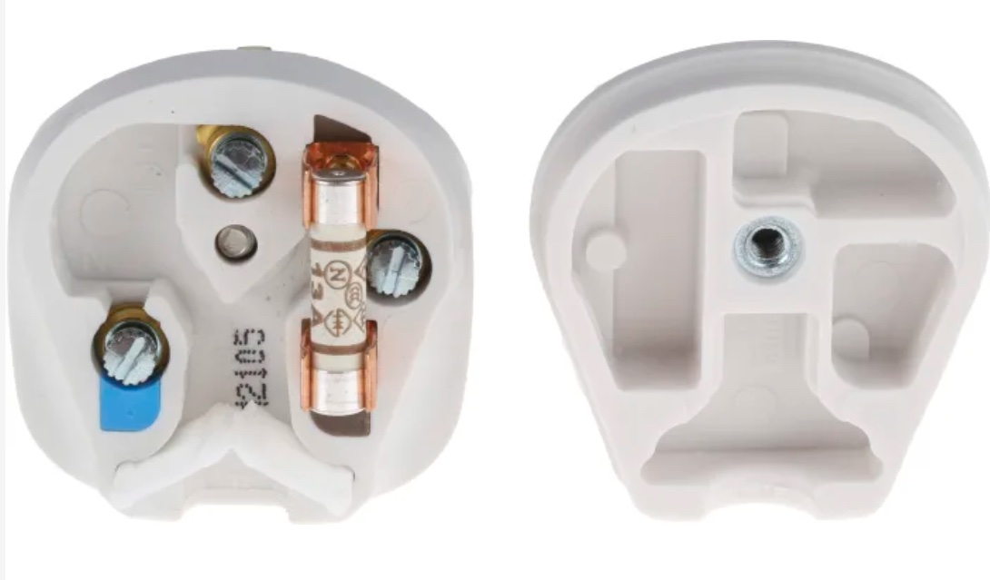

Hey guys
Should you double up a stranded cable inside a plug when terminating then ?
Using a 1.5mm heavy duty orange rubber flexible cable. And a heavy duty masterplug.
Thanks
The terminals are designed for a single conductor only.
By this I mean, a single conductor not a number of them or one folded back on itself.
This would include stranded conductors
Depends on the size of conductor vs hole in terminal.
For very small, such as table lamps or the “figure 8” leads for radios etc, I’d twist and bend…. Larger cable, just twist….
But ferrules would be better in both cases
I'm an old school folder as well. It always used to work well in the days when there was actually real copper in the wire and real brass in the terminations but all too often nowadays the screw is steel and it cuts the fine strands of the wire as it's tightened. I guess it's up to the sparky to compensate for bad manufacture and corner cutting by using ferrules.
Gone are the days of a 13A plug with wraparound screw terminals. Didn’t matter how much you bared off… just wrap it around the screw under the washer and tighten.

I've always taken the line that the hole in the terminal should be filled as far as is sensible, so yes, double over wherever possible, always works up to and including 1.5.
