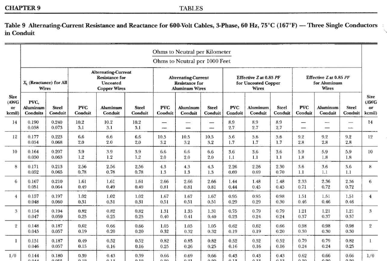

Ok- here is a commercial/industrial US breaker trip curve:
If I'm reading the above time current curves correctly:
0.8 disconnection time on thermal takes about (roughly) 15x the handle rating worse care.
0.4 disconnection time on thermal takes about (roughly) 22x the handle rating worse case.
Assuming a 20 amp breaker-
15 x 20= 300 amps. At 120 volts a loop of 0.4 ohms is required.
22 x 20= 440 amps. At 277 volts a loop of 0.62 ohms is required.
A 500 foot circuit run consisting of 3.31mm2 wire has a R1+R2 of 2 ohms.
3.31mm2 wire has an 60Hz AC Resistance of 0.002 ohms per foot at 75*C.
At 120 volts I am limited to a 100 foot run. (30 meters)
At 277 volts I am limited 50 a 155 foot run. (47 meters)
Not unrealistic for a good chunk of circuits.
Technically I am incorrect to use 120 and 277 volts in that supplies vary below this value, but at the same time a 75*C resistance covers it reasonably well for the discussion at hand IMO.
Am I correct to conclude that it is indeed possible to provide adequate disconnection times with US breakers when the fault current does not trip the breaker magnetically? Or is this just me being overly wishful?
My mind keeps telling me that it is possible to achieve 0.8 and 0.4 with thermal elements. But I am humble in my argument. ?
Yes, it looks like that.
It has a magnetic trip as well, but not coming in until very high. It also appears (from my reading of the plot) that the magnetic trip is fixed at about 540-900A (36-60 * 15A) as you see the 30A range is about half of the multiplier.
That sort of fixed-magnetic approach is not uncommon for MCCB over here, but our MCB all have the magnetic trip at a set ratio of the thermal trip (our B/C/D curves). That example USA breaker is above our D-curve (10-20 * In) by a factor of almost 4 at 15A and 2 at 20A.
In UK domestic installations is is rare even to see C-curve being used, and D-curve is usually restricted to very high inrush things like big transformers or motors.
Those look right and reasonable, though you have not allowed for the supply impedance (probably quite small for USA with 200A boards and TN-C-S style of connection as common).
Yes, voltage range and starting temperature for working resistance would reduce that distance by 20-30% or so.
You are right that they can meet our sort of disconnection times on the thermal part. But are doing so at far higher currents than we would expect to see without the magnetic part tripping.
Much of your example thermal curve is "inverse time" and approximately constant I2t, so a reasonably good match for cable protection. But it is allowing of the order of 45k A2s let-through for a 15A breaker, and we would only expect to see that sort of a fault energy at PFC of around 10kA, or at around 40A when it is quite slow to trip and some of the fault heat is able to escape (so less "adiabatic" in the true sense).
