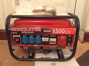

A customer has bought this as a back up generator for when his house power cuts out:
It's a £300 ebay jobbie, 220V/380V, 'supposedly' with AVR. It's rated at 6.5kVA at 380V and has a three pole C3 OCPD. I went to have a look this evening (I hadn't seen it beforehand) and tested for a floating earth which it has. I didn't get a chance to test it whilst running. There are no manufacturers instructions or specifications, no definite information on the winding layout, no information on anything at all, anywhere. I've been searching the interweb for hours!
If I'm honest I wouldn't trust this chang wang piece of crap as far as I could throw it and have told the customer in no uncertain terms that he really needs to think about sending it back and getting something fit for purpose. He's looking for reasons to ignore me! The problem is that if I don't help him out as best I can and he finds someone else, I'm almost certain I'll be missing out on a rather tasty barn conversion for him later in the year!
Wants me to just link the N-E at the supplied schuko plug and throw in a stake. I'm not happy at all! Not one bit!

Persuade him to use it as it was intended. Just run a few extension leads around the house, if there's a power failure he must just start that piece kak and plug things into the leads.
What make is the genny supposed to be? I'd be interested to see what instructions are available online?
It has no make and there are no instructions! It's some imported chang wang piece of garbage.

If the generator is solely to be used as a back up power supply for the house, then fitting a N-E Link at the generator is really the only option. Depending on the generator this should be a reasonably easy operation and preferably non destructive to the generator, the connection can be a screwed joint so long as it is easily maintainable so it could be removed if required. I do not see why a standard modification to a piece of equipment by a competent person should invalidate a warranty.

Even the supplied generator could be used if the earthing arrangements could be sorted out and you were sure of the "Pure sine wave" output and it had any form of standard to which it is made.
At least if you made modifications to that the warranty would be non existent anyway.
For earth bonded neutral you would, I think, probably be looking for fixed generating sets that would exceed your customers budget.

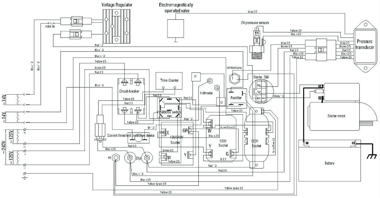

It depends how the alternator windings are connected, sometimes it can be a pain converting a floating earth to a referenced earth. As this standby gen-set is going to be permanently located/positioned, it's no longer classed as a mobile/portable unit. As such it should be earth-neutral referenced....
I can't say how the windings are connected. Annoyingly the only picture I can find seems to be for a US version of the gen set:
I can't say how the windings are connected. Annoyingly the only picture I can find seems to be for a US version of the gen set................
