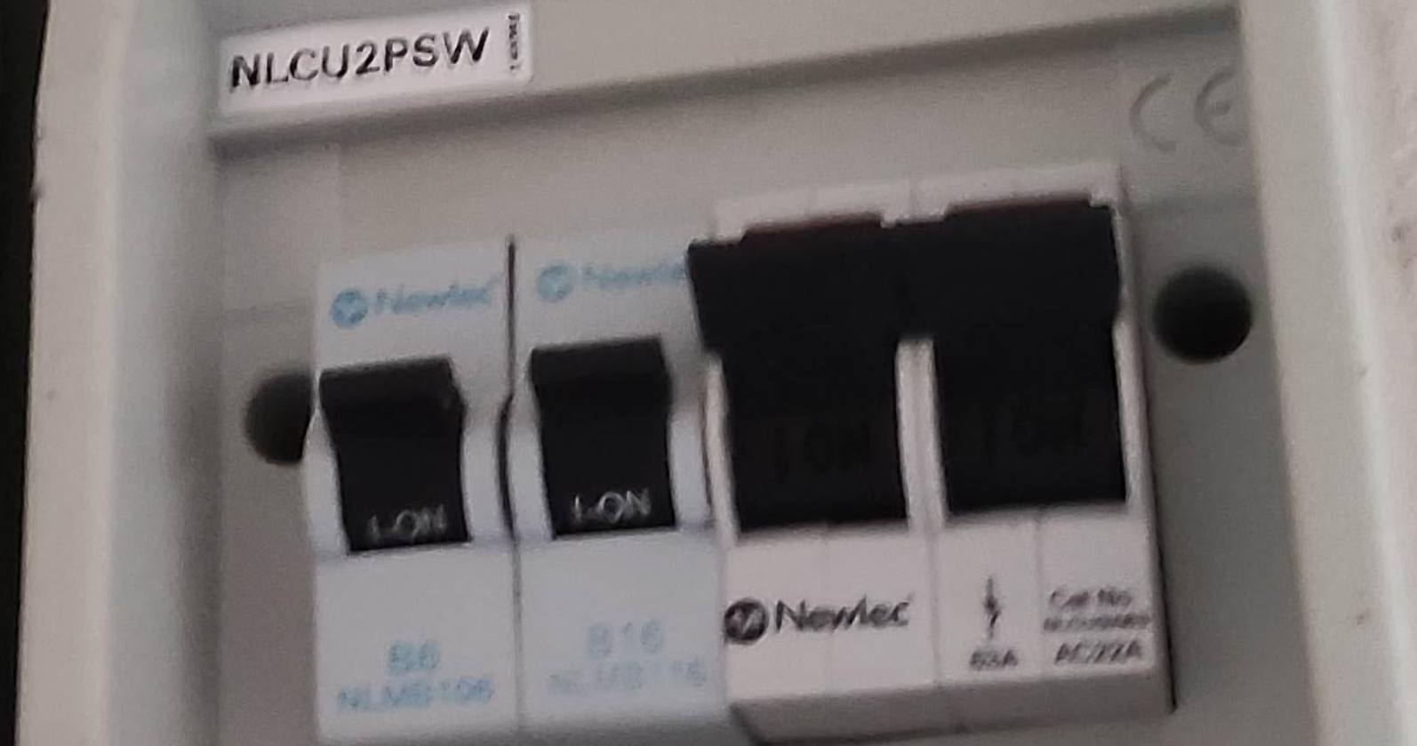

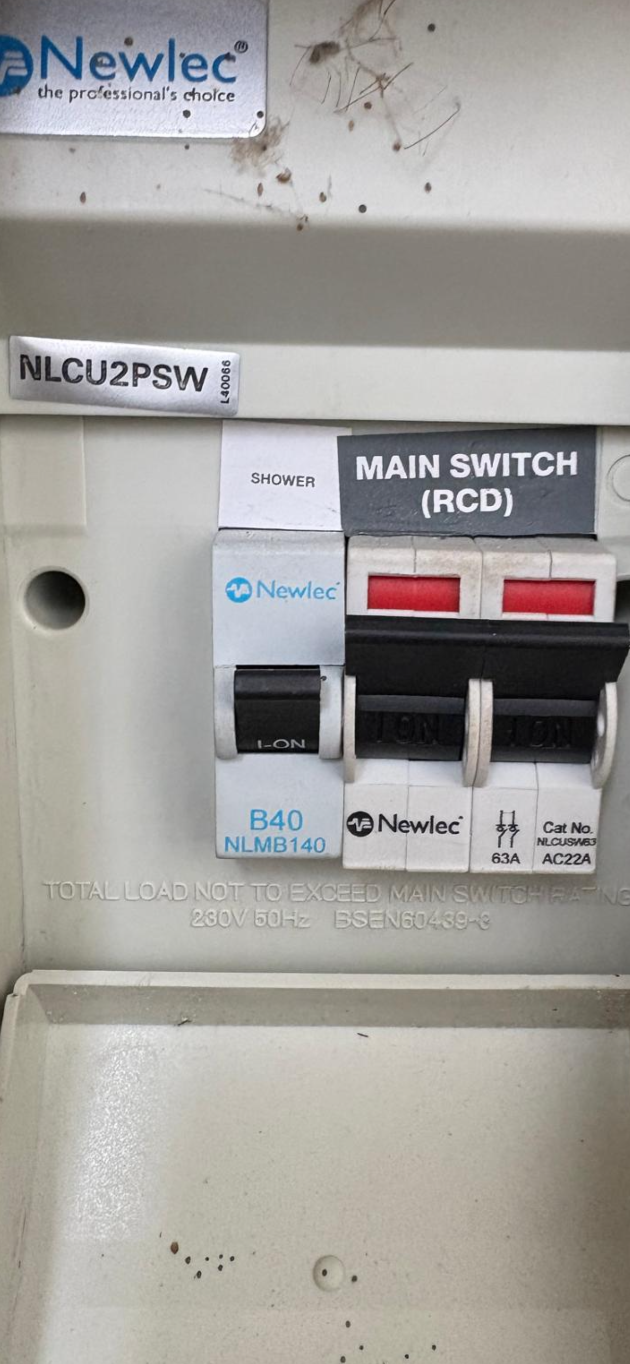

Yes but would have to be an rcbo unless you are using armored cable ,but then it would need an rcd at hot tub end .much easier changing that to an rcbo but unsure if you would get a brand new rcbo in that range ,maybe someone else will know.im sure I'll be corrected im not that familiar or can't remember the layout of that type of boards but the mcb seems to be in the wrong side of mainswitch but maybe there's a manufactured piece of busbar feeding mcb .the live I believe would enter on the right hand side of mainswitch .its also only rated at 63 amps which seems odd if its your main board for house .it looks like it's been altered at some point .it also says rcd on it which it isn't. But your sparky will keep you right .do you no your earthing system type .does it say Pme on main cut out fuse
That consumer unit looks like it has been adapted that mcb should not be located there and that Main Switch (RCD) is not an RCD.
I thought that but I think it is OK there is space to the left of that MCB for a 2nd MCB. It is a 2 Module CU.
The case must be able to be cut to suit the modules I am presuming. Got that from looking at an example online.
Of course the Main switch is labeled RCD which is not correct and is misleading.
This is most likely a Sub Board and if that is the case is the supply to this RCD protected perhaps?
Yes I think your right it was hard to tell from original picture I thought it was the main consumer unit .it would make sense with the 63 amp main switch
You are correct I quickly thought the mcbs were to the right and one had been put to the left.

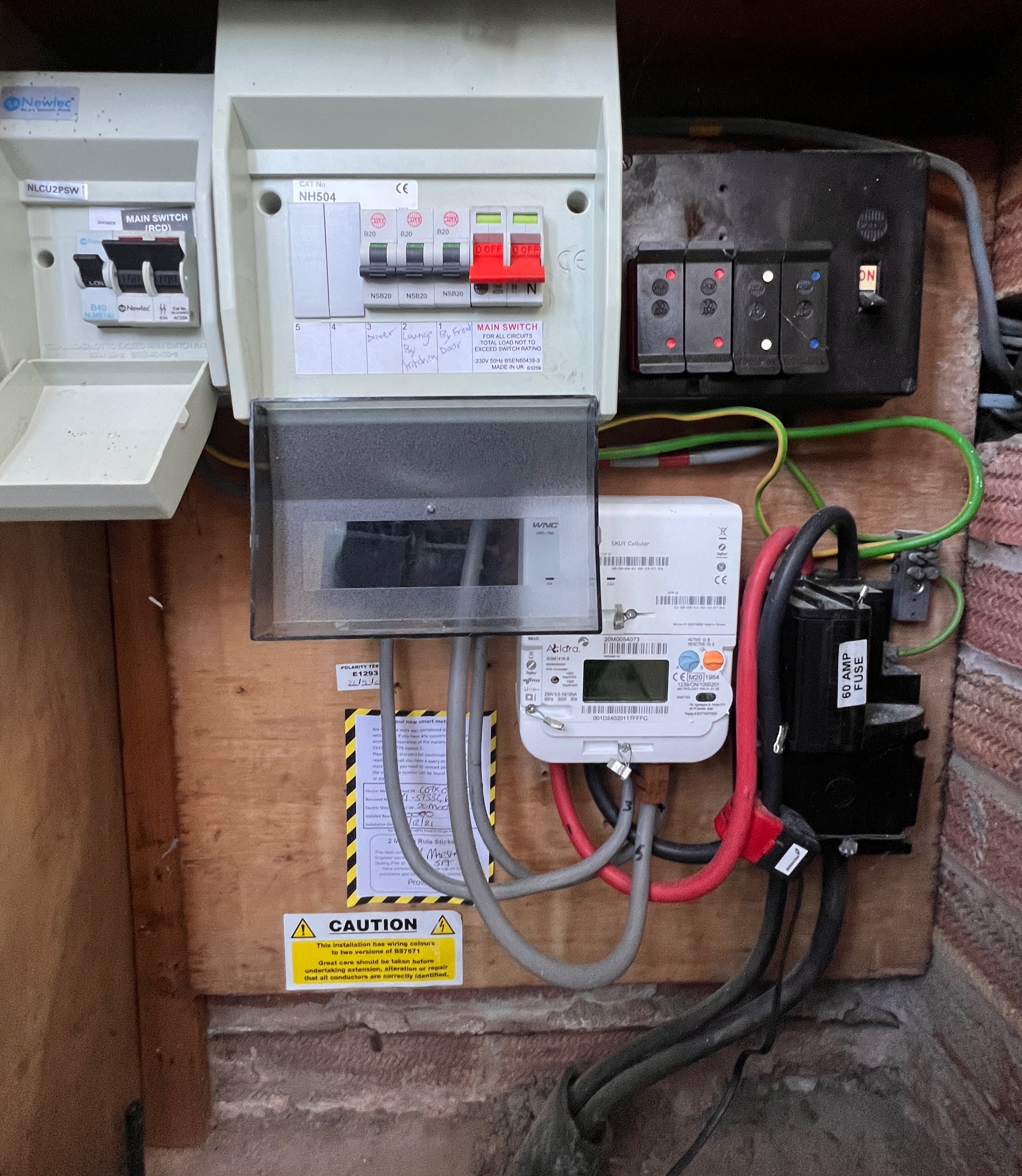

Thanks for all the helpful advice, I’m going to get a new consumer unit installed for some old fuses anyway so I’ll just change integrate that one into the new board. What I wanted to do was avoid having a new cable run from the front of the house to the back. Hopefully I can make use of the shower cabling to solve that problem.
That RCD switch controls nothing at the minute, when I first moved into the house here was no gas so that RCD was for the storage heaters which has a separate consumer unit to the right. I capped them all off when I removed them as soon as I had my gas piped in.
Not sure we are getting the full picture here!
The photo of the 2way consumer unit is NOT an RCD but you mention one to the right of it?
I also suspect another CU as a 2way (6 & 16A mcb's) doesn't seem sufficient for storage heaters! or whole house, (ie where are your cooker, ring finals and lighting connected?)
Do NOT get confused with the incorrectly labelled Main Switch as others have said it is NOT an RCD and by look of it the shower install was non-compliant as it wasn't RCD protected!
Can you step back a bit and take a photo of the whole consumer unit(s) set up, including meter if indoors.
