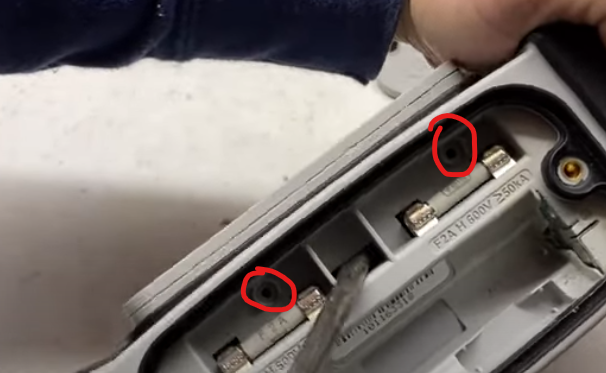

The sockets the test leads plug into are actually themselves connected to plugs which plug into the motherboard.
I'd suggest giving them a clean:
Remove these two screws:
And prise the socket block out using a screwdriver as shown.

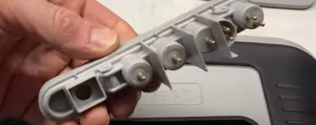

Clean up the contacts both on the sockets:
and inside:
You can also try shorting out the red and green motherboard sockets to check for consistent repeatable results, ruling out the socket block, leads, clips etc.
That will tell you if it's the tester itself or not.

But first things first - I should clean the socket block first and then short out and use known resistances directly on the PCB contacts to see if you get consistent results.
Hi guys
Quick update. Took the terminal block out tried a few resistors straight across the motherboard and was getting pretty consistent results. Put the block back in and the testers seems a lot better and more consistent readings. When nulling leads its around 0.17ish and doesn't fluctuate like it did before.
