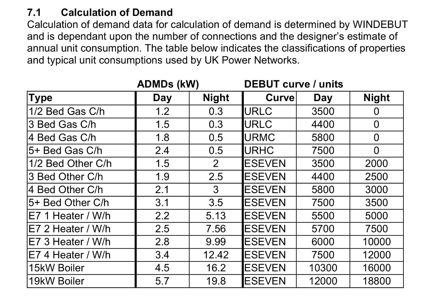

I am tearing my hair out here. I have trying to get UK Power Networks to quote for new electrical supplies in a property development I am managing. The property is a conversion into four one bed flats.
I have been asked by UKPN to provide the After Diversity Max Demand in kVA for each unit. I have asked an electrician and he said 20kVA. I asked another and he said 24 kVA.
But UKPN said this:
"UK Power Networks would in general expect the (ADMD - after diversity maximum demand) for a gas heated flat/house to be between 1.5kVA and 3.0kVA and an electric heated flat/house to be between 5kVA & 10kVA unless abnormal high usage appliances are being installed."
These units will have electric wall heaters and will be very well insulated.
They will also each have 125l unvented cylinders for water heating. They will each have an oven/grill and washing machine.
I have asked UKPN how they arrived at this figure and they pointed me to their web site (which only confuses matters and fails to show how this is calculated):
UK Power Networks - What are Watts (W), Kilowatts (kW) and Kilovolt Amps (kVA)? - https://www.ukpowernetworks.co.uk/internet/en/help-and-advice/need-help/what-are-watts.html
But on their site it says this:
" If you’re unsure and don’t tell us what you need then we would assume 15kVA but it’s important you get this right. "
I cannot seem to get them to explain. Either they are clueless or I am clueless or both.

Hi Gus - welcome to the Forum :)
It looks like they've rounded their Design & Planning figures and fed them to you. These are likely to be a good guide for the planning of electrical distribution networks. But I think the values will be subject to the rule of averages. Some of the actual demands will be less, some will be more and the result is the table of values.
Their table seems to assume E7 to provide heating as off peak demand and that may make a big difference if your plans for heating are not off peak (?).

So what should I tell them? They have said to me 5-10kVA for an electrically heated house but their web site suggests 15kVA.
Well if folks come home in winter and turn on 8kW of heating and put on dinner to cook while they take a shower the flat will likely draw more than 10kW for a while. The room and hot water heating are heavy loads, so I'd be asking for their max of 15kW, say a 60A fuse. Having said that, if they used 40kW for 4 flats it might not be far out as not all folks arrive home and do the same thing at the same time. Don't forget to ask for something for common areas supply.

It's confusing that in their emails to me they keep insisting on 5-10 but their web site says 15.
I made a long and careful list of all of the devices that would likely be used in each flat.
I added up the ratings of these appliances and came up with 25.85kw.
Of course, it is extremely unlikely that all of the devices would be on at the same time in each flat. However, I spoke to an electrician that did some work for me at home and he said this:
"I would definitely say 100 amp per flat and 23kva is what i worked it out at. 100 amps x 230volts divided by 1000 = 23kva per flat. yes you take in diversity but if its an all electric flat with no gas . somebody could turn dishwasher heating cooker shower on all at same time so i wouldn't want anything less than 100amp incoming fuse."
UKPN told me that there was a supply nearby which offered 69kva but that works out at 17.25kVA per flat. They said they would have to take the supply from somewhere further down the road if I wanted more.
(No prizes for guessing that will cost a lot more.)
I am not comfortable with 17.25 per flat after what my electrician and several others have suggested. Should I press for the 23kVA?
What do you guys think?

Hi - with 4 flats in the block there will be a statistical reduction in max demand as not everybody does the same thing at the same time. So if heating and hot water were fully looked after at 8+3 = 11kW then their new max of 17kW sounds plausible to me. However if you want EV capability that would tip me over into spending more, as EV would likely be charging at night when folks are home with heating on, showering and cooking tea etc. Perhaps have a conversation with UKPN that you are planning to have resident EV charging and see if that changes things. Just my thoughts :) .
Yes someone could run round the house turning every appliance on at once, but how likely is this to happen?
With a large un vented hot water cylinder you presumably won't be having electric showers? In which case the showers won't come in to it.
Everything else will not use a constant amount of current, the thermostats will turn heating elements on and off to achieve the set temperatures so the actual power used will be a lot less than the result of adding up all of the ratings.

Sockets and lighting I would expect to see no mare than 9 amps for an average 4 bed house. Yes this will spike when the kettle goes on etc but this is for a very short duration.
On a rough calculation you could more than likely get away with a 15kVA per flat.

Thanks Strima, that's very helpful. As UKPN networks stated they suggest 5-10vVA ADMD for an electrically heated home. However, they are unable to tell me how they arrived at this estimation.
The four flats will be almost certainly be rented to young professionals. They will be out all day during the week but will likely have very similar energy usage patterns. i.e. They will want the heating on for a spell in the morning and evening. They will all be home around the same time and likely to put the oven on.
During the summer this will not be an issue at all. I just want to be covered for hard, cold spells during the winter.
However, I am coming around to the idea that 17.25kVA should be enough per flat. I just want to make sure I make the right decision now as getting it wrong now could be a nightmare later.
UKPN came back to me and said they could supply 23kVA by routing from another source without additional cost so am going with that.
