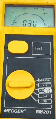

As some of you know I'm studying at college and invested in a MEGGER Bm223 just to practice at home.
I have a spare 2.5 cable at home to practice on.
Does anyone know how to use this device ? Continuity and resistance test ?

Can I stress that this instrument is for dead tests so don't go near any live circuits with it!
Either practise on a completely disconnected cable, or turn the main switch off first and check what you are intended to connect to is dead using the safe isolation procedure.
I'd also suggest not exceeding 250v IR tests until you've learned more about them.
Look on YouTube for John Ward. You want the videos on continuity testing and insulation resistance testing.
That device is gloriously simple there are only two wires.
To null the leads for continuity join them together and press test.

I've got a BM206 but I can't seem to get a zero with the leads joined ?
Would I be doing something wrong , it was calibrated a few years ago
So when you join the leads, and press and release test, it doesn't read zero?
Does the test button work when you do IR tests (press and hold) ?
