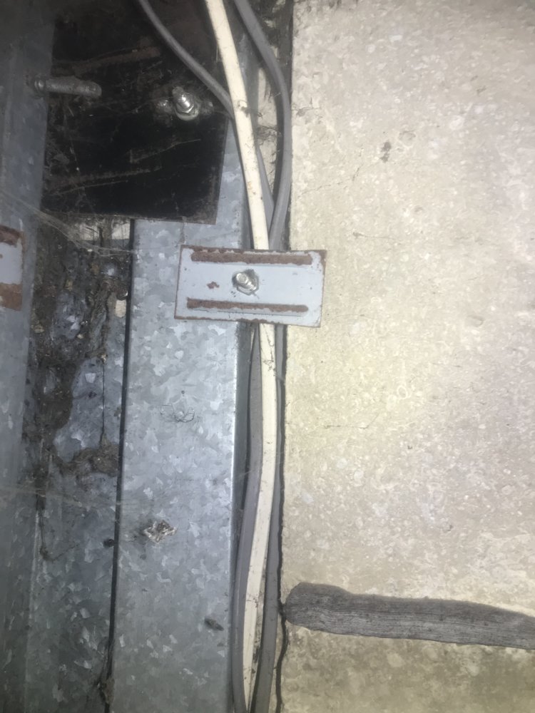

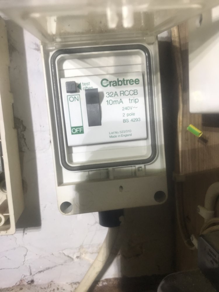

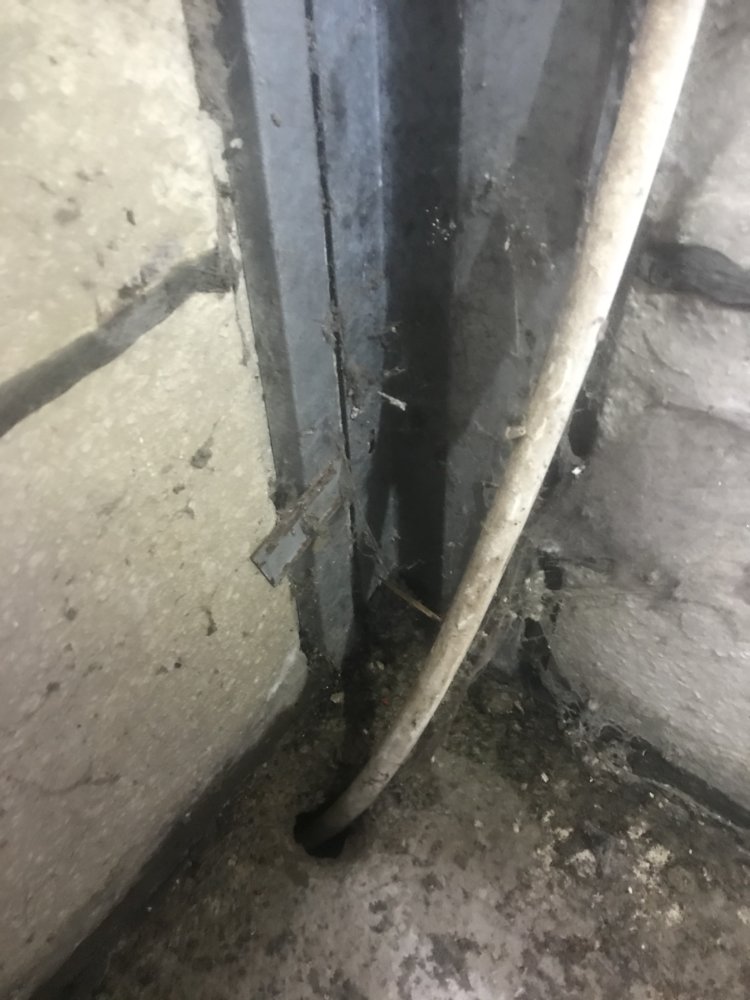

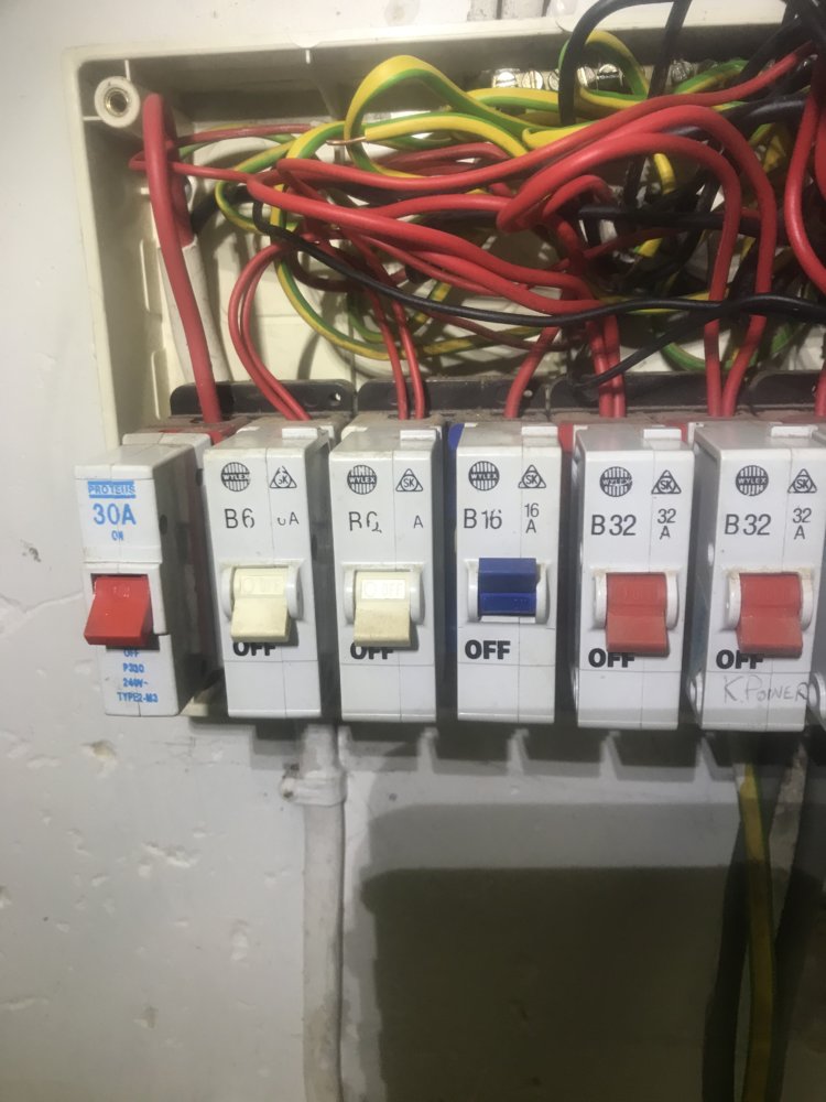

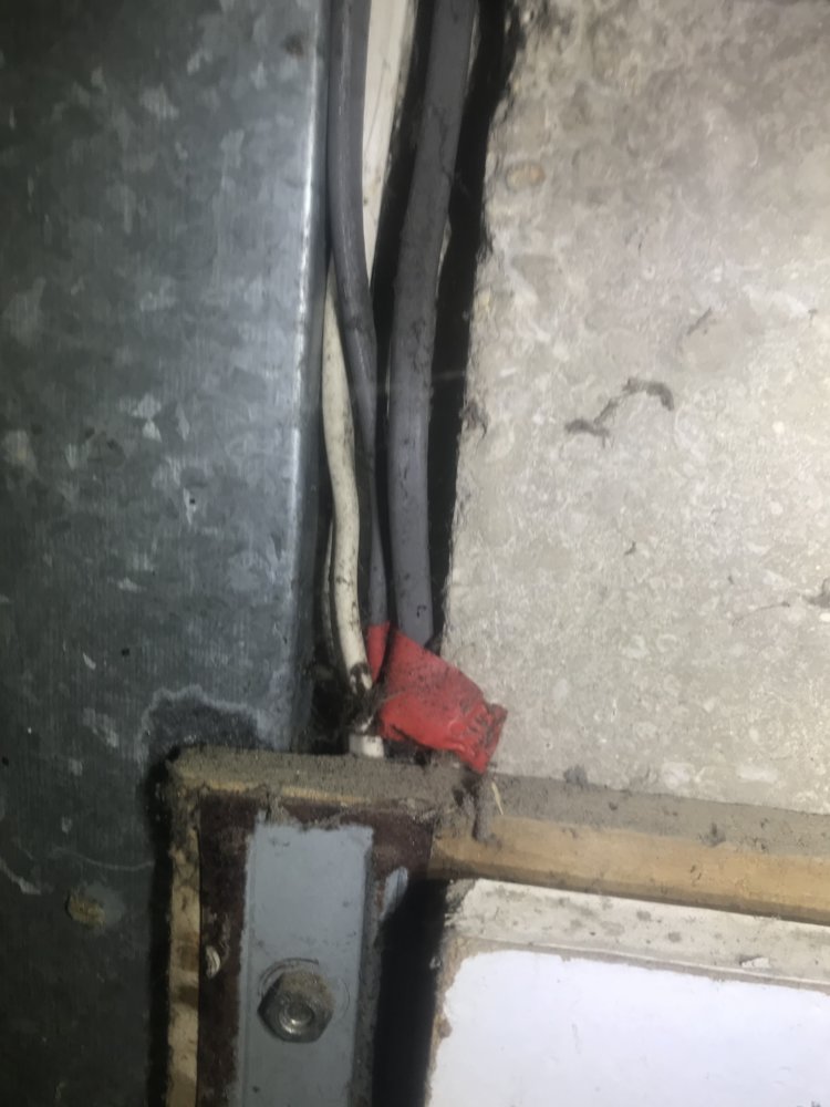

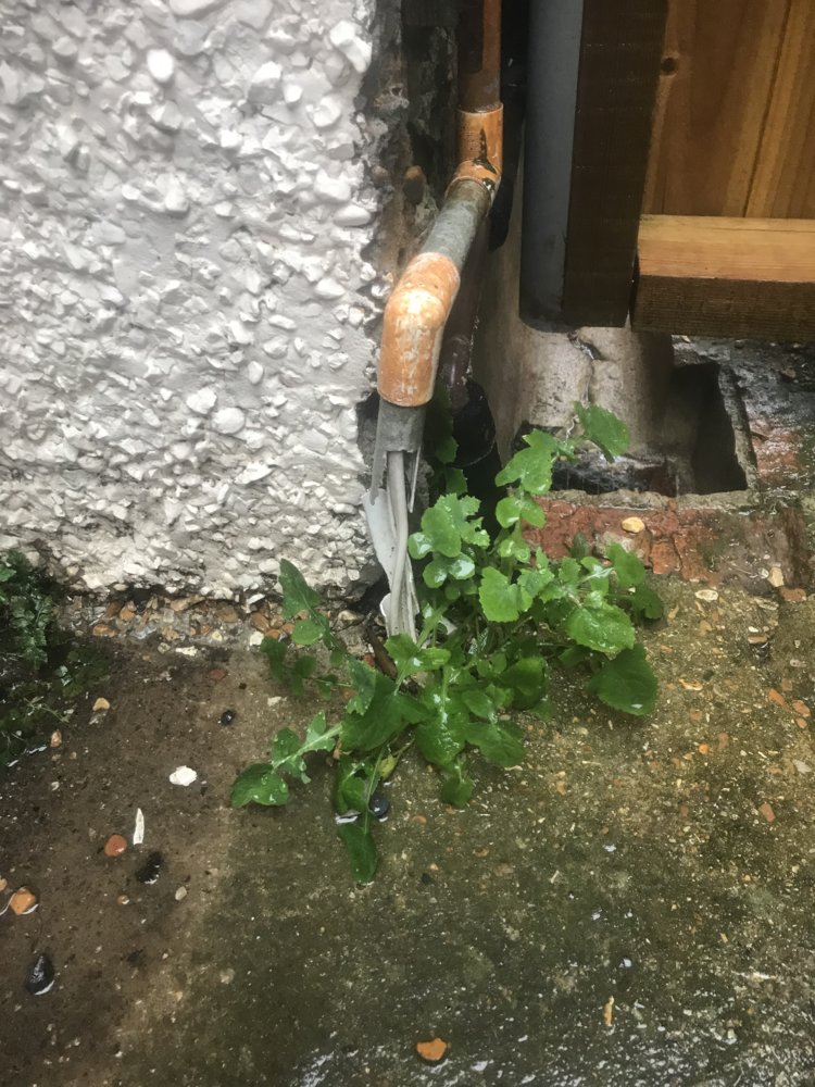

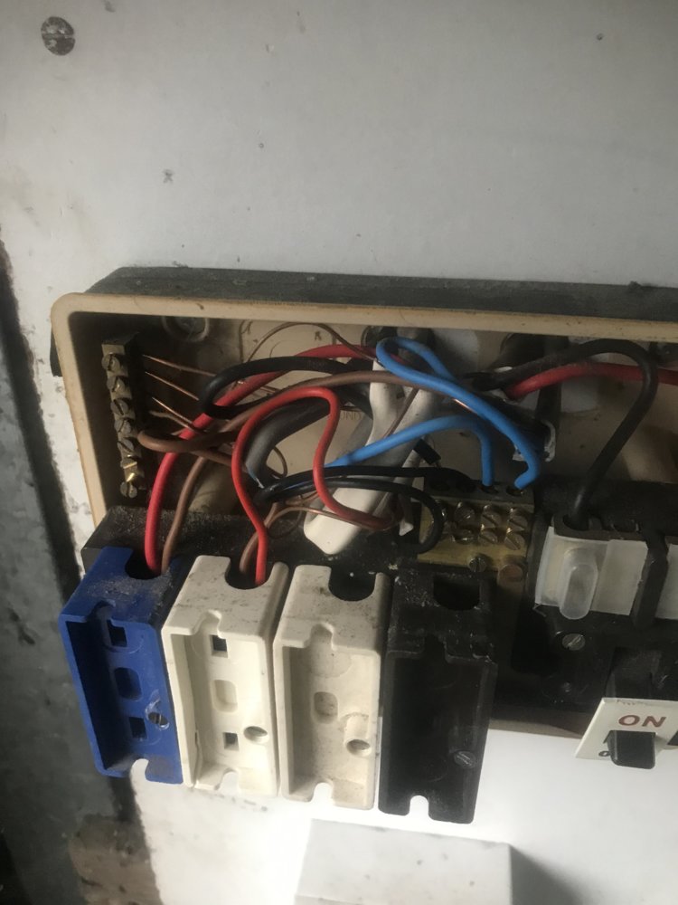

EICR on an empty property this morning, potential buyer has instructed, few bad points but overall not to bad, and then this.....16a wylex plug in mcb-2.5 t&e- 32a 10ma Crabtree rccb then runs 8 metres in conduit (broken in places) then goes underground for another 20 metres to feed a db in a metal framed garage with concrete floor with no bonding.....oh and there’s no continuity on the cpc ?
EICR on an empty property this morning, potential buyer has instructed, few bad points but overall not to bad, and then this.....16a wylex plug in mcb-2.5 t&e- 32a 10ma Crabtree rccb then runs 8 metres in conduit (broken in places) then goes underground for another 20 metres to feed a db in a metal framed garage with concrete floor with no bonding.....oh and there’s no continuity on the cpc ?View attachment 56027View attachment 56028View attachment 56029View attachment 56030View attachment 56031View attachment 56032View attachment 56033View attachment 56034
That "conduit" looks like PVC Water pipe to me!
Couldn’t do it I didn’t have my long lead with me...customer told me yesterday 4 circuits and no out door power!
