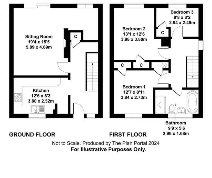

Just gauging the collective intelligence here on perils and pitfalls of renovating a possible house my middle daughter (19yp) wants to buy with her own money. She pays the bills, daddy does all the donkey work.
The market around here is slow at this time, so there’s not a huge choice of properties in driving distance to both our house, and her place of work.
I’ll show you all what we viewed last Friday… and possible plans.

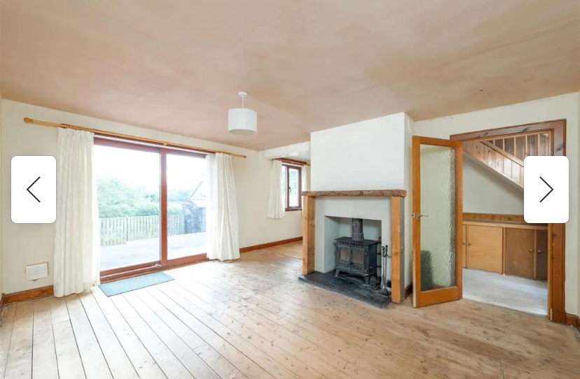

Property is 50 to 60 year old ex-local authority stock. 3 bedroom. Semi detached with cavity walls. Garden of grass to front, hoping to put in a driveway, and all slabbed to back and side areas.
South facing living room. Solid fuel burner that feeds some wet radiators. No mains gas on this street. Other heating is a few night storage heaters and immersion tank. Not sure if it’s one or two immersions… but must heat overnight and has a boost control.
Ceiling appears to have been newly plastered, but that might just be to cover old cracks or whatever.. there’s no evidence of flooding above.
Strange small room past the left of the fireplace. Not really big enough to do anything with.
Was originally a storage room with solid wall here, and access door to outside.
Kitchen needs redone. There’s no door for a start. A lot of the drawers don’t shut and there’s no wall units. There’s a serving hatch into the living room.

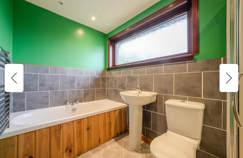

Bathroom is pretty good… but no extractor fan. There’s a separate shower cubicle to the right of the picture, where space has been taken from a bedroom to fit it in.
Hallway. Big wasted space under the stairs there. Space for a WC?
The cupboard at the end holds the consumer unit, which is a dual rcd Hager board for 24hr, and an older fuse board for the storage heaters via a mechanical timeclock.
There’s ample space under the timber floor for running new pipes and whatever. Will want to insulate under there as well, but don’t know if it’s best with spray foam, polystyrene blocks of just rock wool held up between the joists.
Another plan would be to take that end wall of the hall away, moving the CU, cutout etc and putting the kitchen under the stairs, and into that small area. Open plan into the living room.
Current kitchen could be split into a WC and utility room.
In summary. Lots to do, many ideas. Wife doesn’t like all that plain wood.
Is rooftop PV doable? Or does one still need to be MCS registered to get any payback?
Get PV, get battery storage.
Daughter might be eligible for green home grants from Scot.gov
What’s your ideas?

Looks really nice for a first home at 19. Solid fuel is a nice touch, you could use A/C for upstairs and kitchen/lounge , much better than storage heaters (yuk)
If the gnd floor is coming up and and its wooden joists, you could staple net to the underside of the joists and drop rock wool in, will make a big difference.
My first thought is to fit a thermal store in place of the hot water cylinder - as large as you have room for. Feed the wood burner into it, and run the heating from it. You can still have multiple immersion heaters.
It means you can use the WBS to provide both heating and hot water - and use the immersion heater(s) to top up as required.
If doing all that, wet UFH is worth considering.

That's a nice house and ripe for many projects, but it's easy to get carried away trying to make everything perfect from the start. I'd recommend that your lass lives in it for 6 months before making any major changes.
The only specific point I would change is turning that bath throgh 180 degrees so the taps are in the room, not against the wall...don't ask me how I know!
I must be getting slow.
I'm thinking.... whats he talking about? 180 degrees?... the taps are still on a long side... He means 90 degrees.... have the taps at one end.... Not much of a sailor if he cant get angles......
Then the penny dropped.
Yes... a leaking pipe will be a PITA to fix behind there.
