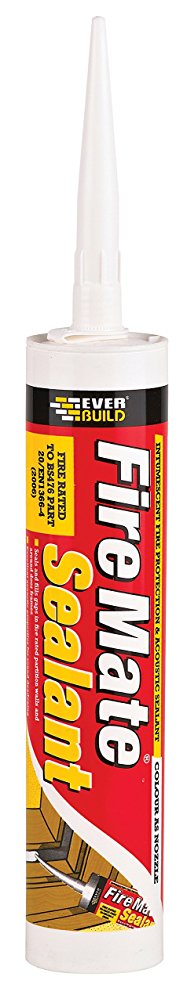

if there is open grommets ,seal them with fire sealant ,
Grommets - WISKA - make power smile Cable entries - https://www.wiska.co.uk/Products/cat/291/Membrane-cable-entries-plastic/
