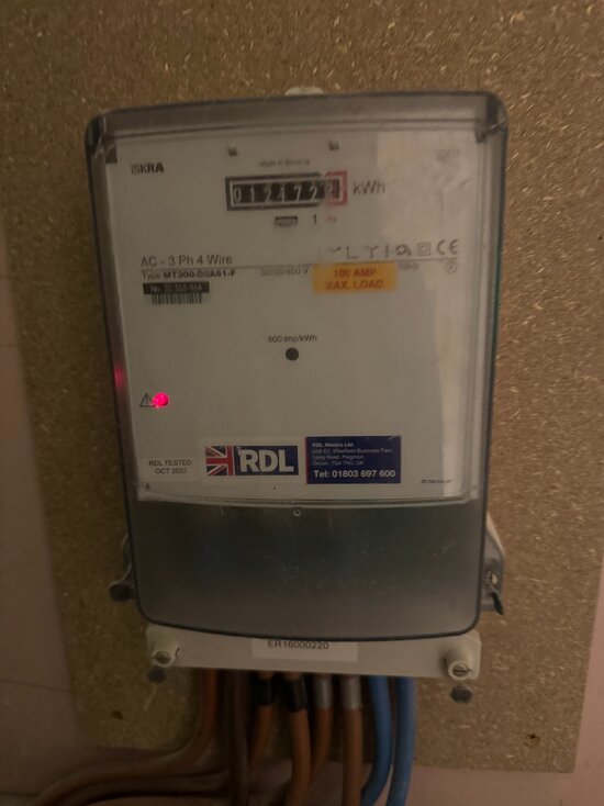

Hello all. I leased a 2500 sq ft commercial building about 4 years ago that required substantial upgrades. It was previously divided into three different businesses, each with its own meter. The building was completely renovated, and 10 air conditioning units were installed. Prior to this installation I was signed up with EDF.
The build did not go well, and that builder left around 3/4 of the way through the project, owing me work, but that's a different story. I have since completed the build with a different person.
I have been corresponding with EDF, trying to get them to come out and inspect the meter because the one on the property does not appear to be associated with EDF, as it is not labelled. I believe it was installed by the original builder. I can't ask him because he's returned to Bulgaria and is now ignoring my messages.
It seems to be functioning correctly; of course, I have no way of knowing for sure. I have tried explaining all this to EDF, booked site visits that were then cancelled by them. Nobody I speak to at EDF has any advice; they keep telling me to go back to the electrician of the original builder. There were several issues with the original electrician, including missing light switches, failure to connect smoke alarms, and leaving exposed live wires. However, these have all been addressed except for the 3-phase meter issue.
I tried another supplier to see if they could fit their own, but EDF disputed the account, so I couldn't move.
EDF has been sending estimated bills, which I have been paying, and more recently, they sent one apparently verified by a data collection reader, which is not true, as I would have been thrilled if someone had actually attended the property. The reading they provided makes no sense.
I feel like I am stuck in a horrendous loop where I am not getting anywhere and seem to spend most of my life on hold, or getting cut off by EDF. I am happy to pay my bills, this isn't some payment dodge, I just want it sorted out.

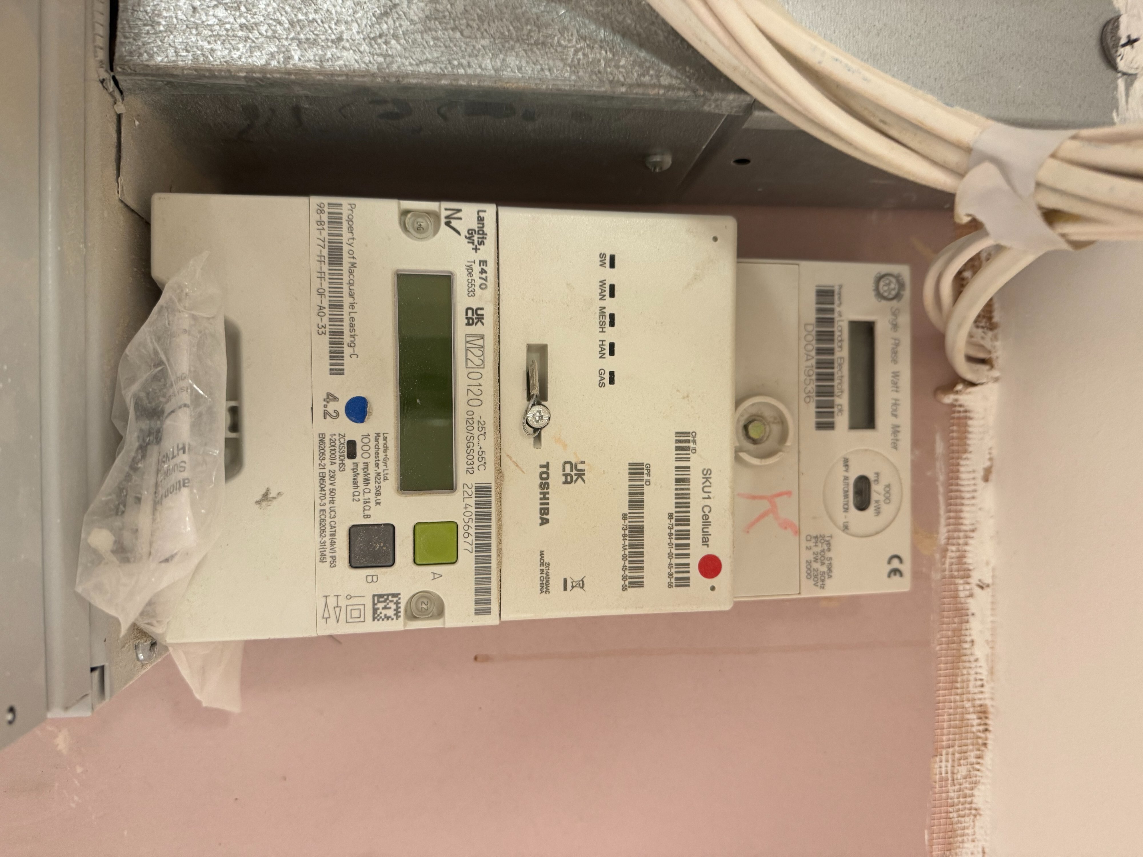

No actually the original meters are still there, neatly stacked on the top of this one. Yes I have called them a bunch of times, opened a complaint etc but even with the complaint nothing seems to be happening.

The original 3 meters are still there, yes. I am being billed for 1 meter, which I agree is odd, but when I spoke to EDF, they said two of them had been decommissioned.

There are 3 of the original meters left on top of this new one, but not connected. My guess is that the previous builders changed them for this new 3 phase meter, but I wasn't on site for most of the work so I don't know when this was done. I only noticed when I came to read the meter as up until then I assumed we had a smart meter.
Gosh, can you take more photos of the 3 phase service head and the old meters, if that is the new meter, it is either a re-furbished one bought and installed by the builder or EDF have run out of meter stock and are supplying via RDL..... It certainly surprised me. I dont suppose there is any sign of any new labeling and or an MPAN number.

There 100% isn't another meter here; this was originally the space occupied by the 3 meters, which I then consolidated into one (not a 3-phase). This meter is still on the premises, although it has been removed.
Just in case I have looked everywhere, both inside and outside the property today and can't find anything.

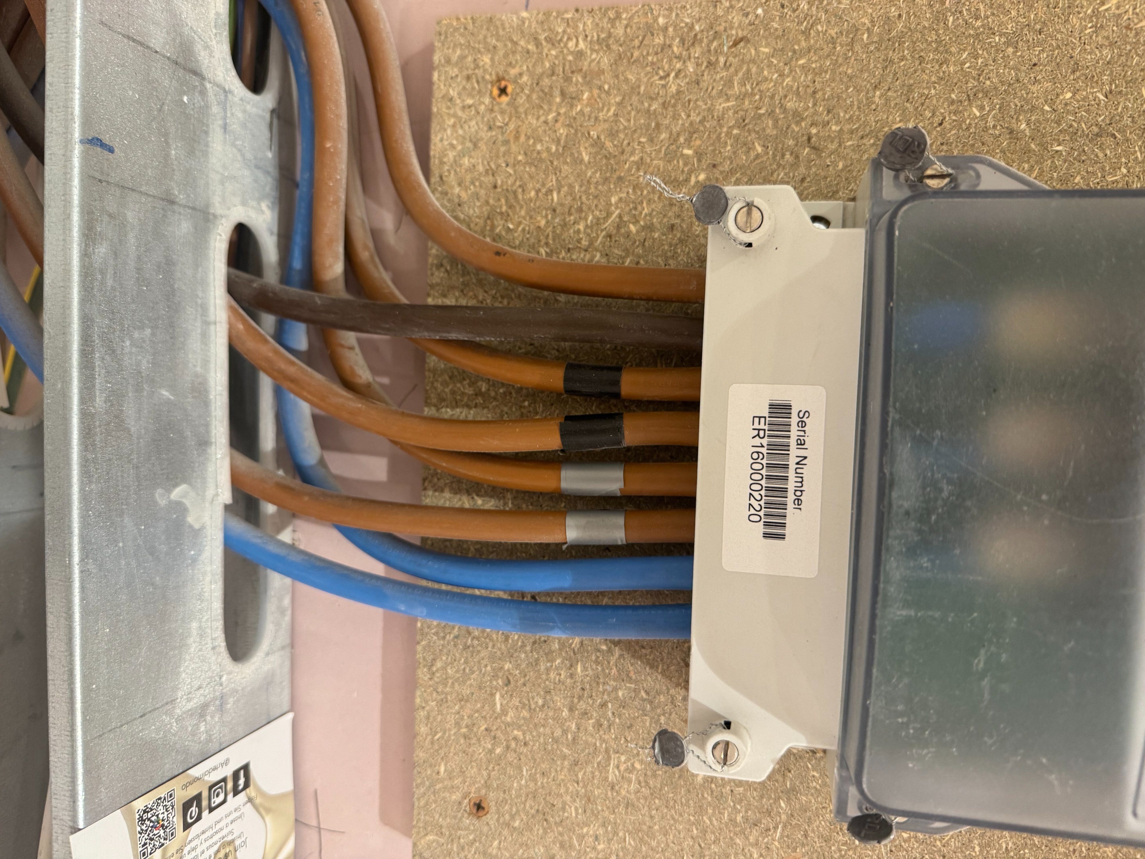

I have attached pictures here, I hope they are sufficient or do I need to step back a little bit?

Have you a picture of the incoming cable /main fuses.
Has this always been a 3 phase supply ? With each phase supplying a single phase meter ?
As above we need to see where the cable enters the property from the grid and where it first terminates, then follow it as the meter should be close by.
I can somewhat understand why EDF are struggling.
So EDF are still billing, if you look at those bills it will give the MPAN No which is a unique number supplied by National Grid or whoever is you electricity operator in your area.
If you have had a new 3 phase supply and it is live, there must be a new MPAN. Have you tried your local grid company to see if they have issued a new MPAN?
