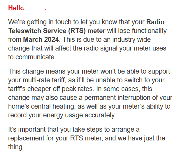

In England the Radio signal that's used for switching Off peak meters (RTS) is going to be turned off in March 2024, it was originally to be March 2023.
I'm wondering if the radio signal is already off in your area, hence why the meter was disconnected and someone has moved the tails to standard tariff .
Or may be the same as me where I changed to a single tariff as I wasn't using enough on the Off peak to justify the increased Standard rate tariff.
The difference is though at the moment my RTS meter still works but I submit both readings which the supplier charges at the same Standard tarriff.
It hasn't stopped them emailing me regularly informing me I must change to a "Smart" meter before the RTS is turned off, otherwise my off peak may not work.
