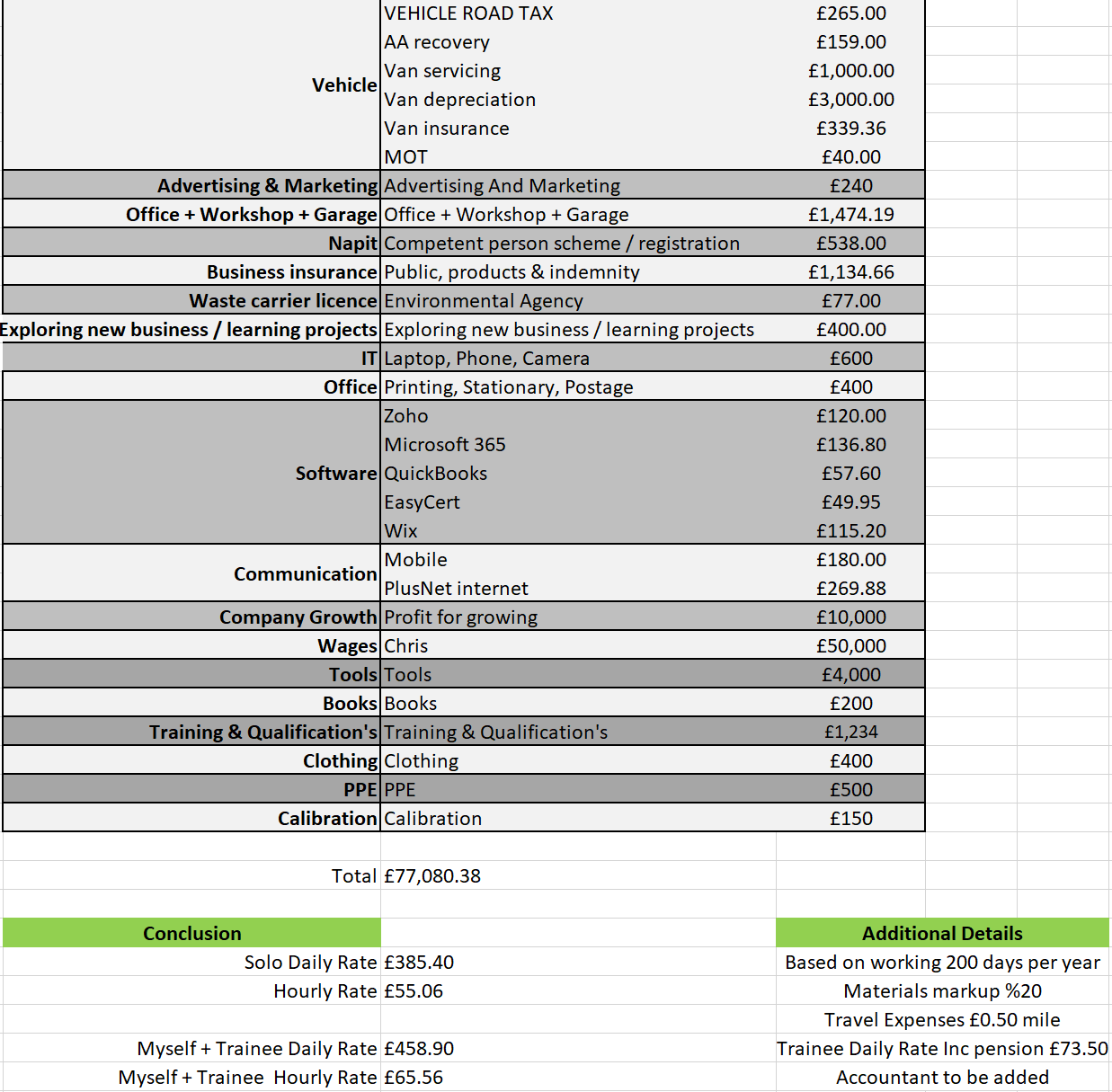

I also need to decide what I would like to be paid, the past 3-4 years every penny has gone back into the company, at least now the outgoings are leveling off.
Exactly dustydazler, I'm sure costs soon add up, Van's, tools , holiday pay, sick pay, pension contributions. A load of cost you could have .
Just watched the YouTube vid from Artisan electrician - along the lines of the advice on this thread. Useful stuff.
He also points out what I'm struggling with, which is knowing what you can charge. Would be useful to know what other experienced solar contractors are charging to work on commercial solar installations / farms? Send me a PM if you don't want it public
Worked out my operational costs attached
Calculations based on 7h per day, 200 days per year with £50'000 salary (which includes sick days, pension + holiday).
Rates calculated:
£385 day rate for solo work
£458 day rate with trainee
Travel @ £0.50 mile
Materials markup %20
Seems a little cheap but it's a good starting point.
