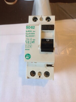

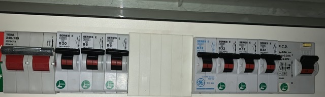

The RCD that protects half of our split steeple board is showing signs of overheating. The connection was loose and i've tightened it.
ive contacted Denmans (who i believe bought steeple) asking for a replacement rcd. they've said that they don't make the series e anymore but they have rcds that will fit.
im just wondering if it's notifiable to change it? if it isn't, I was just going to replace it and do the rcd testing myself.
Thank you for reading,
not notifiable, it's an repair for a faulty? item. really a like for like replacement. test and MWC.
Hi,
thanks for the replies. It’s only £20 and there’s a denmans in town so we can pick it off the counter. She hasn’t given a part number but I’m guessing it’s compatible if they say it is.
Lucky we caught it really as it could have been nasty.

Hi,
The one I have looks like a newer version, so possibly the same as what denmens stock.
