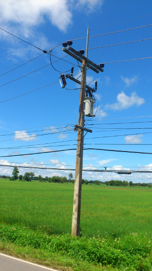

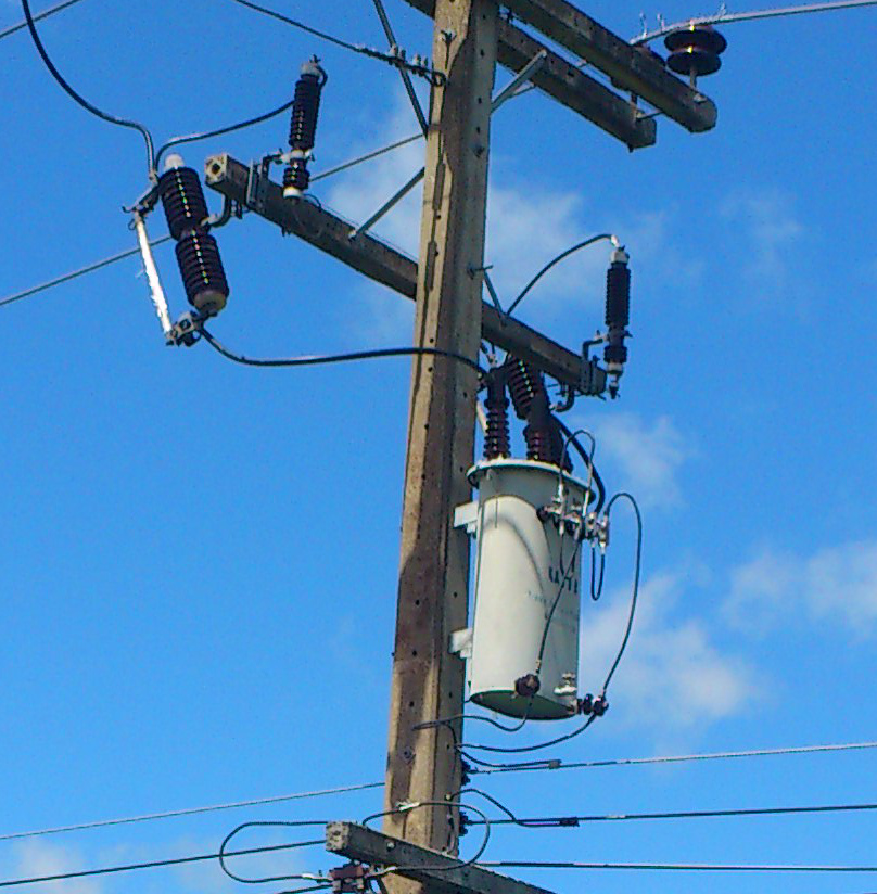

Ok here's a few pictures of my mates transformer that supplies his property, his property is in northern Thailand.
I know the pictures are not great but the tranny doesn't look like it has an earth.
If it has no earth what would members suggest doing to make it safer?

I can't see how the neutral can't be earthed at the TX, otherwise the neutral point will be all over the place unreferenced!!
I can't blow up the photo's so i can't see too much, but on a lot of these cast concrete poles they use the reinforcing steel bars as the down conductor which are then connected to a rod at it's base.... As i say i can't make out at the moment, exactly what or how the LV connections come out of this TX.... lol!!

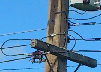

Here's a few more cropped images of the TX, it does look like at least one cable has been anchored to the pole by means of a bolt.
Maybe this is evidence of the steel within the pole being used as an earth.
I like the tap at the bottom of the TX, I've never seen one of those before.
Looks like that's the mystery solved. I'll admit, I'd never have thought of using the poles reenforcing as an Ufer earth.

Usually used just as the down conductor, then a rod or whatever taken off that down conductor. In this case that may be a galvanised plate that runs down to ground level shown in the photo's, so the rod would be taken of of that plate probably underground where it can't be readily seen... Can't really see too clearly, if that is a plate sitting in a recess on the pole, in some photo's it does indeed look as if it is...
