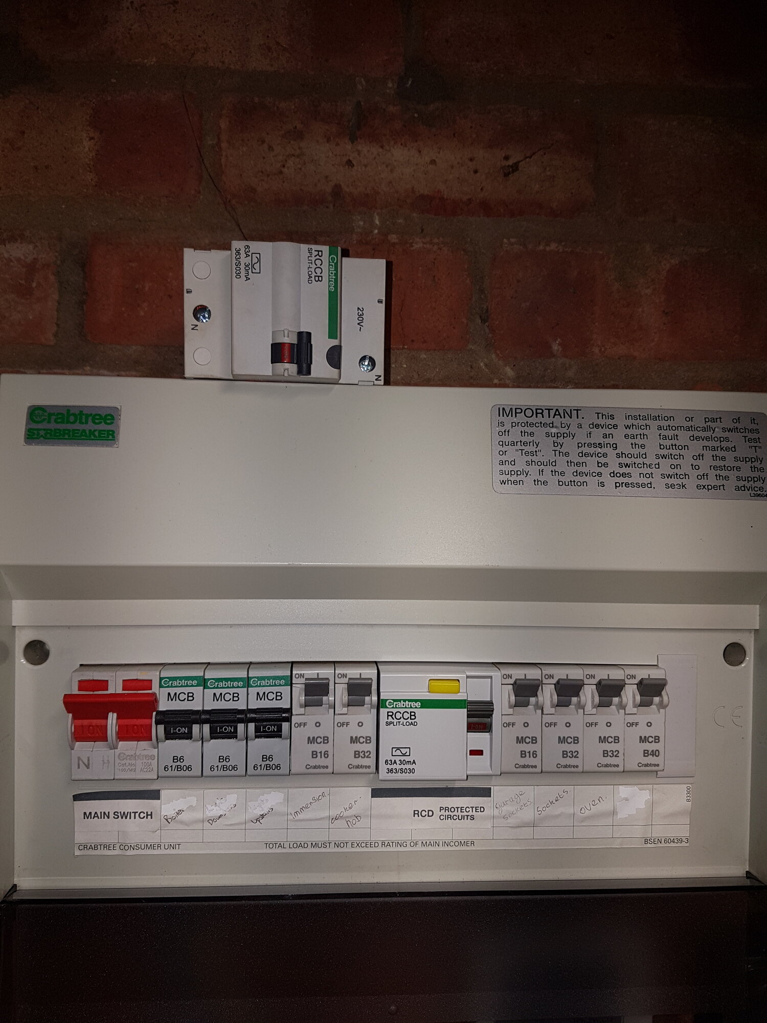

We had some old rcd testers in the office so I bought them home to see if they still function. Tester 1 no trip, tester 2 no trip go to my consumer unit and hit the test button no trip, shock horror how long
has it been like that. Today I performed surgery and fitted a new device and it lives on.
We had some old rcd testers in the office so I bought them home to see if they still function. Tester 1 no trip, tester 2 no trip go to my consumer unit and hit the test button no trip, shock horror how long View attachment 102333has it been like that. Today I performed surgery and fitted a new device and it lives on.

i reckon there must be 100s if not 1000s of RCDs out there that would fail to trip
Without a doubt. Strangely it randomly tripped back in the summer, switched it back on never tripped again maybe that was its dying breath.
That is the big problem, it seized up and died in the ON position meaning it would never trip under a genuine fault in the future

Can't get a Type A to fit but I'm not losing sleep over that😁
Found a couple of wholesalers with new stock £51 with p&p bargain.
Same fitment as current starbreaker, surely?
First link I saw was screwfix. Oddly enough you can buy one from them in a board, for less than they sell them individually.

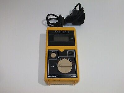

Megger CBT3 I still use one daily.
Still got a CBT2 kicking around somewhere. Still worked last time I tried it. I think the CBT3 was the first to have a plug on the test lead so you could use probes on these new-fangled RCBO things....
Love these old style hand-held testers
