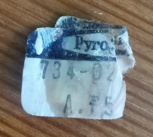

i measured the diameter of the conductors inside and they measured 1.7mm, which seems nearer 2.5mm than the nearest imperial equivalent. It's got a 32a mcb on the circuit (probably not the original one) and I'm fairly confident it was designed as a ring circuit. Built around 1973 so could be imperial - not 100% sure, but leaning towards 2.5mm

1.8mm diameter is 2.5. If you have the pot there is normally writing stamped on it even the imperial ones.
