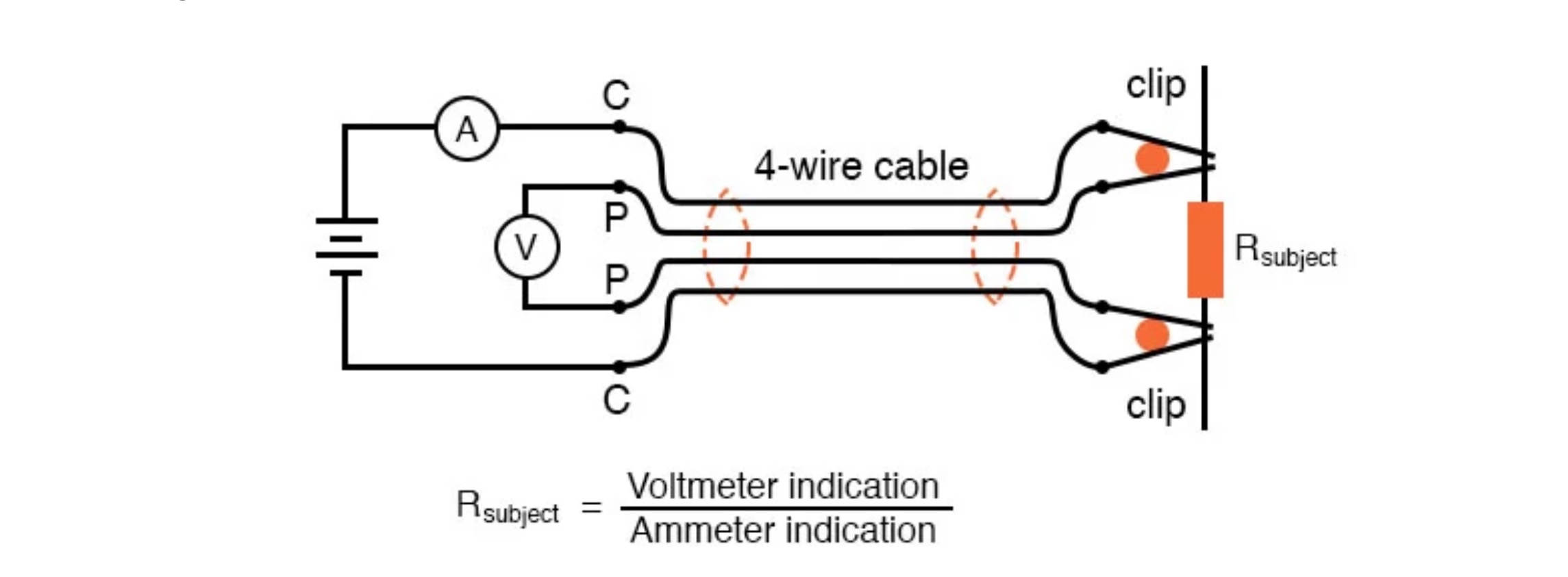

If you are measuring directly across the terminals of the protective device, there's something up with the measurement technique or the measuring instrument. You have presumably nulled out the leads and got proper contact with the terminals?
One might typically use a 4-wire technique for doing this sort of measurement, the principle of which illustrated below:
