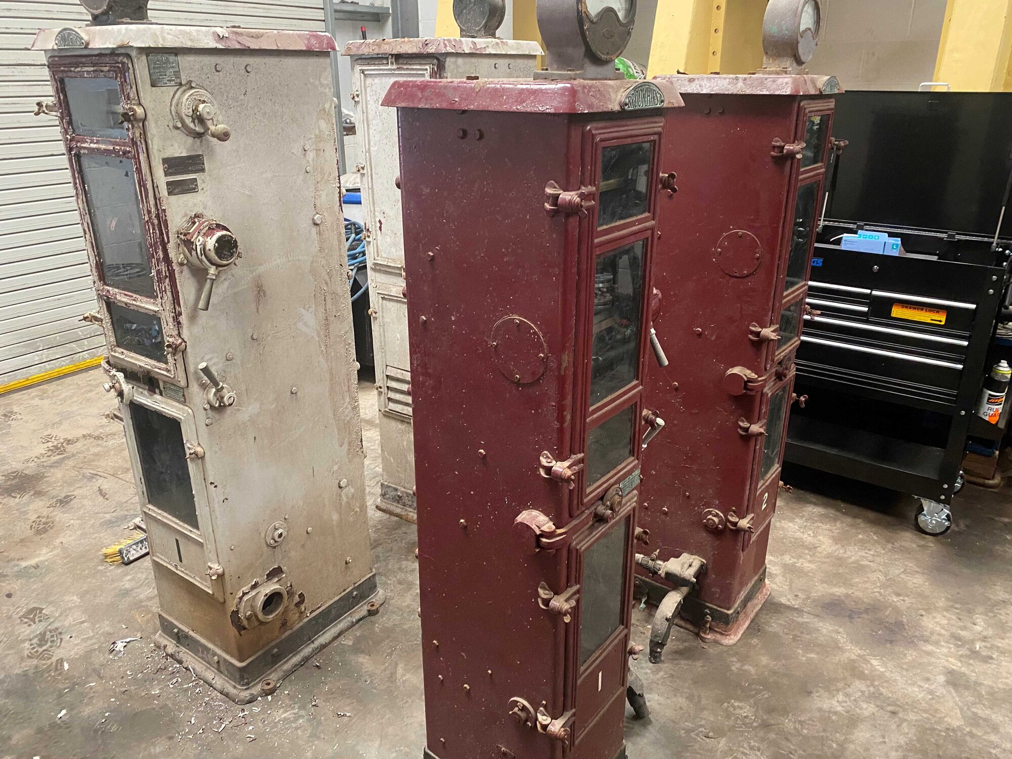

We are in the process of restoring 4 of a group of 5 Brookhirst DC motor starters from 1936.
These are a thing of beauty and the engineering in terms of interlocking and ratchet control is incredible.
These are all from the same pumping station that controlled well pumps and booster pumps.
There must have been thousands of these made and installed in industry here in the uk and around the world.
I personally have not seen any in service other then these, and even in museums they seem quite rare after such a large production run.
The feeder cables to these starters are also original 1936 vintage.

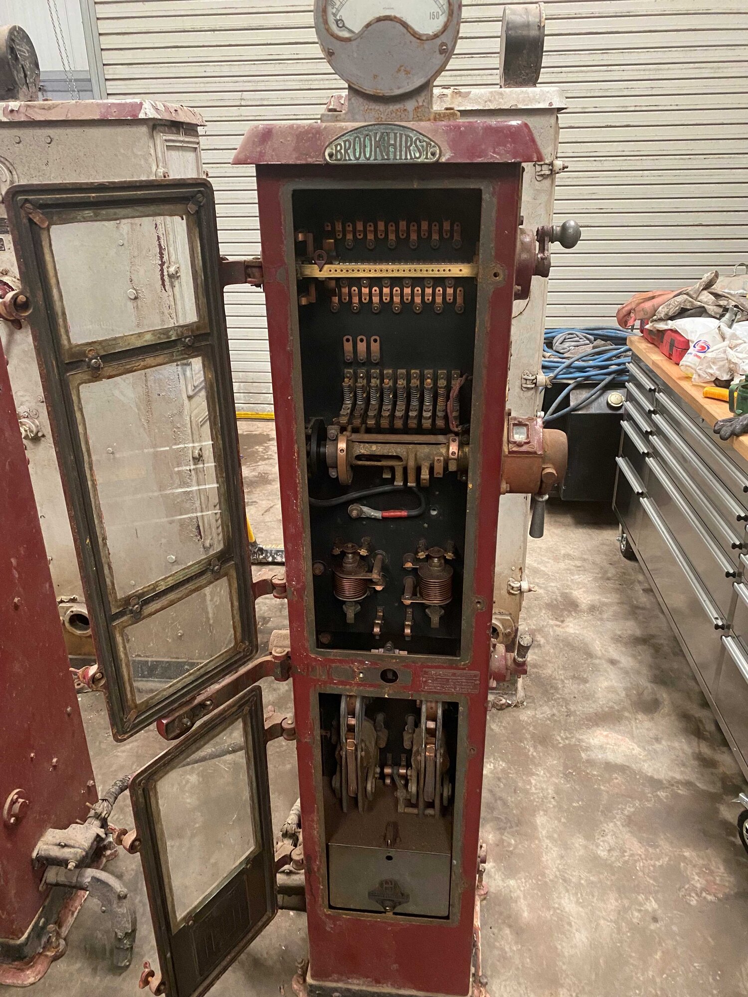

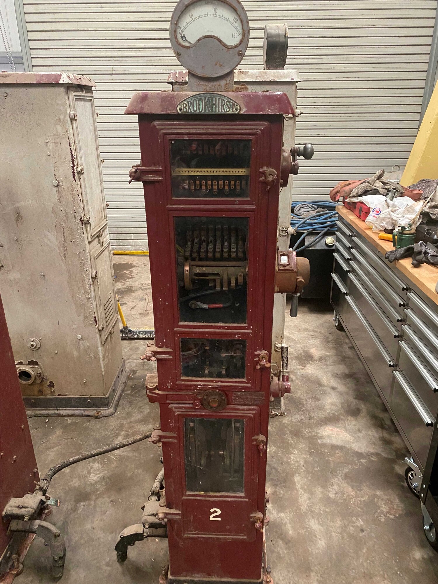

Very basic description from the top when you look inside........

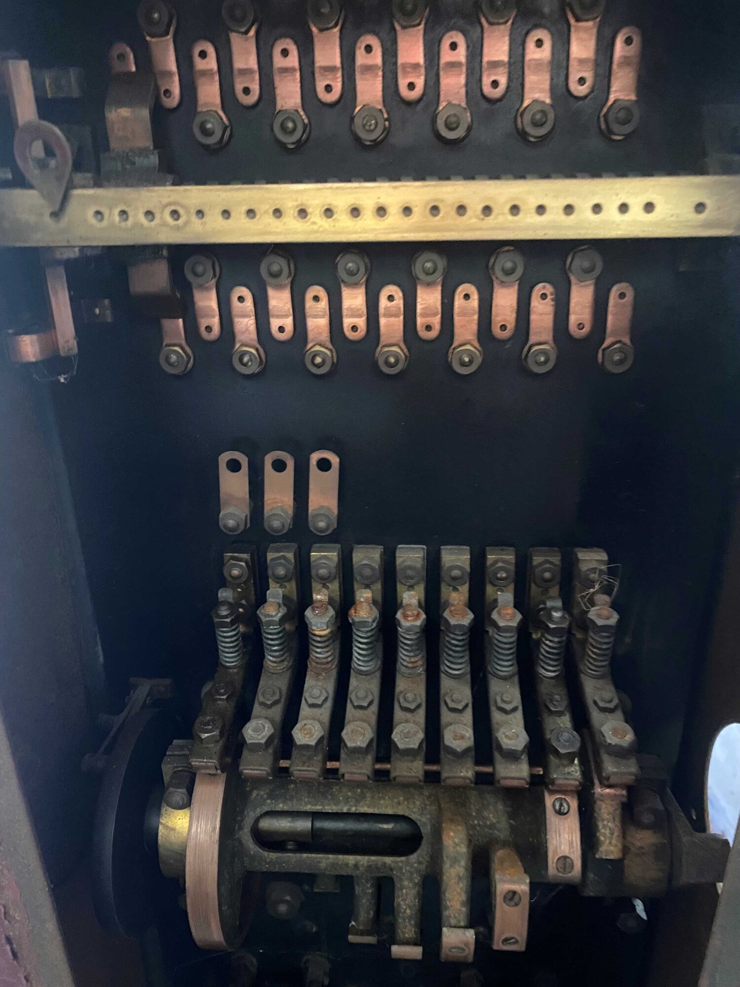

Speed control variable resistance with external hand wheel operation.
Motor starting resistances which ratchet type external control lever
Motor overload trip coils
Main incoming contacts
Very bottom behind cover, main isolator.
