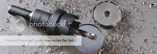

I've got a bit off drilling to do in 3mm sheet metal at 20mm to fit conduit bushes. At the moment I'm using a 20mm hole cutter and its not doing a bad job of it but I'm sure theres something out there to do it better but without spending a fortune. Options are:-
Stick with the hole cutter £8
Go with a step down drill bit £19
Or a blacksmith drill bit £5
It's more than less drilling a hole in a metal c/u, what do/have you used and what lasts, makes a good hole (oh matron) and is cost effective?

Use cutting compound mate, and it will prolong the life of your holesaw. I also predrill the pilot holes.

For 3mm, assume its ali? I would drill to 13 with standard bit, then finish with step cutterto 20mm.
Forget a blacksmiths drill, it will snatch like the clappers with a hand held drill.

these are pretty damn good.
same as this [QUOTE/]
Oh pennywise that looks like the tool to do the job, just bought one online and they have a distributor near me, happy chappy for ten quid plus vat. I owe you a pint (if its any good)
