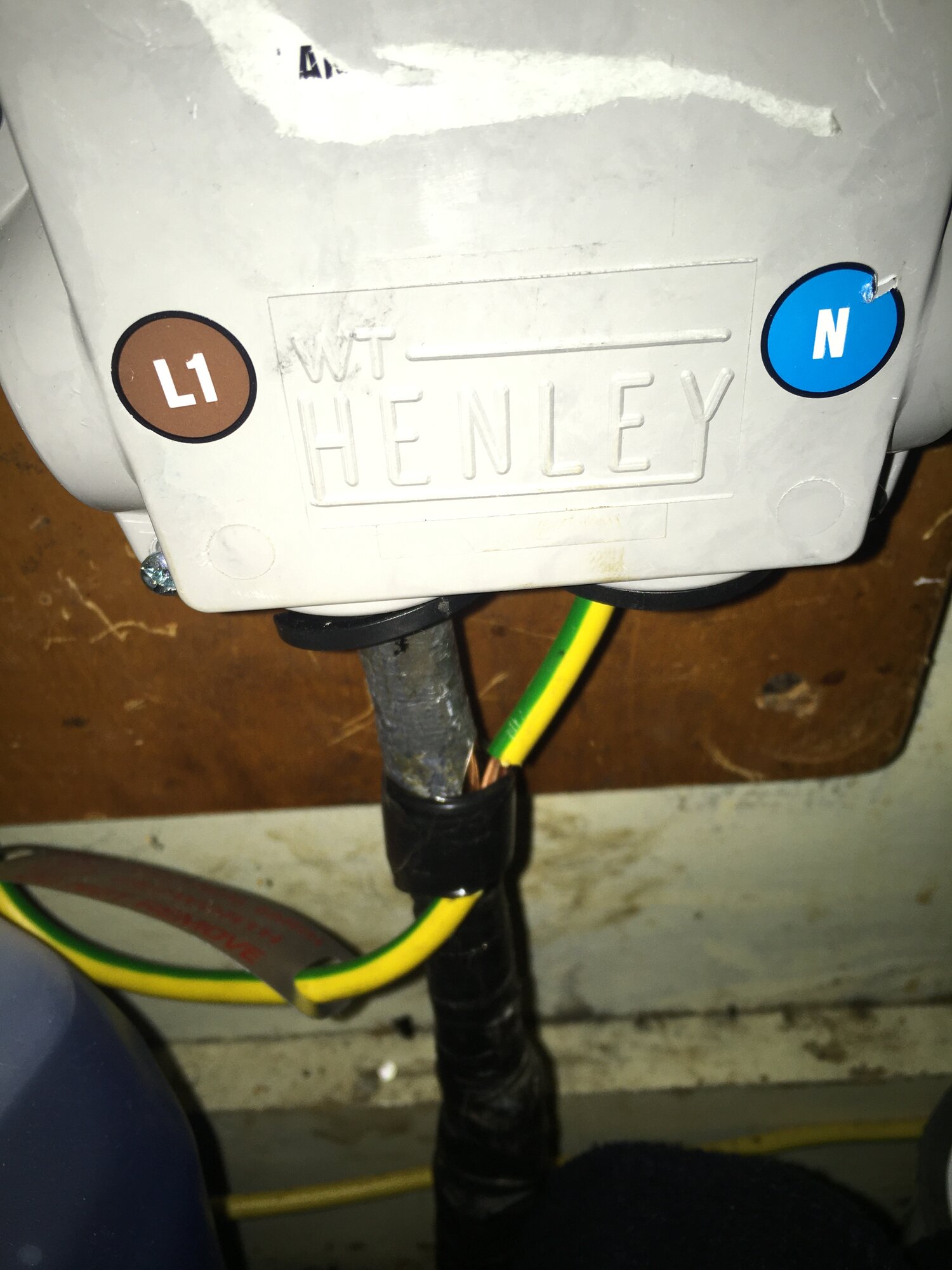

What kind of earthing system do you think this is? Strikes me as TNS (Paper lead incommer) but the earth coming out of the head makes it look like TNCS??? But then again the earth is on the lead sheath too???
I was only there to have a look today so didn’t do a Ze. Strikes me as an odd way to go about things to say the least
If the earth comes out of the head it is 99% certainly TN-C-S. It is common to link the sheath in to the CNE although the connection method here looks rough. Presumably there is a constant force spring under the tape but just boshing the cable through diagonally isn't my idea of a proper job.
Unless you have a private transformer, it is extremely likely that your TNS will have become TNCS during routine DNO works as they'll joint CNE cable onto existing SNE and this make it a TNCS (PME is thry put a rod down but otherwise its a bodge)
This is true, however in this case whatever configuration exists further up the service cable is immaterial as the main earthing conductor goes into the neutral side of the head.
