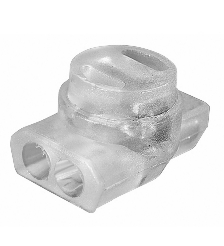

You need to get some gel crimps and get rid of that bloody choc block as that won't help...

The good old 'nibbie' - BT term. You'll find all the discarded ones by the BT cabinets because no one ever tidies after themselves anymore!
CPC do have them, RS will carry them too.
