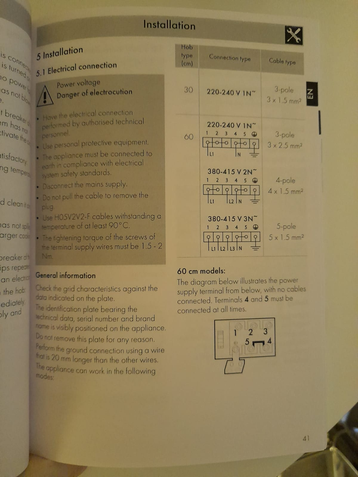

NEFF T36FB41X0G
BOSCH PUE611BF1B
SIEMENS EU631BEF1B
All four ring 13A induction hobs.
Bosch, Neff and Siemens are different brands of the same company, so I would expect to find those three hobs to be internally the same core product.
My Smeg can be single or three phase.
This 3,700 watt hob on a 13A plug, I am certain was a power adjustable version, with the makers not going by diversity. An assumption by me - the UK version with a plug would be factory set to 13A max.
