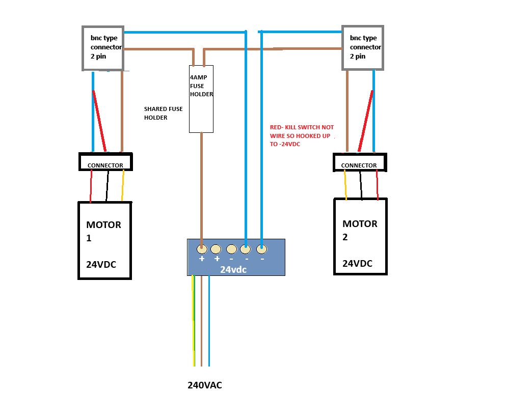

As the title suggests; I have a fuse that is blowing on a 24VDC circuit.
I was worried I had damaged the servo motors as they cost a bomb.
the motors, I connect and disconnect at the BNC point on the diagram.
I plugged them in and it was blowing fuses. I tried 1a 2a 4a (4 amp is ample).
I thought it was a motor that was blown and causing a surge. I then swapped them over left and right and they both work.
I then realised I had plugged them the wrong way around but there should not be a wrong way around.
I just dont get it. Is it something to do with the negative rail on the 24VDC transformer? That I have wired the neutrals seperate.

I can't immediately see anything wrong, but you haven't mentioned the characteristics of the motors.
I'm curious about the use of BNC connectors for the power - are you using 2-pin ones with the current going through the pins, or just coaxial ones with current passing through the body?
Are your BNC's rated for several amps, as I was under the impression that 1 or 2 amps is normally their max current?
You could put a separate fuse in each motor supply, which might narrow down the problem if it happens again!
Finally how did you arrive at the conclusion that a 4A fuse is ample? You've got a beefy supply capable of delivering twice that - do you know what a motor takes off and on load?

James; The connectors are indeed the 2 pin and I have wired the kill switch wire to the -24VDC .
Perhaps I wired one of them to -24VDC and the other to +24VDC on the second connector.
Not sure why it would mean it would work a certain way.
The GX12-2PIN are rated for 5 amps.
Wiring is 1.5mm2 so thats okay.
Each motor probably draws 1 to 1.5A if that.

If your fuse blowing persists, there surely must be something up with the wiring. You haven't got one set of connectors (both plug and socket) wired the opposite way round to the other? 🤪
You say 'a fuse' is blowing. What type of fuse, and is it the right one?
Fuses come in fast blow, semi slow blow, slow blow, motor type and probably a few others.
As above first course of action taken is two separate the two motors with two separate fuse holders.
I might even put a 1A in each as I don't want to damage the actuator motors.
Does it make a difference whether to combine the neutrals on the PULSE transformer or keep them on separate rails.
I have checked all wiring and seems identical on both sides.
These fuses are motor fuses which seemed to work in past; rated for motors ; AM fuses ; motor protection
They are not 'neutrals', just the -ve connection to the Pulse power supply.
I had a look at the schematic of the PSU and the row of three -ve terminals are all connected together as you might imagine, (same for the two +ve), they are just additional connections. It makes no difference which blue wire goes to which -ve terminal, you get the same connectivity.
If everything is still working, you've checked that you have wired it as per the diagram, then I strongly suspect it's a matter of selecting the correct fuse to deal with the motor starting current.

Is there more than one kill switch?
Why is it wired into the -ve 24V (If you insist on the kill switch being on the LV side why not the +ve 24V)
Why not wire the kill switch into the mains side*? Wired into the LV side it leaves the 24V Supply energised when operated.
(*Depending on how quickly the supply dies when mains is disconnected, I expect it will be almost instant.)
Have you used 2 core cable to the plugs, and is the metal outer of the plugs connected to anything?
Are you saying you've used one plug for the + side and the other for - side, I didn't understand what you meant. If each plug has a + and a - the polarity should be consistent with the plug physicality - that is the same on both, that way if someone swaps plugs it will make no difference.
And as said why not 2 fuses, 1 for each servo, there is no discrimination the way you've wired it.
HV colours for LV AC? What's wrong with Black for - and Red for +?
