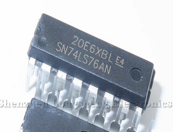

I believe I made a mistake.
I believe I also bought a Negative Edge Triggered IC. Aaaaah. And now I see it.
SN74LS76AN
When they say 'LS76A I believe they refer to this sector SN74LS76AN from the name. Correct?
Im so screwed.
Item numbers for a device really do matter - a good learning point for you. Generally the later numbers and letters of an item number refer to derivative, options or performance for the main device.
