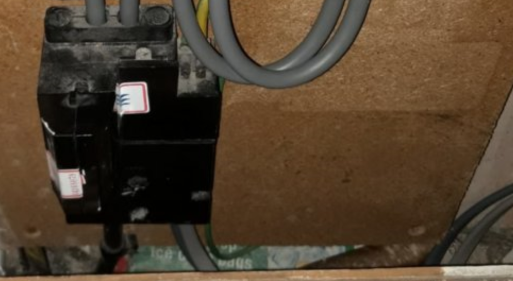

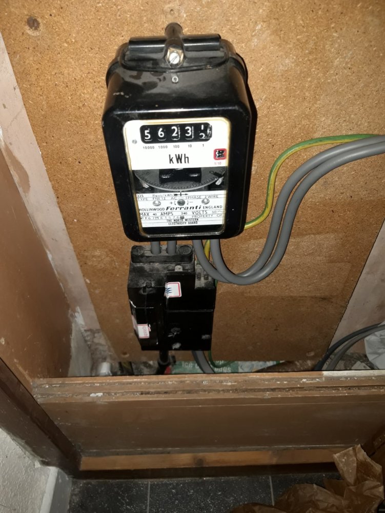

What’s the issue? Obvious the fuse is unsealed and has been pulled. Put back in opposite way according to the sticker.
nothing else obvious

That's initially what i though, look closer at the bottom right hand side of the cut out.
[automerge]1579437213[/automerge]
Is that a T&E coming out the bottom of the cut-out?
Two, i think.
Is that a bit of 2.5 twin and earth dabbed into the bottom of the cut-out fuse ?
I have seen 2.5 straight off a meter before to supply a self build extension to supply a new diy consumers unit , but never connected straight to a cut-out...
Never be noticed by the average meter reader. Only the eagle eyes of a professional would pick it up.
What’s it feeding, and are you getting involved reporting it?

My Missus, is local plod, has busted a small weed farm this morning and askd why, when the CU mains switch was off, was the farm lights and extract still on.
Abstraction my dear Watson, abstraction.

DNO's will produce some nice little graphs on electricity consumption on those jobs. Very helpful in providing an evidential picture on how long the meter has been bypassed, loss of revenue and actually how long the grow has been up and running. :thumbsup: ;)
