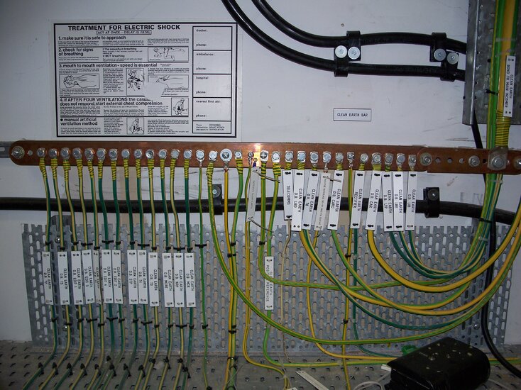

I used to work in a television studio - we had a 'technical earth' or 'clean earth' that all the audio and video gear was connected to. I'm pretty sure radio stations employ a similar set up. I think it was to do with providing a single path to earth to avoid earth loops and also separate the earth path from other equipment that might introduce noise into the earthing system. I don't know the specifics of this but a quick Google search might give some information.
Possibly overkill for your set up but here is a photo of the clean earth terminal bar. I'm sure it is referred to as Star Point Earthing.

As per Davesparks you need to be clear on what you are trying to achieve. Good results can be got from plugging your gear into any normal, correctly installed electrical supply. If you want the lowest possible noise level then you may have to take special precautions, e.g. with a separate technical earth. Extreme measures include balanced CT-E supply and twisted-pair cables, both of which require non-standard installation technique.
None of this will have any effect unless the audio installation is top-notch, especially if you have any vintage valve gear which often requires particular methods of interconnection specific to each unit. One incorrect ground connection to an external mic PSU, or digital noise injection point via a non-isolated DAW interface, or similar error can undo all the hard work elsewhere. The same goes for the acoustic treatment of the space.
FWIW most sources of noise I have been asked to trace have been due to badly designed or executed audio installation, not power.
