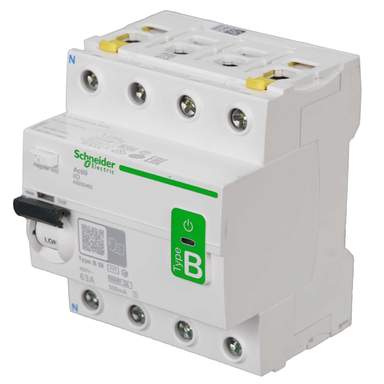

Another aproach would be a type B with a delay. This would give time for any downstream type A RCBO's to act before shutting the main supply. Is there such a device?
Yes, Doepek (and a few others like Schneider) make them. But at a price!

images

Type B detecting DC is much harder than a simple differential transformer.
Typically the DC side sensing is separate from the type A AC side, and uses either a hall effect sensor or an active flux-gate style of magnetic device that can detect "constant" DC flux from any imbalance.
