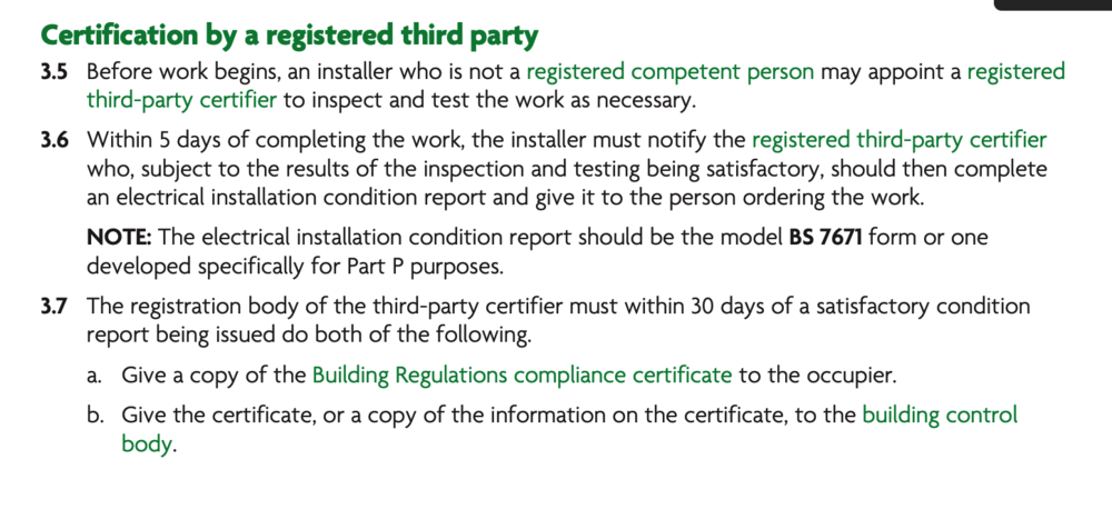

As regards certification, I think it varies from council to council. I‘m carrying out some notifiable electrical works on my own property. I’m no longer in a Scheme, but have the necessary qualifications. I asked my LBC, and they said an EICR carried out by a Scheme registered company would suffice.
