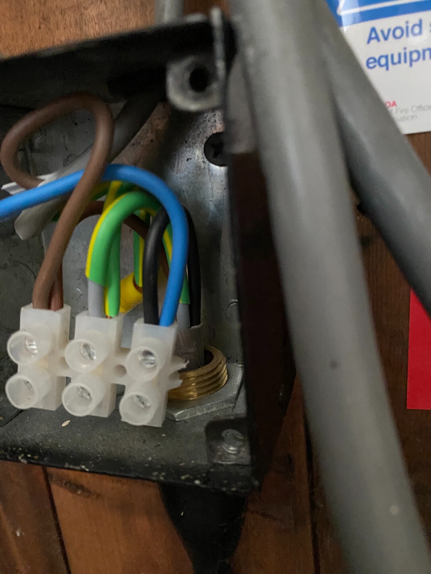

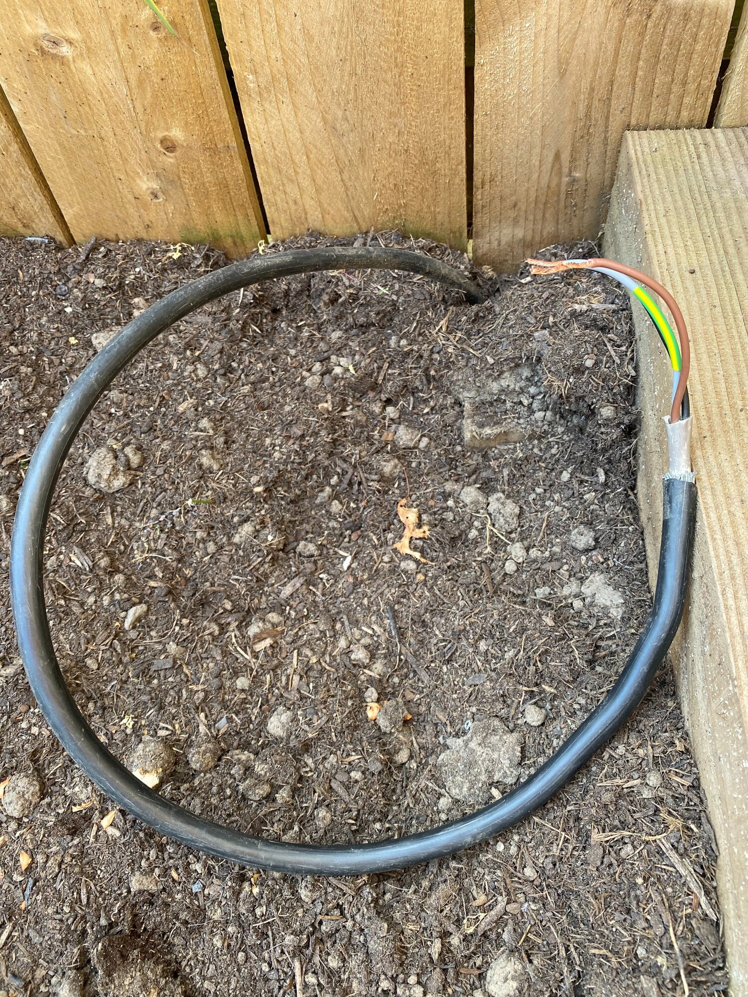

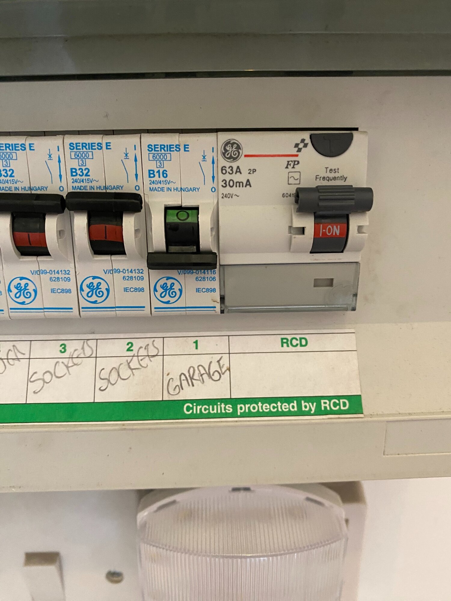

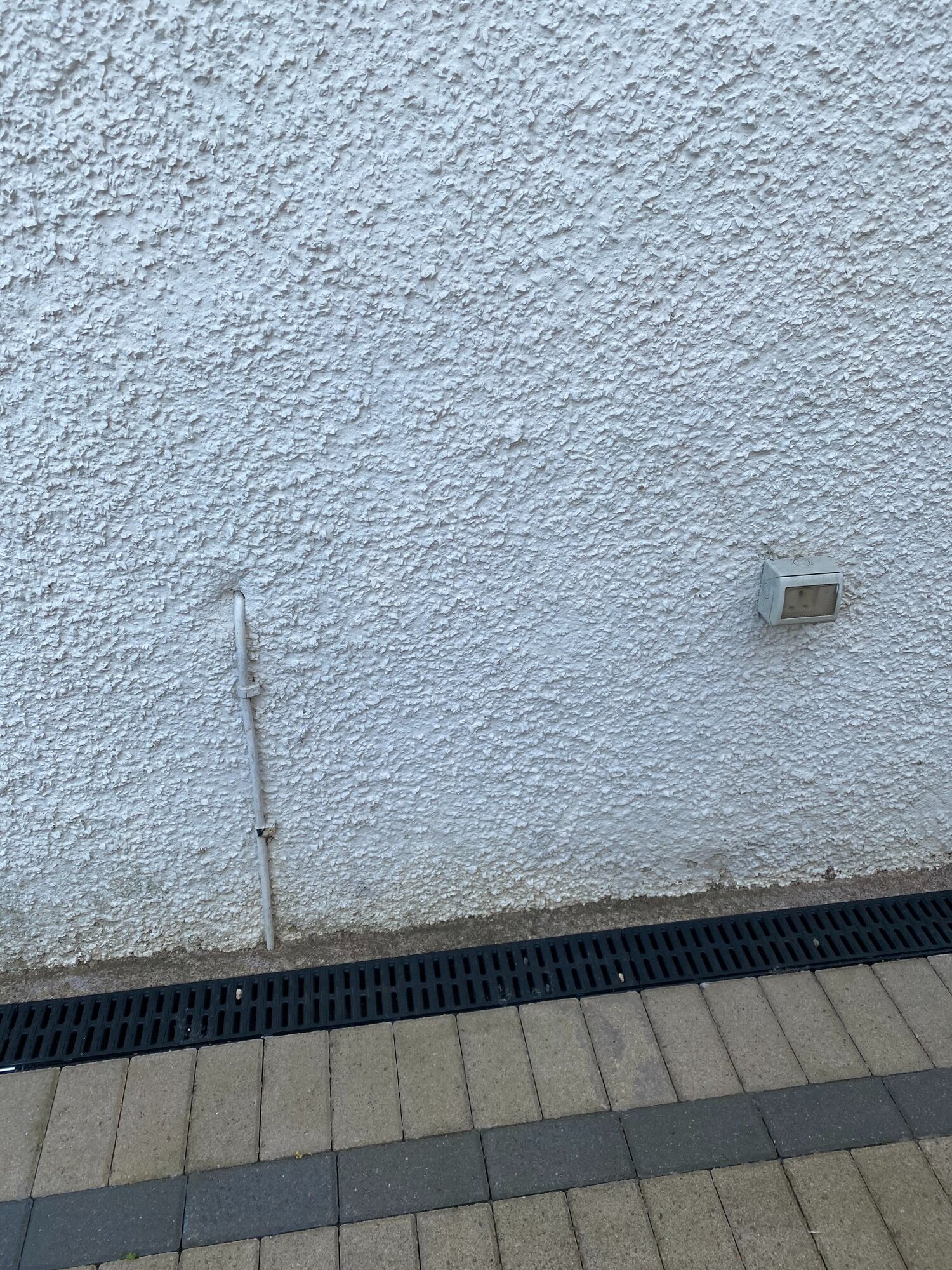

Yeah, pics below should explain the set up.
IMAGE 001 - Garage labeled as MCB 1.
IMAGE 002 -Wider shot of CU
IMAGE 003 -In cupboard below CU, this looks like the SWA box with warning label.
IMAGE 004 -This is what is on the other side of the wall, cable coming out is likely SWA (helpfully painted white by previous owners) which is buried.
IMAGE 005 -Finally the SWA within the back garden itself.
You need to stop switching on the mcb to see if it is live, with the cable ends floating about it is dangerous. An electrician can easily check the mcb and carry out continuity and insulation resistance tests.
Yep, haven’t touched anything since I realised it was dead/a fault. So kept everything off and tidied away. The cable ends are wrapped up/capped and stored away from elements.
