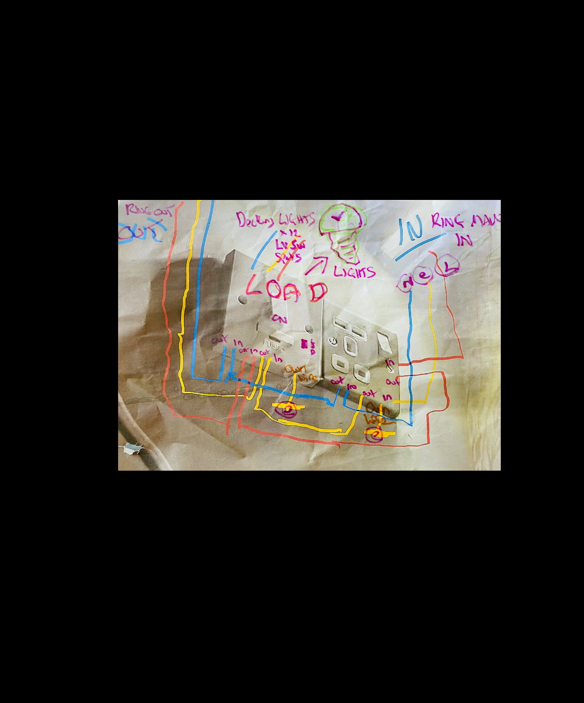

I have added a wiring diagram of the fused socket next to a single gang usb socket and how it’s wired, any mistakes anyone can spot there? Single gang works fine as do the usb ports
The fused sockets Led turns on when switched and tested power but nothing to the lights outside?
Does anyone have any ideas? Thank you

Sorry, but the diagram is just a mess.
You have the ring (rfc) going into the 1 gang socket, and both legs into the supply side of the switches fuse?
A ring doesn’t go “in” and “out”…. Both ends go “in”
The load goes “out”
Deck lights are bad for water ingress, and it sounds as if there’s now a broken wire somewhere, which could be dangerous.
Check the connections at each of the joint boxes, with the power off. If no lights are working, it’s possibly the first light on the circuit that there’s a problem

Now I’m going to take that telling off, as I’m not gonna get a A grade in electrical technology with that! NOTED

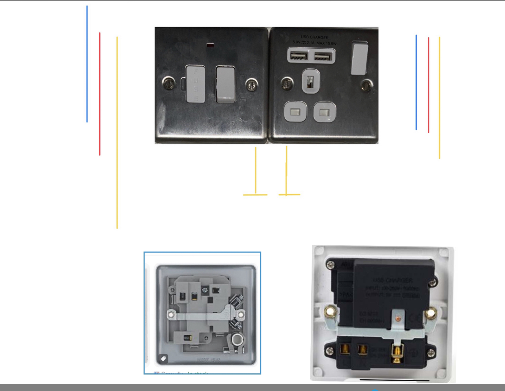

SO HVE ATTACHED THE BACK AMD FRONT OF THE UNITS
How would you wire it ? Treat it as two spurs?
Fuse obviously has the lights going out of it, I didn’t wire this I hasten to add, so was replicating what was there and they were linking up the sockets for some reason?..
Will send as well what I think your saying.. if you could just add the lines for me or say if that’s right that would be fab. Thanks so much for your time amd help
I cant make out the details on the connections on the switch fuse.... but most of them are marked Lin, Lout, Nin and Nout.... or they are marked as L-Supply, L-load, N-Supply, N-load... or something like that.
Both reds go into L of the socket, Both blacks go into N
Reds of the ring on the switch fuse go to Lin, or L-supply... Blacks both into the corresponding N.
Your outgoing lights are from Lout, or L-load and Nout/Nload
I haven't mentioned the earths, as there isnt really an IN and OUT terminal... but just make sure they are all connected.
3A fuse in the switch fuse.

Ok this is what I think is right, tell me if not 🫤
No because that breaks the ring final circuit and creates a dangerous situation and potential fire risk.
You should get an electrician to fix this for you, if you don't understand the basic principals of electrical circuits then we can't teach you how to do it over a forum.
Remeber electricity can be lethal, a simple mistake could be incredibly painful or cost you your life.

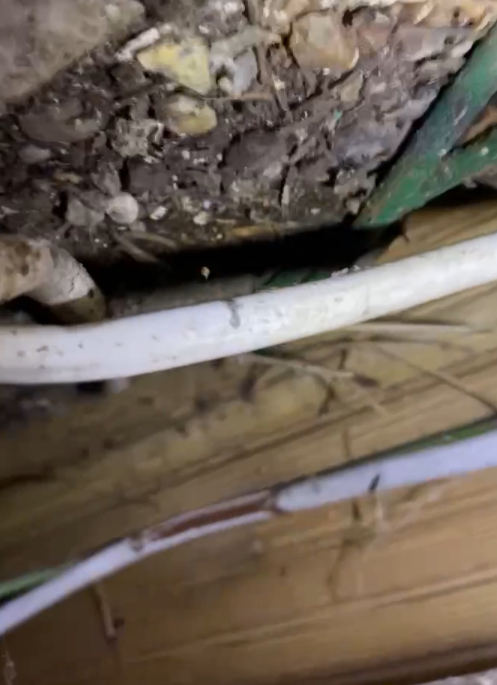

Was a little more than just the socket, had 3 junction box’s filled with water and somehow little critters gad even chewed through the bloody armoured cabling in 2 places. See my pics but all back functioning as they should.
Really appreciate thus forum and everyone’s help!
