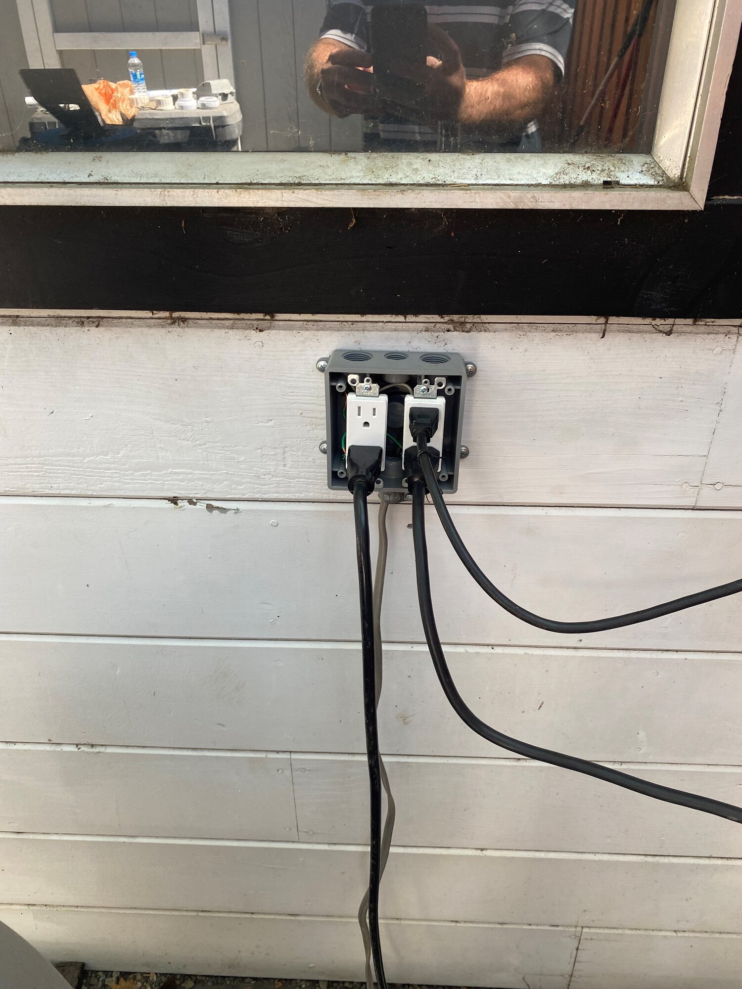

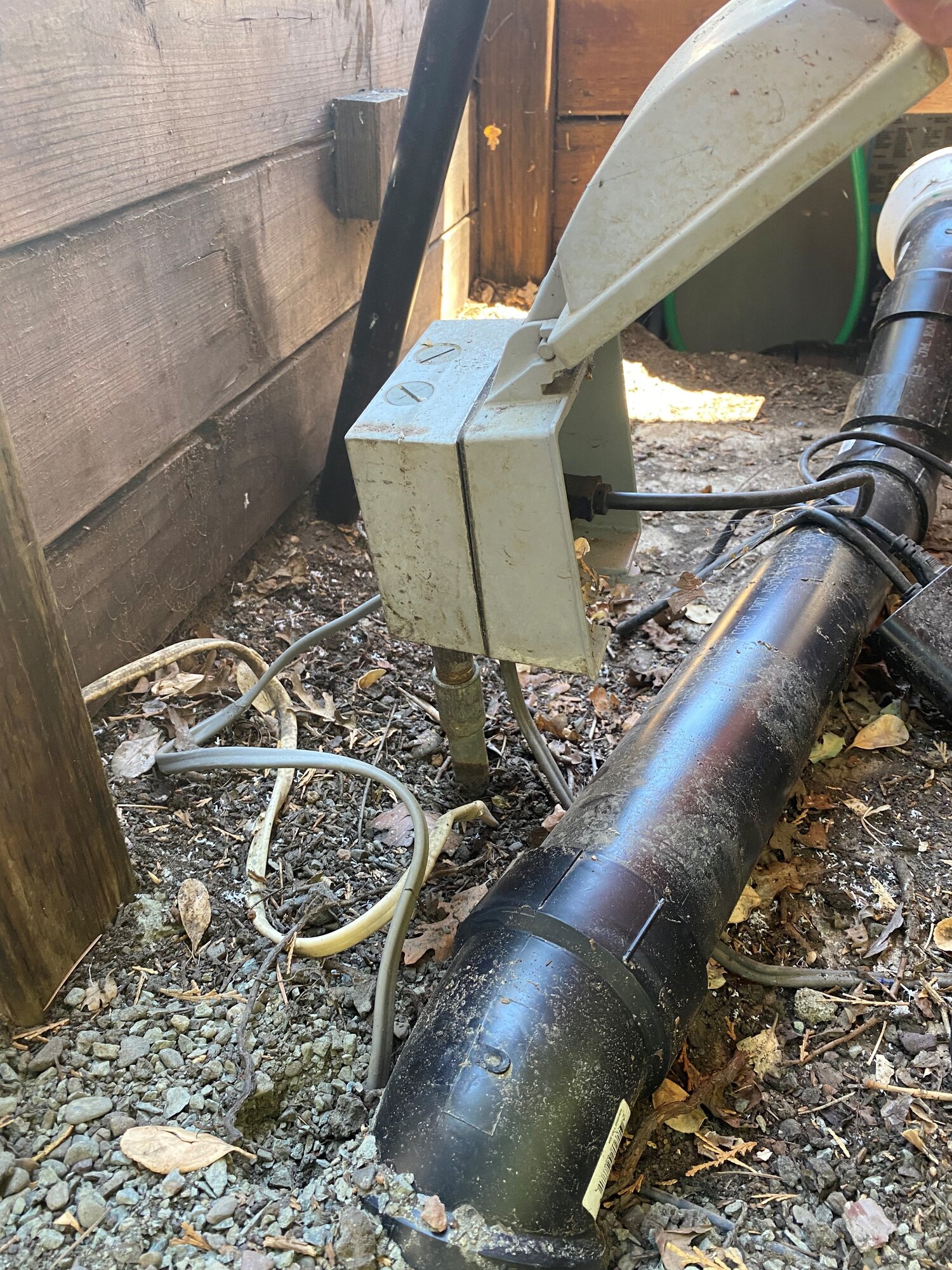

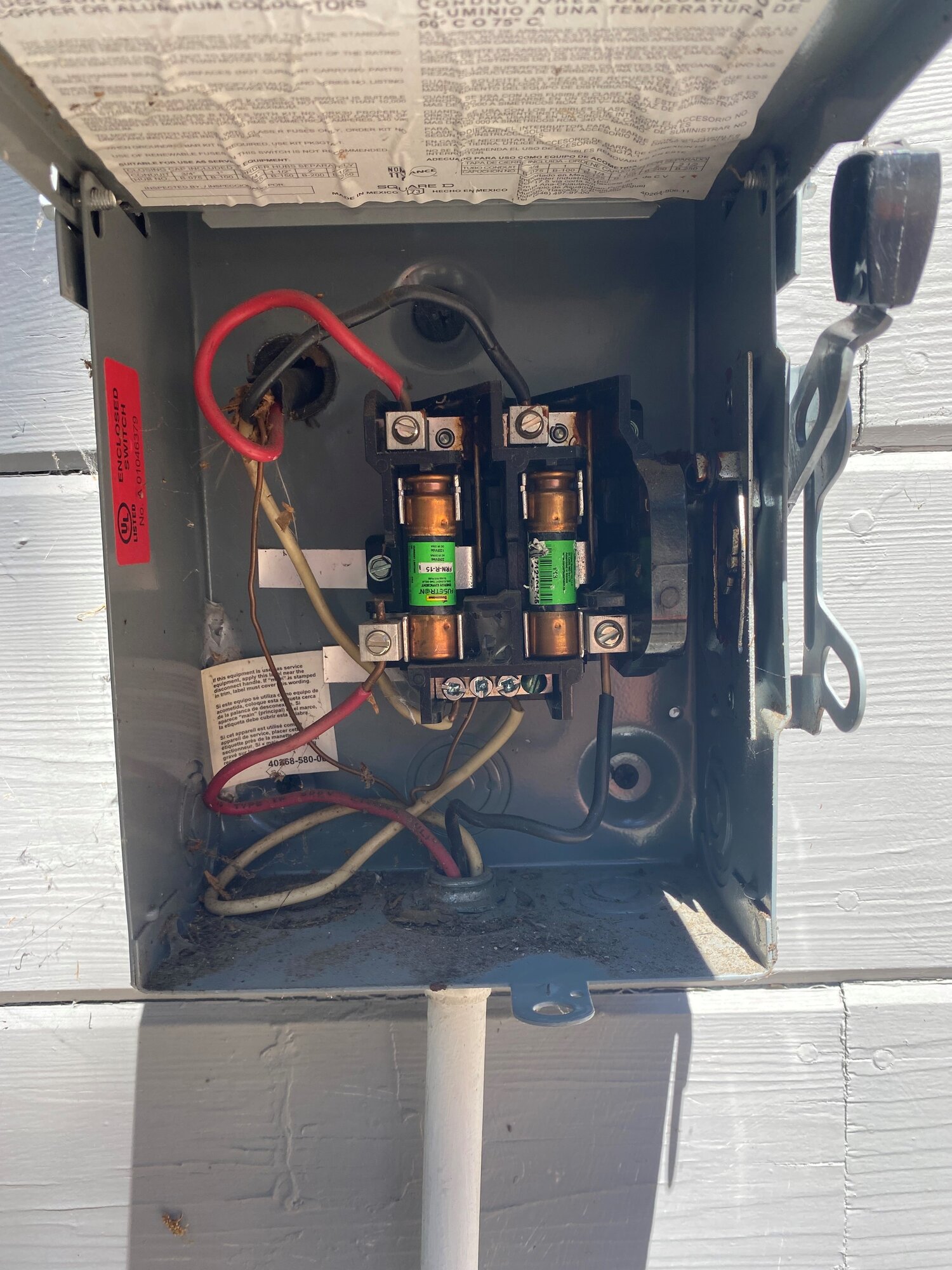

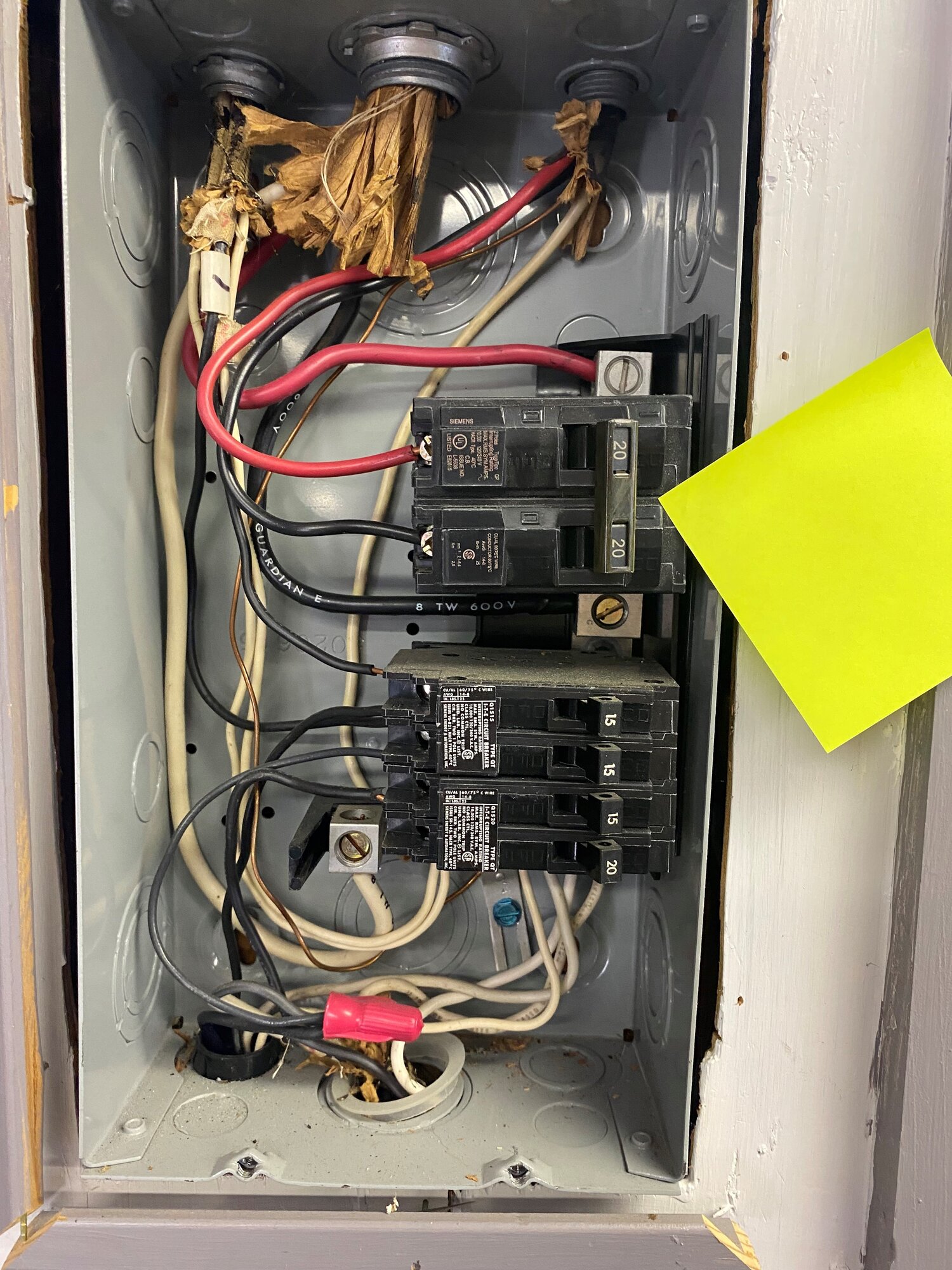

The pictures below is the current set up.
The sub panel in the shop has the 2 pole 20 amp breaker as shown with the post it note, and there is no more room for additional breakers.
The 220 leaves the sub panel and goes to the fused disconnect in picture 2. From there, each leg of the 220v goes to an outlet where each leg serves one duplex. Power is then ran again from one of the duplexes to another 4 gang box where it feeds 2 more duplex receptacles. The main pump can draw up to 14 amps and is plugged in on the left.
I'm thinking I need to go from shop sub panel to another breaker box. In that breaker box, I could utilize a 2 pole 20A breaker and go directly to a 220v outlet and be able to plug the pump directly into that (will need to change wiring of the pump; etc) and then utilize additional 15 amp breakers for the various outlets. Intent is to be able to shut the pond down completely with the fused disconnect.
I was questioning whether or not I needed the breaker in the shop sub panel or if I should remove the breaker and tie the wires directly to the bus terminals.
It's a bit of a mess and was looking for some insight as to how to clean this up.

My friend I see a lot of code violations in the pictures you just sent. Can you not just take the disconnect down and replace it with a panel. You could pull # 8 copper 4 wire from what ever is feeding it. The receptacles on the wall is required to have GFCI weather resistant receptacles and the holes on top need to be closed and a required bubble cover. The stand alone receptacle is also required to be GFCI protected, it looks like it needs to be reinstalled back enough so the the cover can close, all the exposed wiring needs to be buried of sleeved with conduit. Let us know if you need any more information
It probably wouldn’t be a bad idea to just change out your existing panel that with one has more circuits
